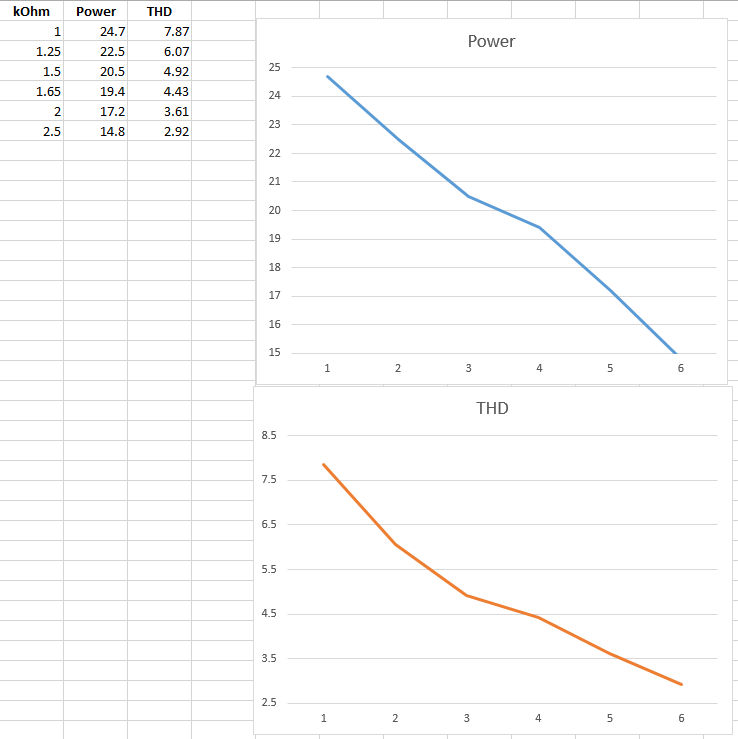

Andy, as you can see in the attached picture, the 1k5...1k65 load is the "best", where the loading alteration (the loudspeaker is not constant load depending of frequency, so its transformed value to the primary also changing) causing as small as possible THD variation.
So the single 300B the 3k..3k3 range behaves similarly, so it's the - all-round - "best compromise".
I also regularly use 5k transformers in my 300B amps for the lowest distortion (but with A2 capable driving, so 10W is available).

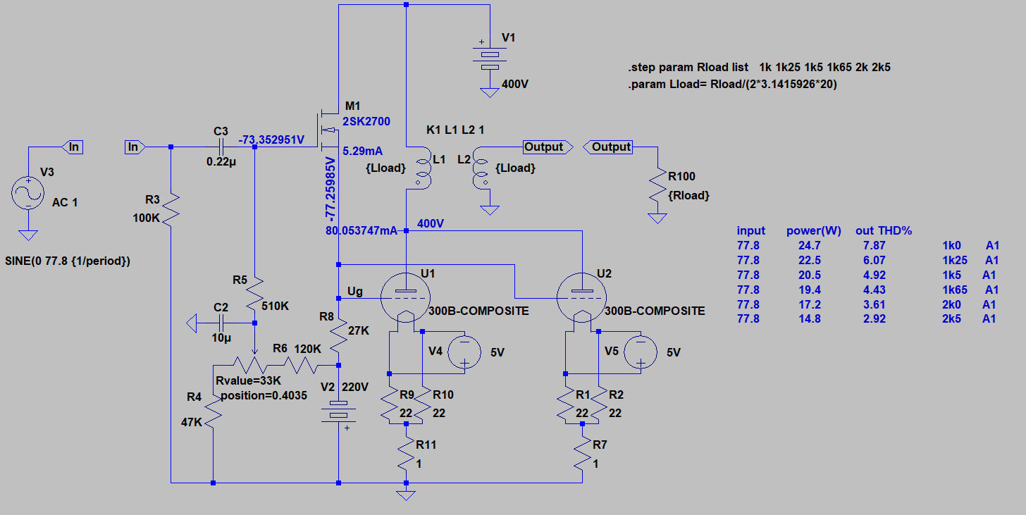

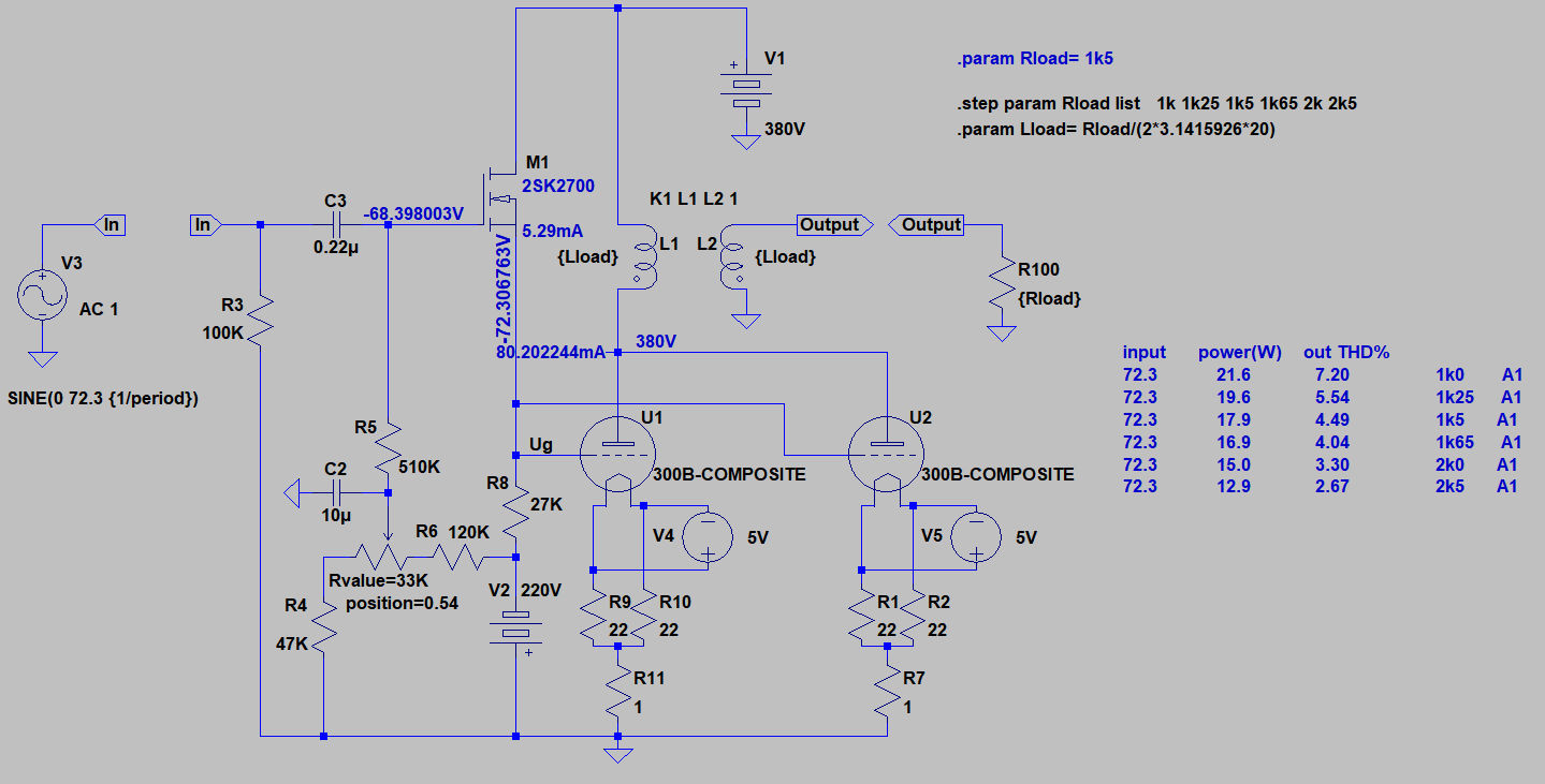

At the request of Alashikata, this is the another (380V, 80mA) simulation.
IMHO the most neuralgic point of this layout not the operating point, but the OPT.
The 150..200mA static current and about 25W estimated power requires big core and heavy copper wires, so it's a costly game, if you want satisfying LF and especially HF behaviour.
These are the LTSpice simulation sources.
