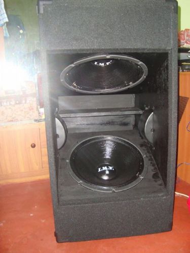

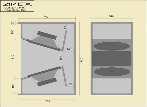

Little parenthesis about 2 way systems : I want to cover 40Hz - 800Hz with one capable driver. Would it be possible with a (folded?) horn based enclosure as the one below or should I stick with a vented one ?
Thx !
Such horns are good to about 200-300Hz max.
For 800Hz, I would definitely go vented.

In general, such horns are good to about 300-400Hz max.

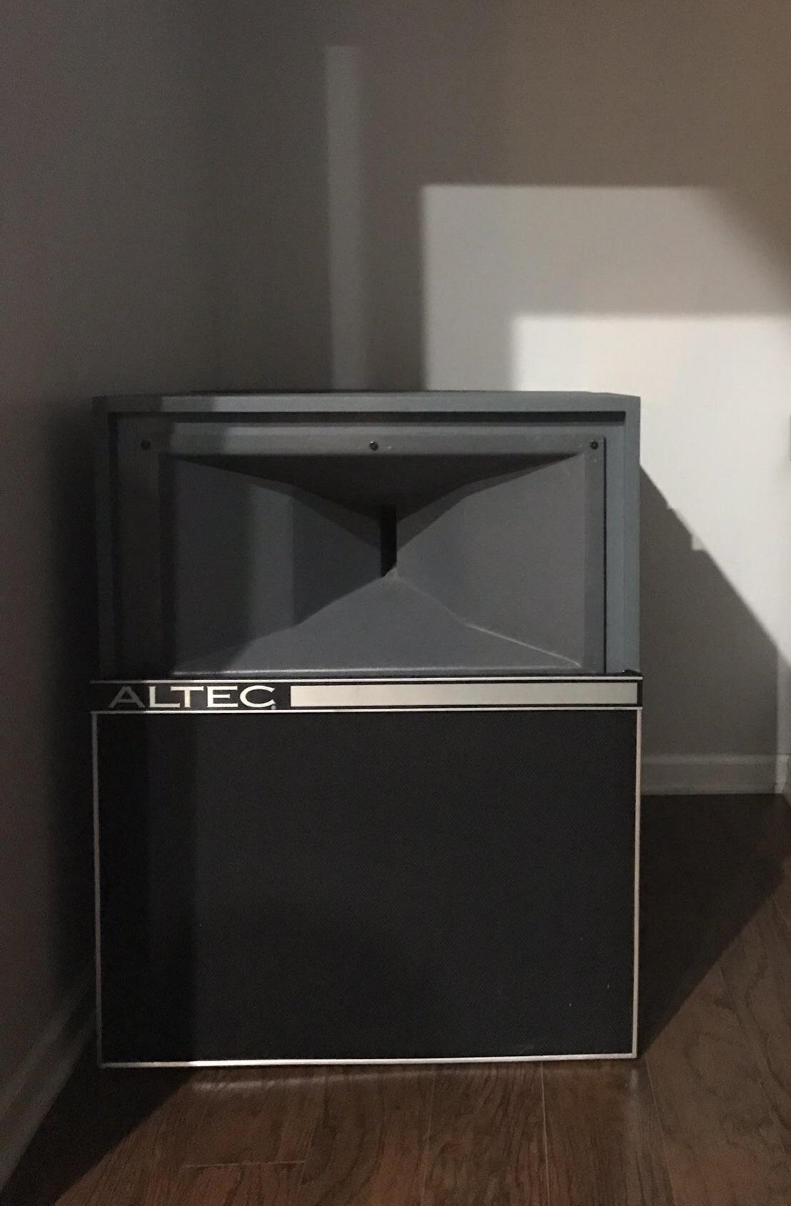

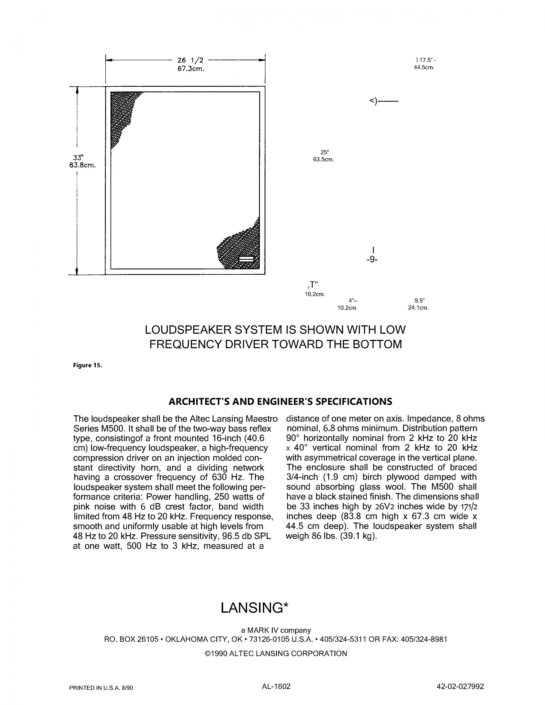

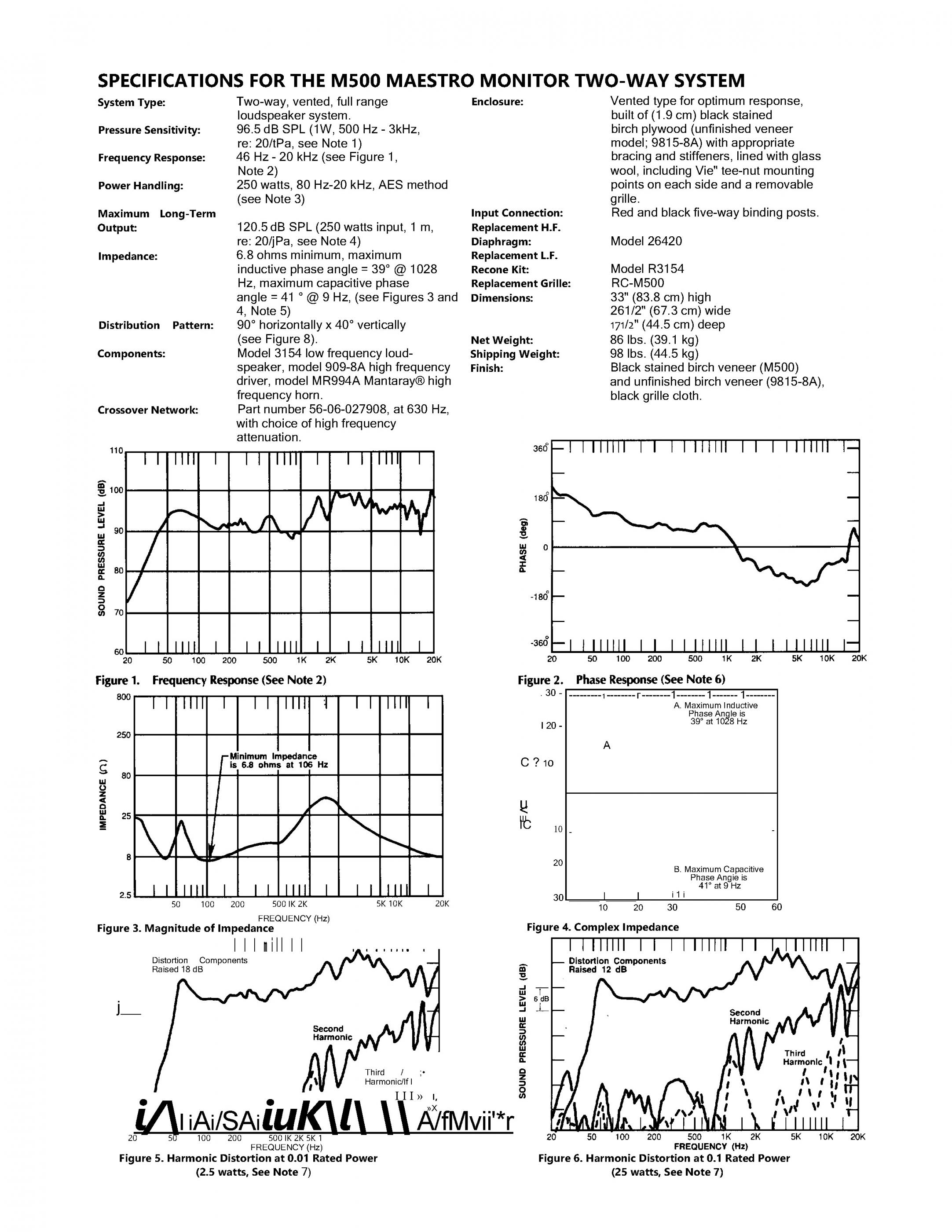

I've been contemplating my proposal, but all things considered such an A15-8A/M500 clone would probably result in something very similar to Tony Gee's Calpamos.
I like the concept of the A15-8A/M500 and it fits the topic perfectly.

Yeah, except for changing, rearranging dimensions [don't like narrow/deep], looks good...... these folks chose to start with a pair of M500: The Altec-Lansing Model 19-MR3: The Loudspeaker That Never Was - Audiophile Nirvana

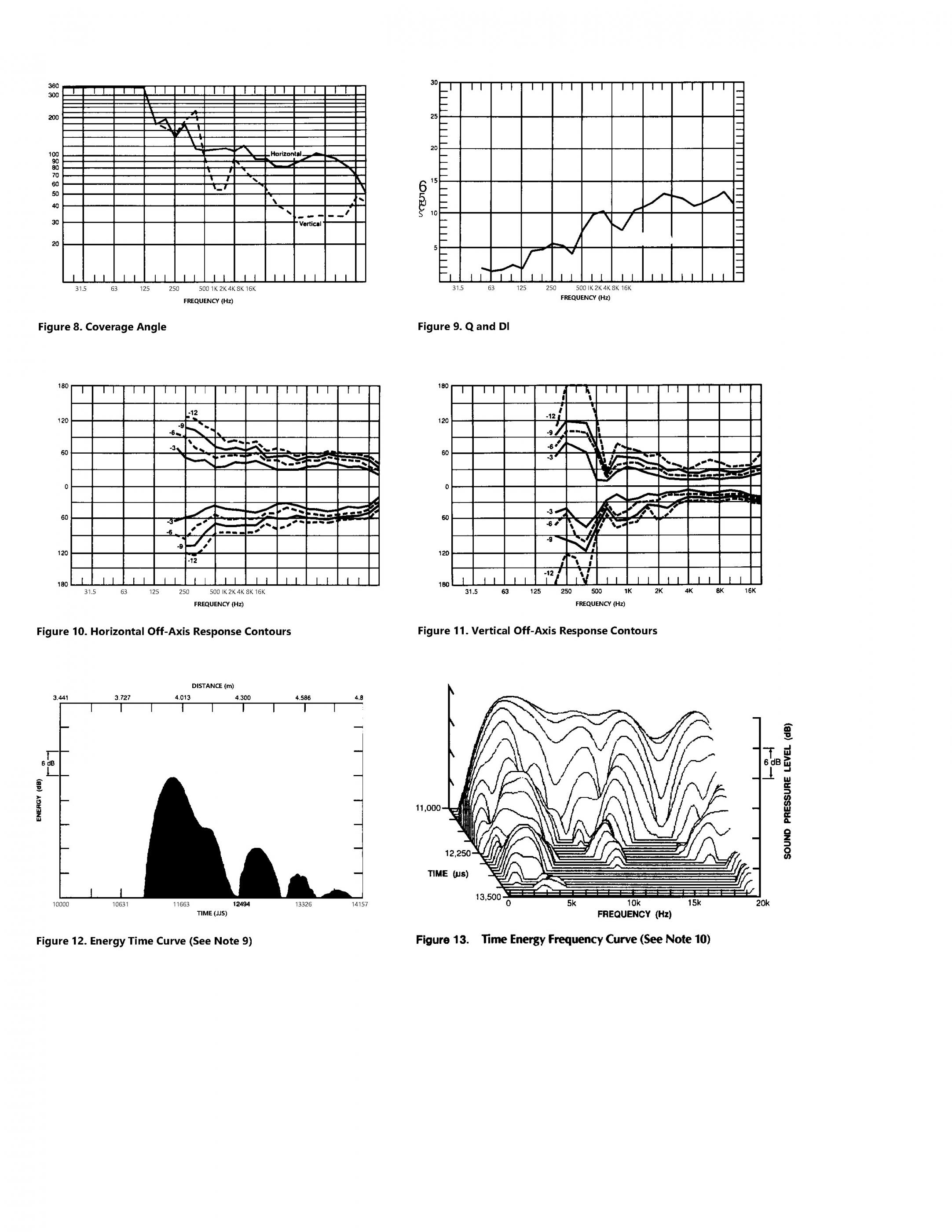

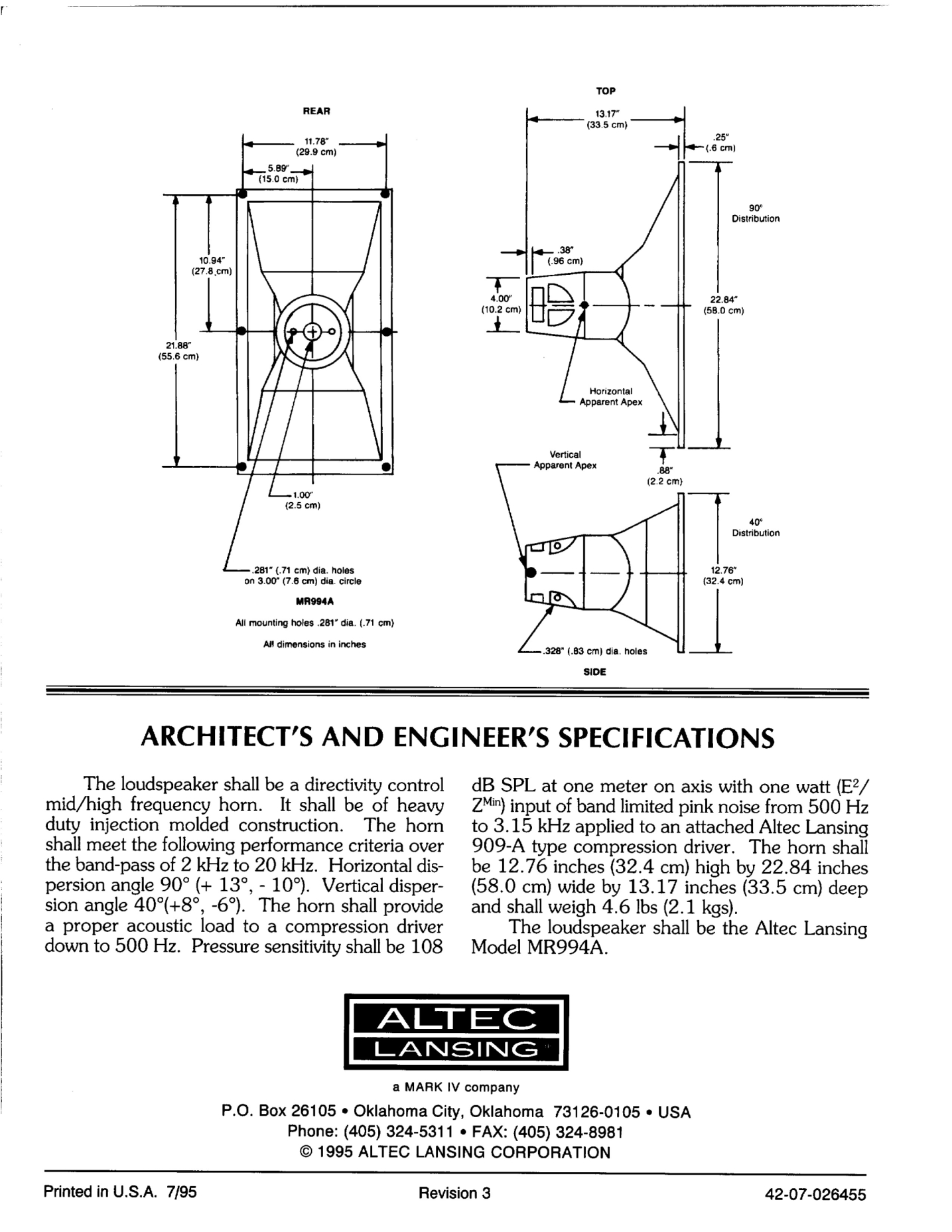

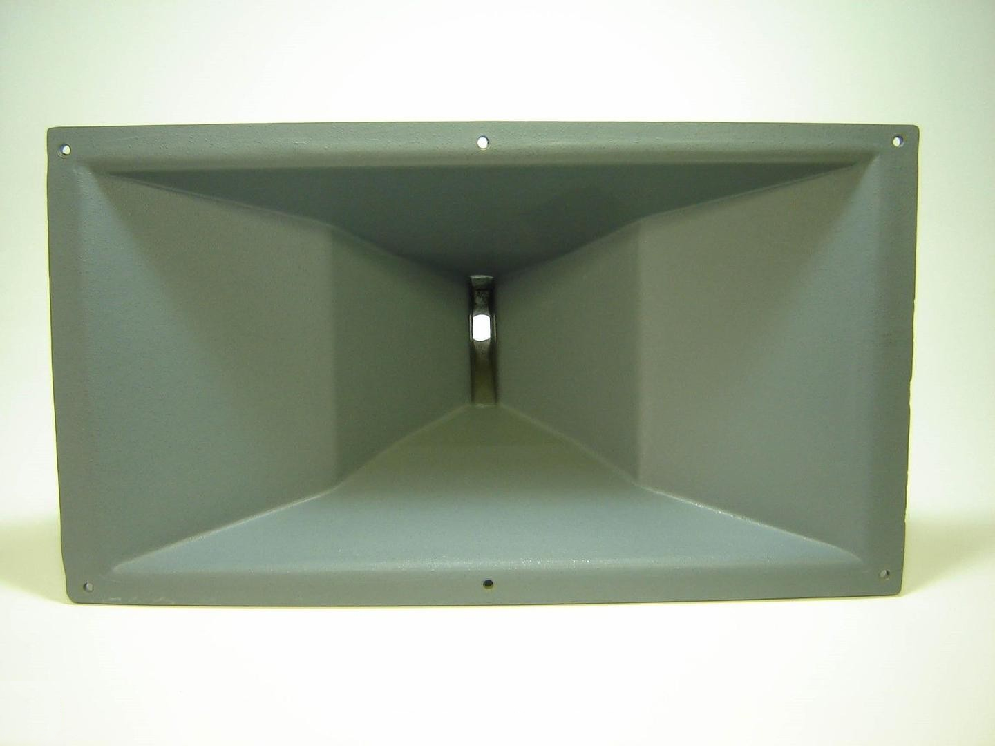

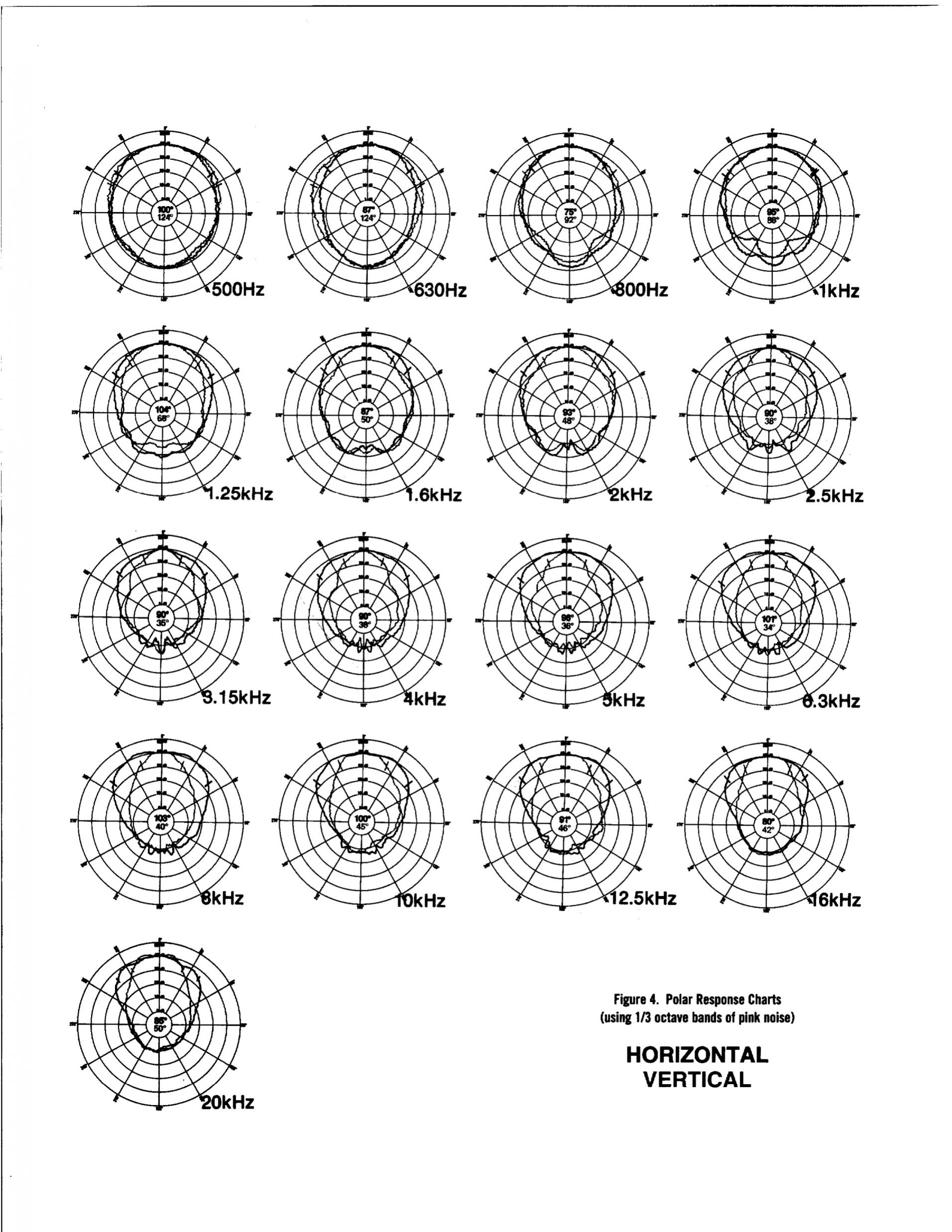

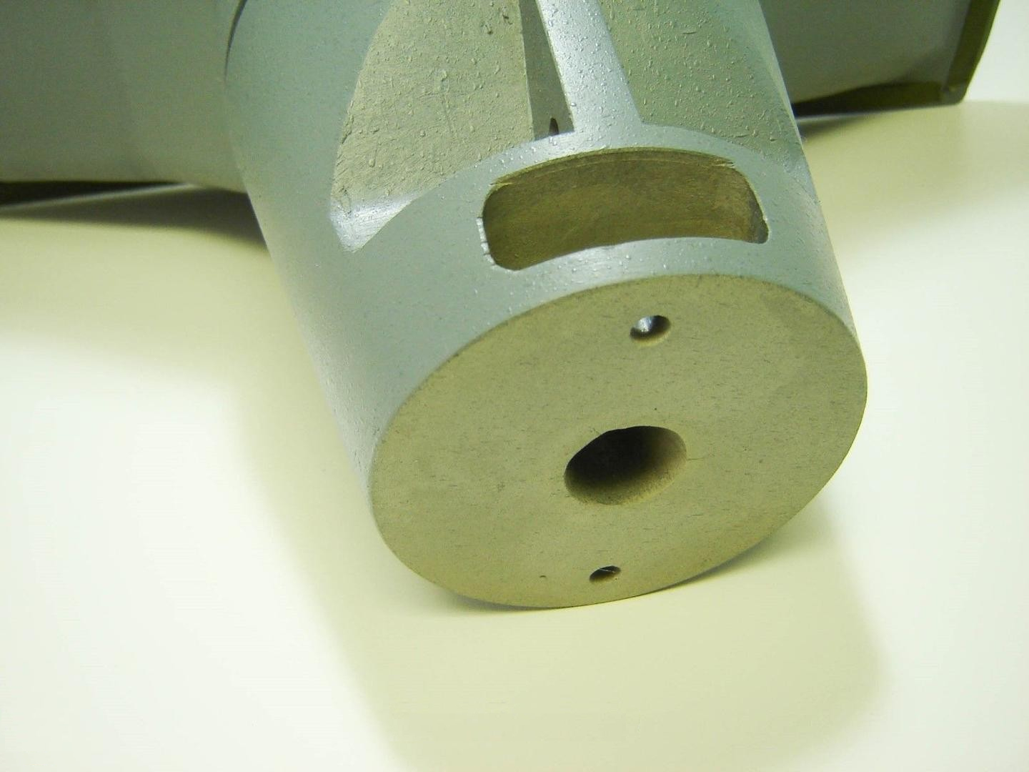

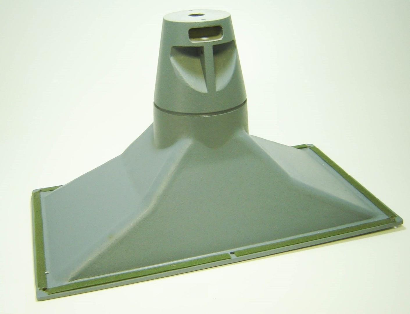

This appears to be an example factory XO mismatch between the Mantaray 994A horn and the 909-8A comp. driver that has contributed to the bad reputation of diffraction horns.

That Eminence on top... butt ugly and unnecessary in my opion.
Definitely wouldn't be my choice, though for HIFI apps feel all these type horns need a super tweeter for those folks [mostly women] that hear real good up high, though if spinning old vinyl, tapes it can be a crap shoot since some prefer rather dull top ends. Over time I came to learn that Magnepans were the most liked among females of all ages, though none could really explain why: Magnepan measurement - Google Search
