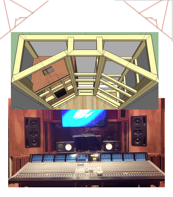

Soffit mount the speakers for what you determine is their optimal performance within your room dimensions.
I would want to minimize the center to center distance between the mid and high driver, so would choose to use your 15" cabinets for mids (rather than 18") and your dual slot loaded 18" for low frequency.
Your choice of a very deep high frequency horn choice will require a large soffit.
The soffits could be made free standing to allow for some degree of toe-in variation, and removable panels could allow for some mid/high height variation.
