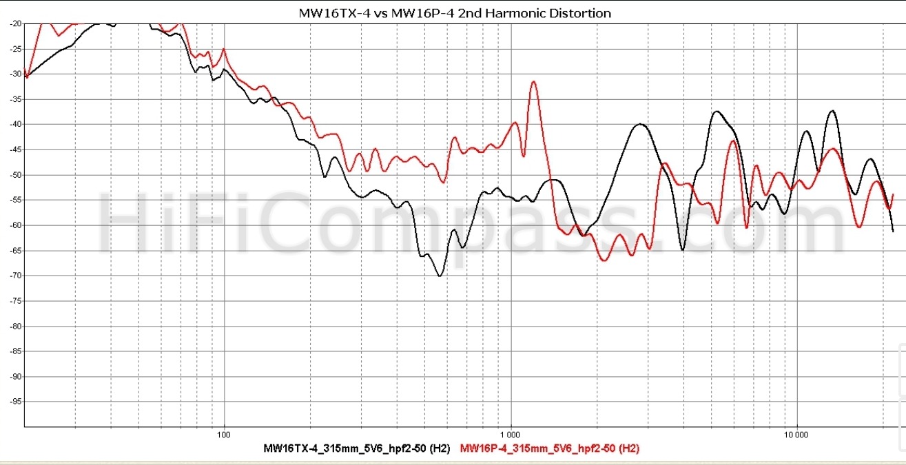

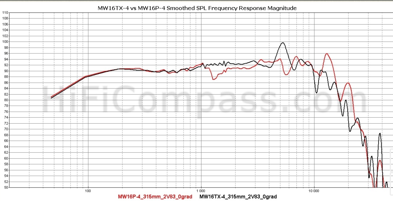

It is a trivial truth: linear distortions aeffects the frequency response of a loudspeaker. However, If your hipotesis were right, we should obtain correlation between on-axis SPL changes due to linear effects and an increase of THD level in the corresponding frequency range. Such situation can be obtained in compression drivers, when the harmonics frequency coincides with the break-up mode so we can obtain THD peaks in THD frequency response. But this is not the same situation with LF drivers. For example, in picture from paper by Yamamoto & Tsukagoshi I cite above both LF drivers has quite comparable on-axis frequency response with a couple of dB variation. Whereas variation in THD level in the midrange is almost 10dB, which is hard to explain just by difference in frequency response due to linear break-up effect.
Similar situation can be obtained in modern LF loudspeakers with the identical magnet system and the cone/suspention, but with different cones.

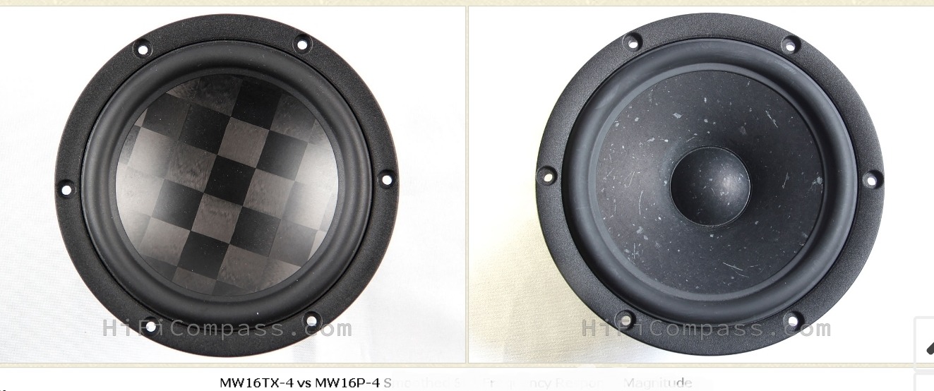

https://hificompass.com/en/reviews/satori-mw16tx-4
For example I post the picture from HiFiCompass page for Satori MW16TX(textreme) vs. Satori MW16P(paper). As we can see, the paper cone has break-up problem above ~1kHz (apparently it is a typical structural mode appearing in the paper cone loudspeakers due to mismatch of mechanical impedances of the loudspeaker cone and suspention). On-axis SPL variation of the the both speaker lies in the range 2-4 dB, whereas variation in the second harmonic is in the range of 5-20dB (softer paper cone has higher distortions) in the midrange below 1.5kHz, and the THD level is drastically reduced in the paper cone above ~1.5 kHz. Like in the Yamamoto and Tsukagoshi case, it is hard to explain 5-20 dB larger THD level in the loudspeaker with softer paper cone just by linear break-up effect.
Hence, I stick by my claim that breakup modes are mostly linear and do not generate significant levels of THD.
But so far, your hypothesis about linearity of the break-up does not quite fit into the experimental data for LF drivers.

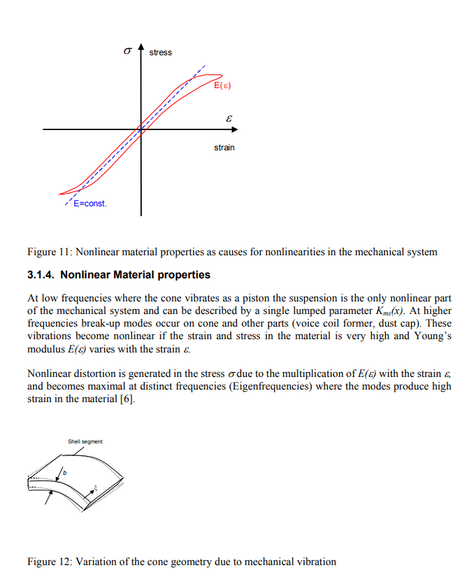

To add on to this, Klippel specify that at higher frequencies where the cone is not pistonic, there exist mechanical nonlinearities that lead to distortion. See the image below (taken from Loudspeaker Nonlinearities - Causes, Parameters, Symptoms):
There are also further examples in the paper about measured drivers, where the distortion in current and sound pressure are compared, showing harmonic distortion due to nonlinear cone vibration at higher frequencies (see page 51 and page 58) as well as more details about the kinds of distortion you can expect from nonlinear cone vibration (page 38, 41, and 44). The paper is freely available on Klippel's site: https://www.klippel.de/fileadmin/_m...linearities–Causes_Parameters_Symptoms_01.pdf

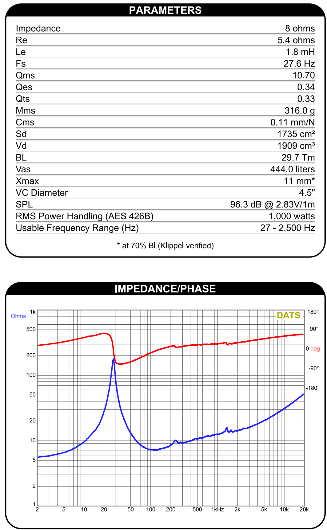

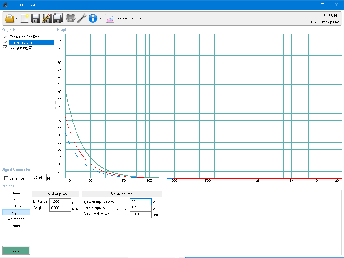

Yes I remember, but theres gotta be something, Crossing at 200hz?.... Excursion looks nice with a set of 4. The pic below is using ther force flat FR feature and SPl/1m matched at 117db. The lowest excursion is a 8 - AE18"s, highest is 4 - AE18"s and slightly above the lowest excursion example are simply 4 Dayton 21ers.... I'd have them facing forward, 2 front 2 rear.... Yes I have the 15" that can still be the bandain between the lowest driver... but... Mating this 316g mms to a light weight diaphragm on horn.... Why does it sound like it could have issues... Or would it have been issues except that 200hz is too low for those issue to come to perception. Might it be an issue of timbre, in regards to thd.... yet, with excursion so low.... I remember @gedlee reminding me that is all in the measurements of the actual woofer, but what does theory suggest in regards to mms vs frequency? @b_force I'll have to go back and read your thread focusing on the performance of a driver based around Low excursion and F, but I remember that as always, excursion is the heart of most issues. I envision that the negatives of mass are seen at large excursions. I picture decay lengths increasing with mass due to storage, but at 200hz and below? Is it just not an issue? The Dr. Geddes in me says that CSD of woofers are never an issue except in poor performing drivers... I wonder if there is already a thought that, one not want to use a sub for a reference monitor if the mass to motor force ratio isn't low enough? Otherwise, this Dayton appears to be a good candidate for 200hz and lower. Possibly a better candidate, but I am not confident.
AE18h+
