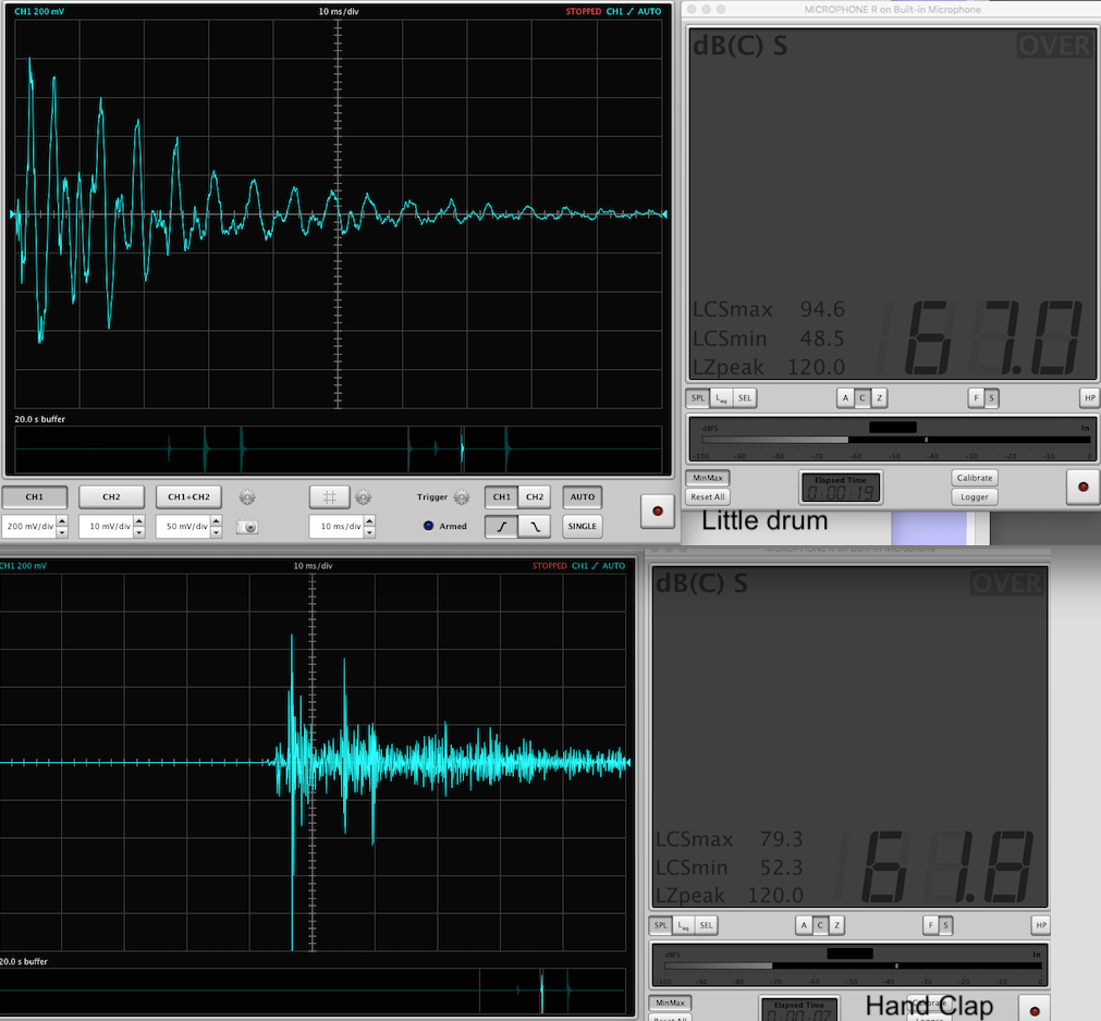

The REW "Scope" (oscilloscope) has up to a 20 second buffer, so you can go back and visually observe the frequencies of the waveforms and their amplitudes after starting the SPL meter/logger and the scope.Another inhibiting factor in this part of my journey is the lack of ability to see true peak vs spectrum....With the RTA, I clap, I see 120 on the spl meter reading of Zpeak....Yet I have no visual reference of where this 120db is on the RTA..... Pointless information without the whole picture.
How do I fix this, as in, where is the RTA that reads True Peak.
Set at 1ms per division, a 1kHz waveform would take up one division.
Set at 10ms per division, a 100Hz waveform would take up one division.
Easy to see the difference between a "dead" little drum (dies out in just over 100ms), and the high frequency dominated hand clap, both peak at 120dB.
If you do the same with your real drum set, you'll start to get an idea of the difference between different SPL meter dynamics and peak frequency content.
Art

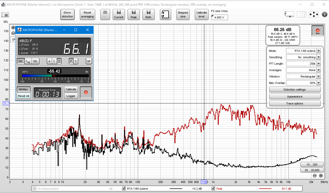

looking at the Oscilloscope doesn't tell me frequency, nor does looking at the recorded waveform.
An RTA that is fast enough to capture True Peak is what I am after.
I want to see Peak information, through the RTA....there is no other way to put that lol....
Here we can see that my clap has reached 125db on the Peak meter yet on the RTA only reaches 75db....
How can I fix that?

Try changing the mode settings, RTA 1/48 octave could well be hiding the peaks in the the 1/48 smoothing.How can I fix that?

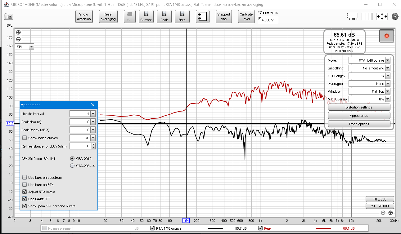

I fixed it!
You have to click "Adjust RTA levels"
So nooowwwwwaaaah, I can use my mic and play music and media content at whatever level I want to speculate and watch the RTA and see where the Peak information takes me in real time. The system can limit this activity if the volume exceeds its ability....
Whos going to be the first to develop software that compares and contrast source signal vs microphone signal to expose Compression and attenuation or any other distortion??? Maybe display the source signal superimposed over the Microphone signal?
Are there any recommended settings for anything else, you guys might suggest? Like for windowing???
Edit: Ok I didn't "fix it" all the way, but peak is showing much closer to the spl meter vs the rta after changing that option...it might be a matter of available windows at this point. Even more frustrating is that I don't get the same result every time I clap....Except for the Peak reading on the SPL meter...

This might help you understand your confusion between different results:
I think some may have a misunderstanding of FFT. You cannot see true peak levels with FFT because the FFT averages the values during the FFT interval. As Geddes said, the oscilloscpe is the way to see the true peak levels. That peak level contains the sum of all the frequencies in the measured bandwidth.
ZPeak reading is not an average...Im trying to Get my RTA to read True Peak, I am not using any averaging....the speed of the RTA even with Averaging turned off isn't as fast as the Spl Meter....thats about it.
Depending on the Windowing I use the I get more consistent readings on the RTA.....Rectangle seems to be the fastest, with the truest to actual SPL per test....
As I said, I want to see True Peak with Frequency ..... If FFT can't do it, it just can't do it....As Geddes said, the oscilloscpe is the way to see the true peak levels.
Peak is just a measurement of the highest signal that the device can capture regardless of where that highest signal may fall within the measured bandwidth...Thus not an average or sum
sounds like the lower I can get the FFT interval, the better. Likely why 8k gives me the best results.
