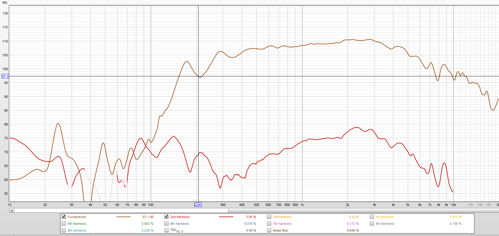

Looking at your graphs I would cross @ about 400Hz and set the crossover slope 6db down there.

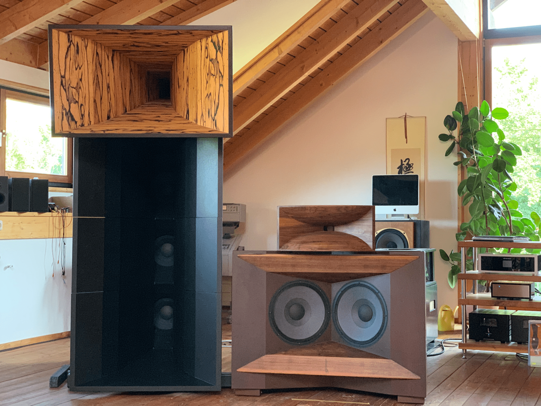

First off, congrats on landing what is looking like a very nice horn!I know we discussed in detail the idea of 20-30db of headroom...I've trying to everything within xmax at 115db... eventually came to the conclusion that 115db on the z scale is crazy loud... and that only bass would ever get that loud in a home system.....
I remember @mark100 and @weltersys commenting and a "fork drop" at 1m hitting 115db...
What Im trying figure out; is the above, enough headroom to cross over at 200hz....

Strongly agree with everyone saying to high-pass at no lower than 350-400Hz.
Just because a CD shows loading down to a certain frequency on a large horn, doesn't mean it's going to sound good doing so.
I keep finding i like what i hear, when i high pass a half-octave or better from the CD/horn's low corner.
Maybe it's because the low loading looks good at small signal, and falls apart driven harder...i dunno...kyleneuron gave a good way to check that.
Maybe IMD increases substantially the lower the high-pass....dunno that either....although that's my current belief (that hopefully can be proven/disproven with multi-tone testing.)
Anyway, for me, i'd be far more concerned with what xover freq/type/order mates the axi/horn with your lower driver(s)/box,
than trying to take the CD/horn as low it looks like it will go, and still give adequate headroom at desired SPL...

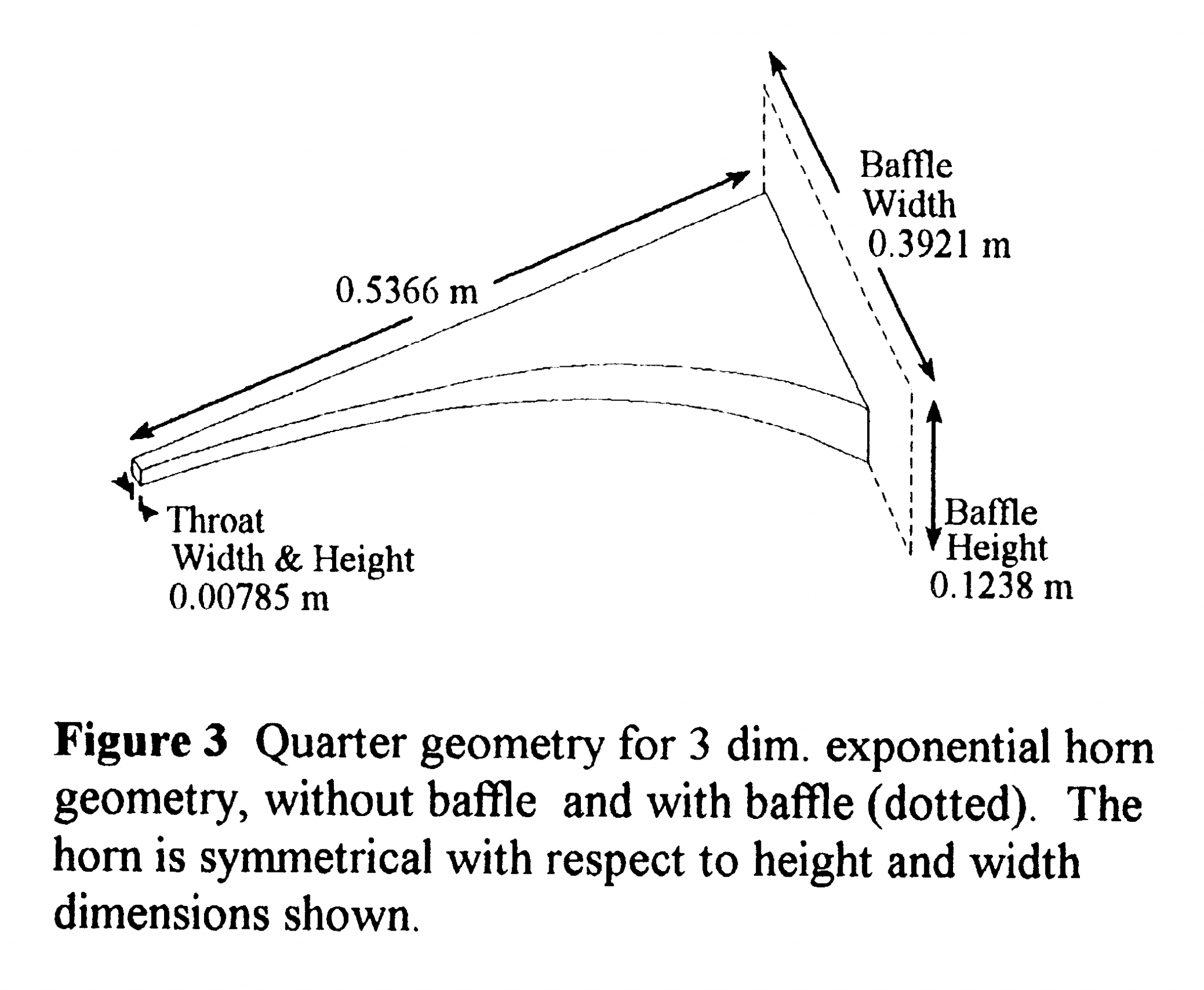

An important phenomenon in classical horn types (Expo, Hypex, Tractrix) is the group velocity effect near cut-off that could cause waveform distortion.
This 25-year-old paper, using BEM analysis of a Klipsch K400 horn, provides important insights.

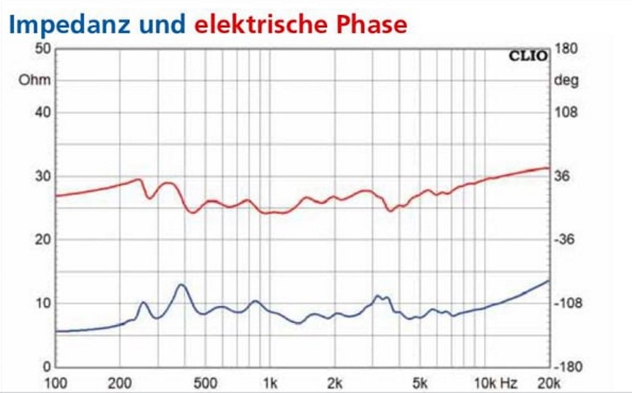

That's true, of course, but since Camplo's horn is what it is, there's not much he can do about it.
Regarding mouth termination (or the lack thereof), Bjørn Kolbrek's horn seems suitable for comparison.

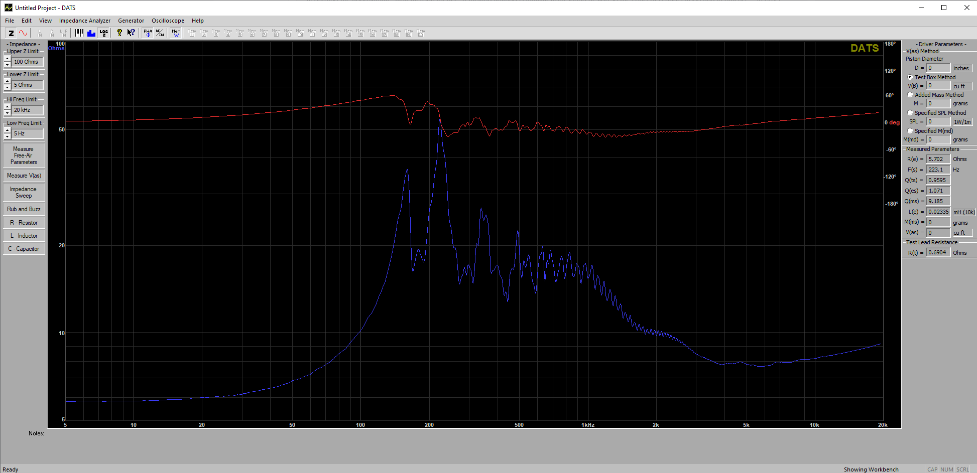

A good electrical impedance trace is the best tool to improve your model. When the measurement and simulated peaks in Ze match, then you have a good model. If they’re off, you need to tweak the model parameters accordingly or check your measurement setup.I'd like to think that the simulation is at least in the ballpark for displacement.... anything to make the sim better, I would like to do....
Again there appears to be a lot more noise in this data than I would expect. I have a DATS box too, and while it’s far from perfect my traces rarely show so much ‘fur’.Impedance on Horn
All of those closely spaced peaks suggest noise in the measurement setup. This could be from timing errors, noise from cables running alongside mains power, or a physical reflection such as having the horn mouth very close to a large & dense boundary surface when making the sweep.
I would pause and check everything before making any major conclusions.

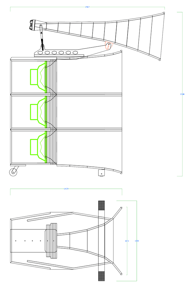

It could be an attempt to keep the group delay low at the acoustic crossover, and maximise efficiency by keeping the velocity maxima coupled at the 'big end' and 'small end'. It took me a while to find the post but to quot Tom Danley:So what's the reason to use such horn at all?
At the low cutoff, one has the radiation resistance of the “big end” coupled to the driver at “small end”.
Above the low cutoff, the active (impedance transforming) part of the horn retreats within the horn.
Mid band, this system has zero degree acoustic phase because the load is not relative, it is acoustic resistance, Voltage in see’s a resistance load.
This theoretically zero degree (in a perfect horn) phase is why they can preserve the input wave shape, not rearranging the signals harmonic distribution in time.
You probably guessed by now that this is a concern of mine.
It's worth noting that these comments are regarding a theoretical 'perfect horn' where the mouth radius is at least 1 wavelength for all frequencies above cutoff.A Horn is an inverting device, its efficient length is 1 / 2 wl because to be efficient, the driver and mouth both have to be at a Velocity maximum.
Most horns (all the bass horns I ever built) were only ¼ wl long and the mouths were much smaller than ideal and people still said “Hey Tom that thing is big.
A horn that is ¼ wl long still produces sound but at the low cutoff, it places the driver at the Velocity minimum and the ouput is delayed 90 degrees. A 1 /4 wl horn reaches its efficient range about an octave above the low cutoff when it is at least ½ wl long. When the horn is ½ wl long or more, it is an inverter and retains its –180 phase above, preserving waveshape (until the upper bandwidth limit is approached).
Since a horn is a phase inverting device, it might also be desirable to enable the use of passive crossover networks with even order electrical filter slopes.
It's difficult to read the dimensions in the diagrams Ro808 posted, but the drawing appears to show two different horns. Eyeballing the relative sizes, neither appear to have a mouth size in either the horizontal or vertical to support a cutoff below 500Hz. It would need a mouth radius of >0.7m to do that.
