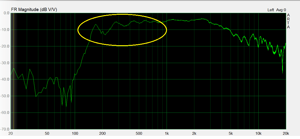

Simply stated a horn such as yours is probably imposes a 4th order crossover in itself at cutoff. With the intrinsic cutoff of the horn at 150Hz and the electrical cutoff 1 octave above that it's not going to be a true 2nd or 3rd order, or whatever, filter.
Leaving aside the issues of the Yosemite Halfdome filter, your acoustical filter will be a composite of the two, horn cutoff and electrical. I suppose at some point the added effect will be moot but you still have to make the woofer hand over nicely. I would look at it the other way, you have free slope from the natural cutoff, work with that and don't try to beat it.
Always details missing but at least I will soon have the horn in my hands to take my own measurements....

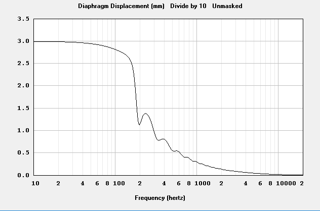

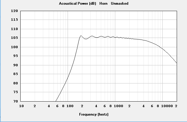

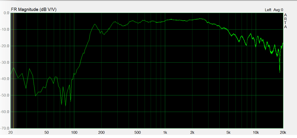

Its possible that these measurements below were taken at 1m. I think the HornResp sim is in the ballpark, which says to me, that there is a good amount of dynamic ability here...Even with higher voltage to get to 115db, a 2nd order LR at 150hz brings max excursion down to 0.4mm
I am trying to keep peak (transients) in mind.... I am not sure how the BL curves of compression drivers behave typically. You would think with such small excursions that BL is linear all the way till xmax/xlim. So if thats the case then having 115db or close to it...still within 0.8mm would be the goal I guess? A 2nd order placed at 30hz limits max excursion to just under 0.8mm, without moving Fr much at all.
In the end I'd still have to make choices that lead to healthy summing of woofer and horn of course.... I am entertaining the extremes and they seem feasible, so when giving attention to more "proper" approaches, like crossing at 300hz for example, the challenges shouldn't be much of any.

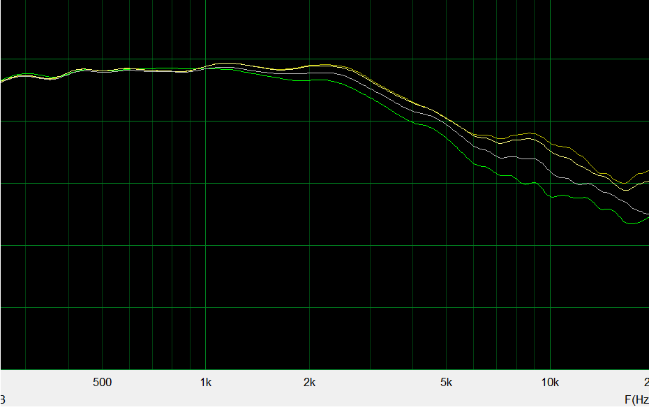

The polars are taken with10 degree graduations and the spl chart lines are 10db.
- Isn't this the "horn honk"? 🙂
Beware that such resonant behaviour will need to be dealt with in the crossover filter carefully. It's exactly the kind of thing a typical gated in-room measurement won't show you in a required detail - it gets more or less smeared by the time window and can be easily missed.

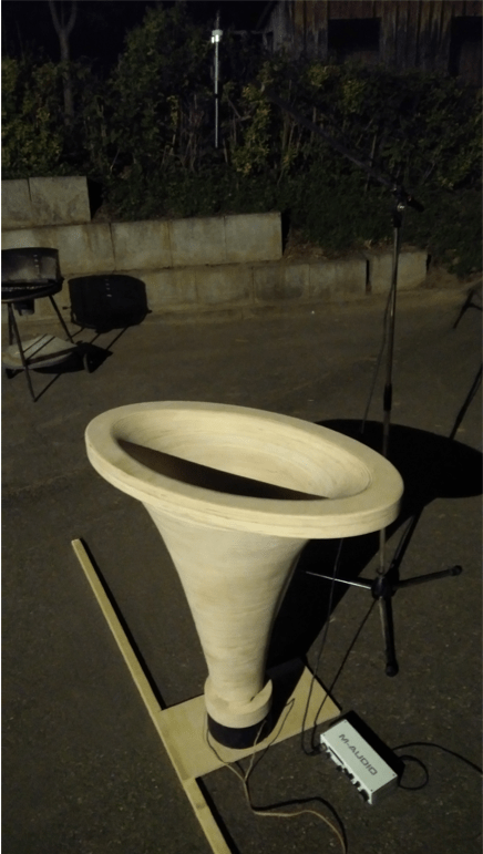

What are the settings for these measurements?
The BD looks extremely clean, not to say suspiciously clean.

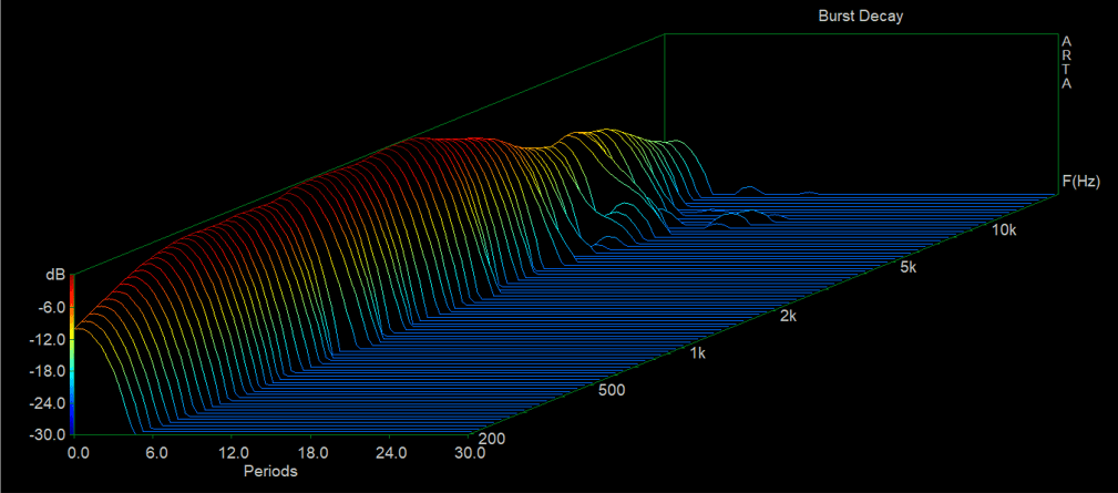

Not necessarily, these ripples indicate an undersized mouth.
Tractrix horns have their typical 'features', but horn honk isn't one of them.
I tend to agree with Marcel, but since "horn honk" has no agreed upon definition, argument is pointless.horn honk isn't one of them.
That's true, so let's focus on what can be inferred from the horn itself.

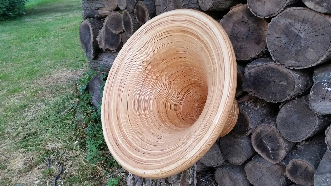

Camplo's elliptical Tractrix horn is quite long (deep), but with a relatively small mouth without proper termination.
Furthermore, we know nothing about a possible mismatch between the exit (= phase plug) of the Axi2050 and the horn throat.
From horn theory we know that:
However, the mouth termination of Camplo's elliptical Tractrix horn lags behind an axisymmetrical Tractrix horn, especially in the vertical plane.
- The required krm for optimum termination increases as the horn is made longer.
- For higher values of krm, the ripple in the throat impedance decreases.
- The mouth area of a horn can hardly be made too large, but it can easily be made too small.
- Midrange and tweeter horns will benefit from krm values ≥ 1.
- A Tractrix horn expands faster than an exponential horn close to the mouth.

It's definitely resonating, for whatever reason, and this shall be corrected. That's all I wrote, with the caveat about the time window which can hide it easily. It's possible to correct these resonances with a series of simple IIR PEQ blocks (a straightforward matter with a typical DSP, not so easy but possible with a passive filter). Correct measurement method is the key here.
