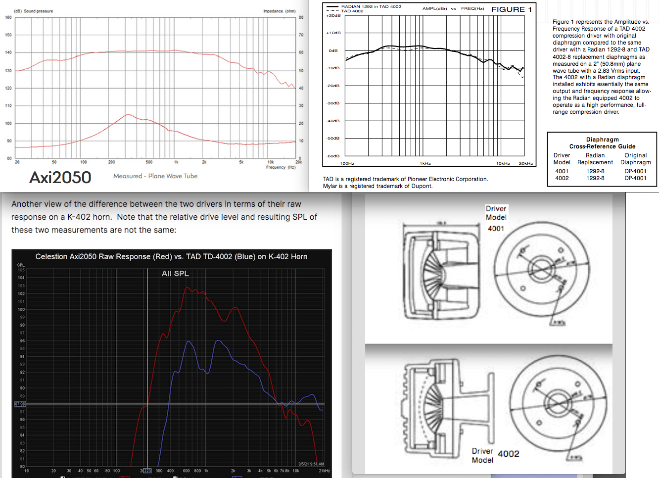

Seems like 800hz is about right for the Axi no less than any proper 4" compression driver, with exception that the Axi would have better midrange or slightly lower extension, via slightly more excursion ability. I'll gamble and say that Axi has about 100hz more extension than the alternative compression driver. 300hz vs 400hz with a horn for pro use.
Camplo,
"Pro use" is a rather vague description, though I'd agree the Axi2050 has an extension of 100 Hz lower than an alternative 4" diaphragm compression driver such as the TAD 4001 or the current 4002.
Both the plane wave measurements and those drivers on the Klipsch K402 horn (roughly conical with tractrix secondary flare, about 35.5 inches wide, 21 inches high, 17 inches deep) show those response differences.
On the K402, the TAD 4002 is +/-3dB from 400 to 4kHz, while the Axi2050 is +/-3dB from 300 to 3kHz.
Regarding the xmax / mechanical limits of the AXI driver...I've some experience thrashing on them on K402's and 2360A's with test signals. Provided you aren't running them full power below 300Hz you will not want to be in the same room with them if they are being driven hard enough to approach mechanical limits. I don't know where that limit is. These are very "hardy" units. I didn't go past roughly 23 volts. Ear plugs under shooting muffs wasn't enough. Distortion jumped up below 350Hz with the 2360A and below about 400Hz on the K402. 500Hz min or higher XO would be best for BIG environment "Pro" work. The WG the CD is attached to is a major factor in the performance of course. YMMV.

Thanks for the info @Josh Ricci ! That is very telling. Distortion wise, how low do you think an Axi could be used with a Waveguide?
That makes 2 of us :ROFLMAO: I would think that still the XO is going to be approximately 800hz, unless somehow the Axi sounds acceptable with the extension used at the same time with 20khz in mind. At the 85db listening average it might be able to do it just fine.
