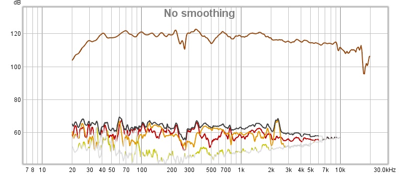

HornResp has a glitch, in editor, where you may get different responses when you should not.
In the pic, the lower box, notice how driver count is one but the response never goes back to the grey line.
Hi camplo,
I came across this post by sheer chance - it would be appreciated if you could please report any future bugs using the Hornresp thread, where I am sure to see them.
The "glitch" you have identified will be fixed in the next update.

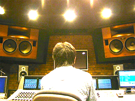

Twin 15" mids....All that Sd along with FIR filtering optimized for a one man listening position....
If you had to finely eq and tweak the dynamics of a bunch of material as fast as possible, don't you think you'd want all that Sd?

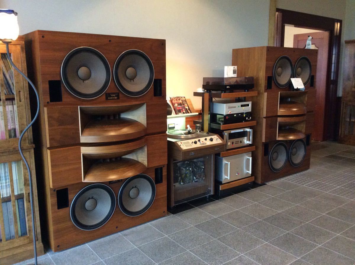

Because i've been exposed to the same kind of loudspeakers th4001+ 2x12" (half of one side in pictures but from Kinoshita, not Tad/Exclusive) i would not cry for this: sweetspot must be 20cm wide!
With only one (Kino version of this )horn it could be different though ( basically a Kino' Warp monitor)...
Camplo, you can make many different layout with the drivers you have ( and knowledge you gained too). But without having prototype builds it is only ideas on screen. Only builts will give you the 'real' issues you should focus on imho.
