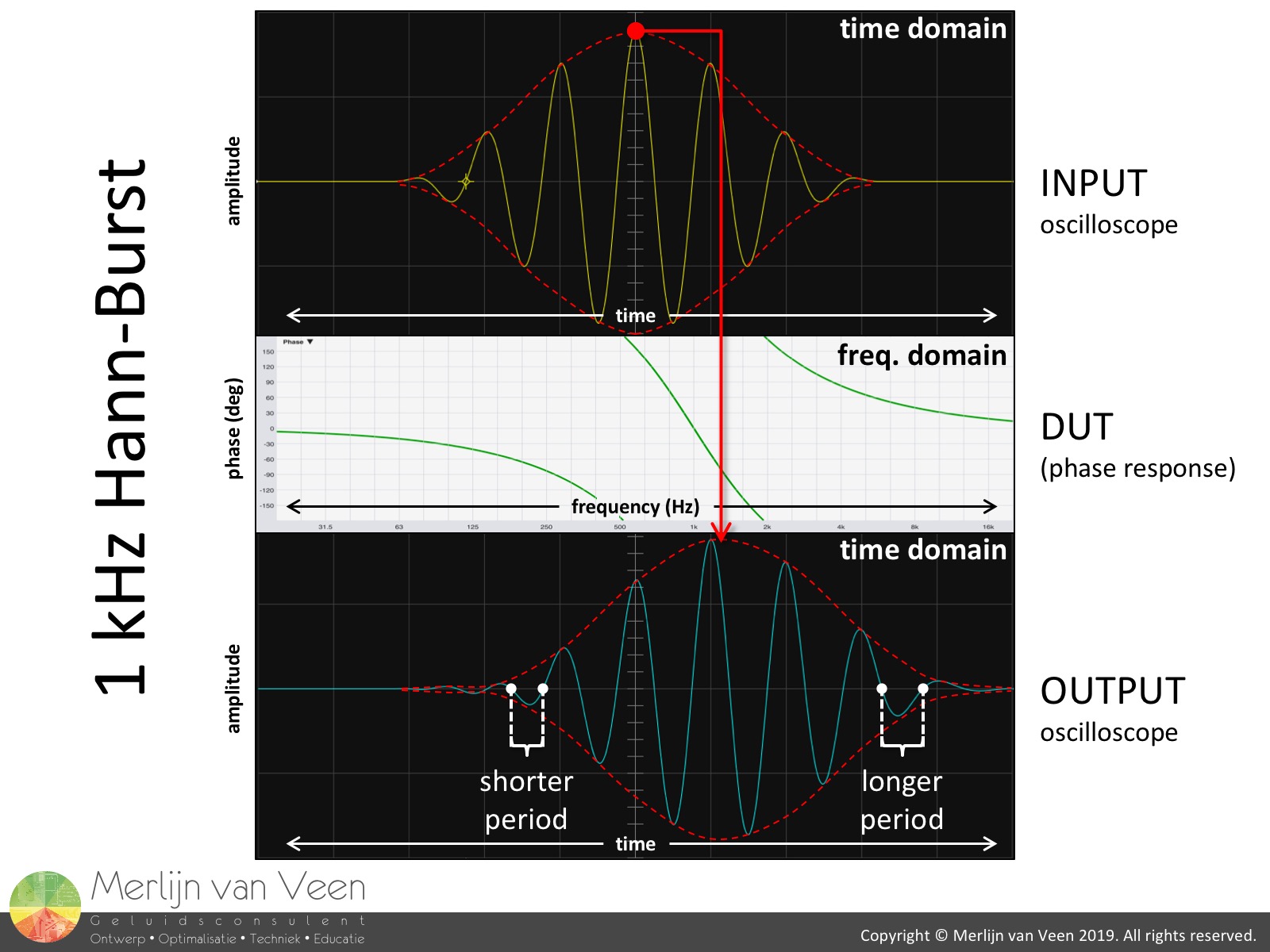

apples and oranges group delay for high speed data transmission is not anything akin to the phase inversion problems of low speed, low frequencies of audio...
I think I know what Camplo is trying to say. He meant the point in time where most of the spectral energy from a transient signal arrives.
Depending on the GD curve this point may indeed exist but it is not necessarily so.
But I guess he understood that GD is causing temporal dispersion of the input signal.

Yes, that is what i was thinking he meant, too.
Hoping he meant that really, because i believe that is an intuitive leap in understanding the relationship between the time domain (impulse / energy-time-curve response) and where on the frequency & phase traces the time domain spectral energy comes from.
The fundamental principles of group delay are the same in each case.

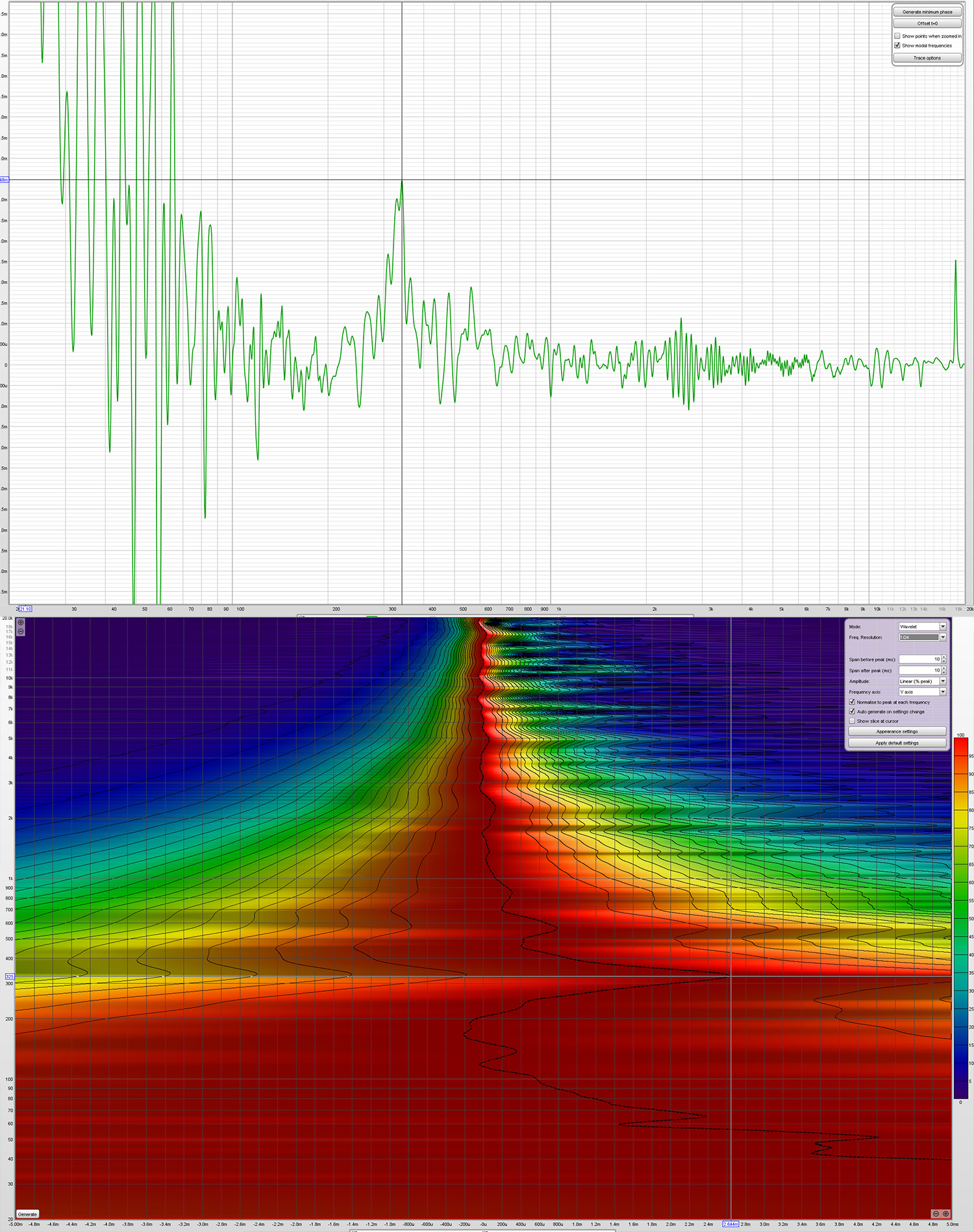

I just adjusted my REW results, to a higher resolution, and the peak energy time in the CSD are corresponding to the GD.....nuff said lol, its not 1:1 but the trend is almost identical...

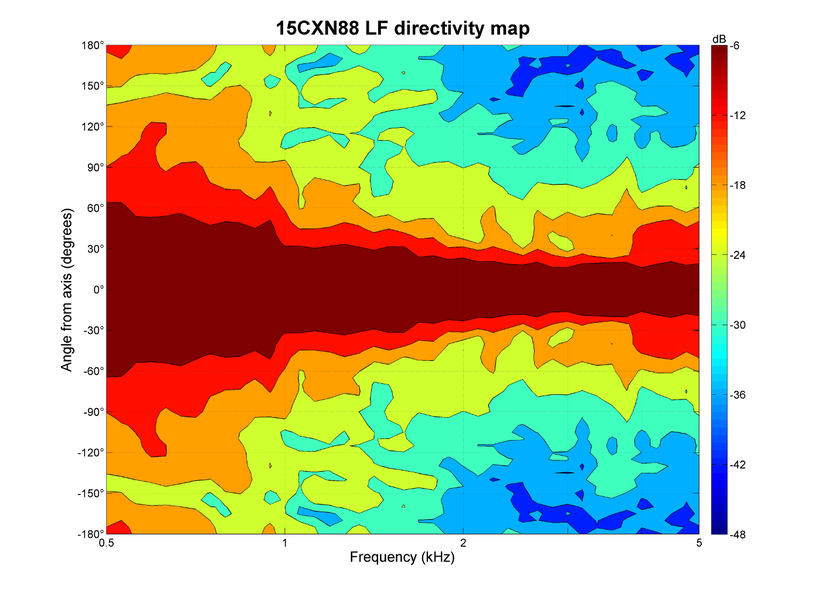

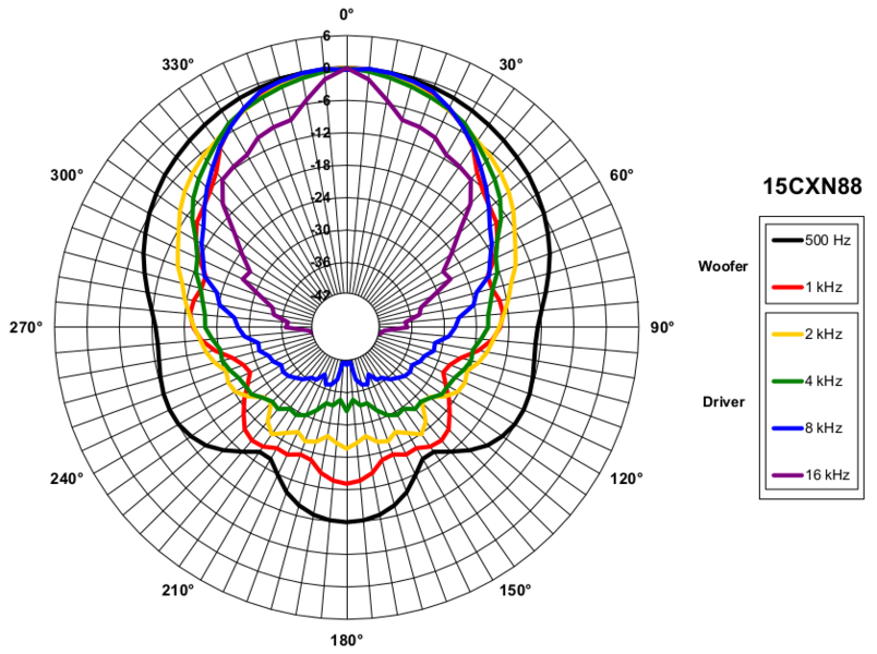

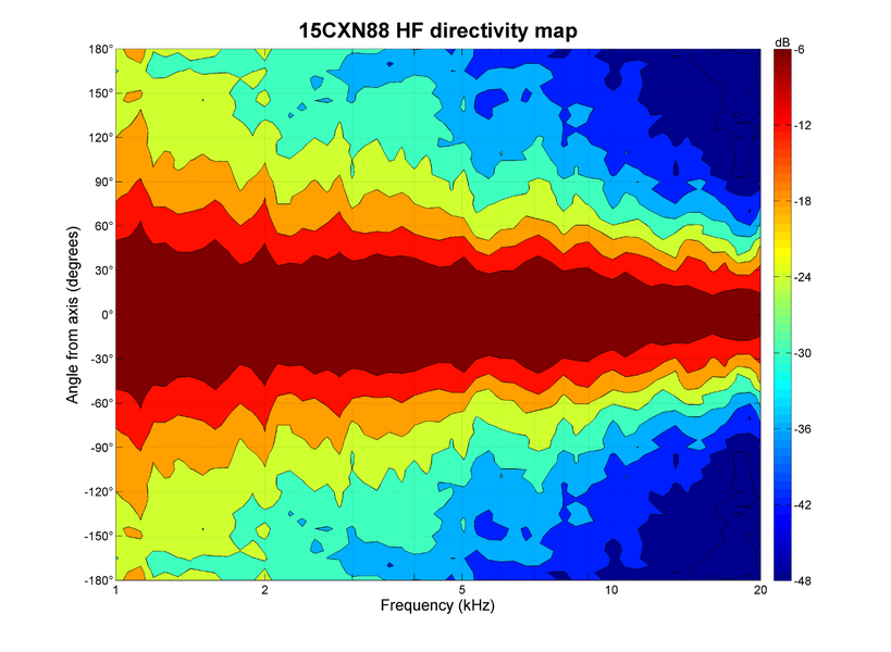

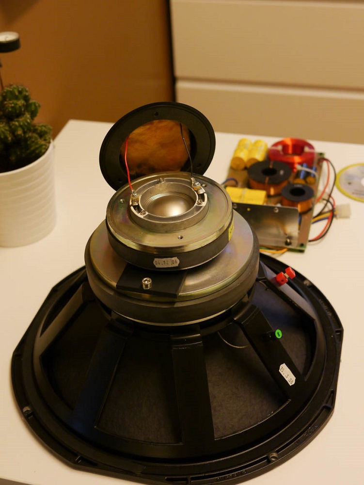

What do you guys think of this for a top? Vs Axi + Horn, pros n cons?
The VX 15HP polar response looks smooth from around 1kHz to near 10kHz, both horizontally and vertically, good for near and far field response on/off axis.
Without seeing the polar response of an Axi + Horn + 15", not much to compare, other than the larger Sd of the Axi's diaphragm should allow more output potential above 1.3kHz than the VX 15HP.

From Tannoy I would expect to use a Tannoy.
That's what I would expect as well.
The only Tannoy 15" Pro driver I know is the older Tannoy 3816 that was used in the V15 and which looks different from the driver in the more recent VX15 HP.
