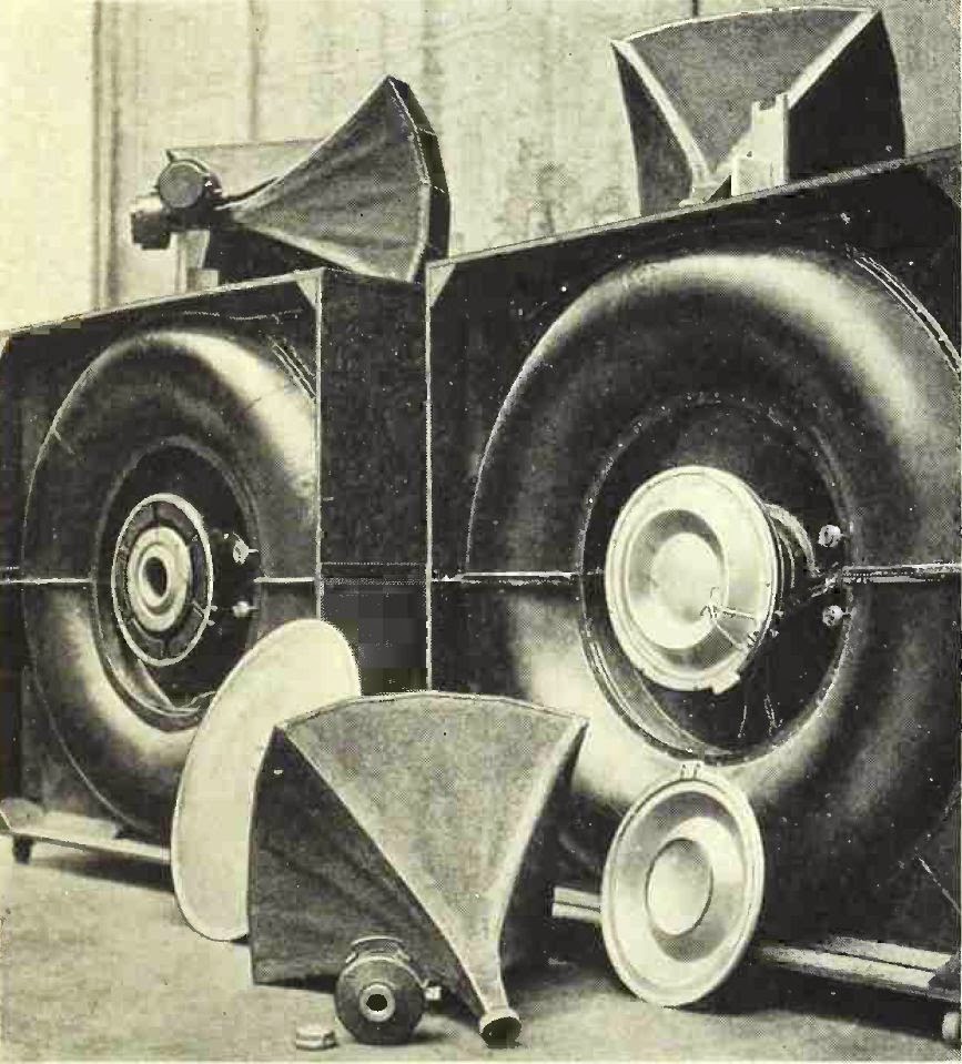

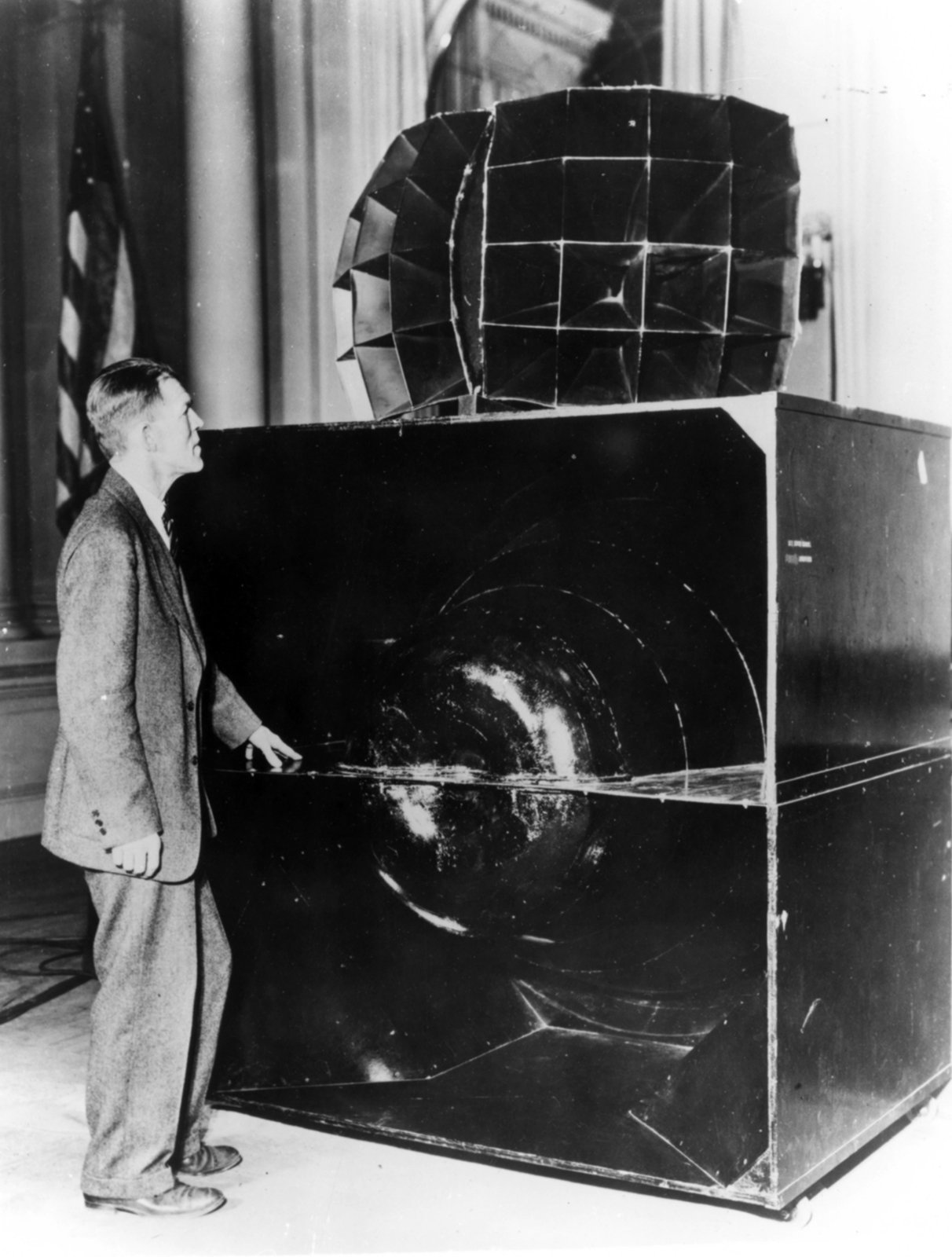

2-way, fully hornloaded, (semi-)time-aligned, nearly 85-year-old loudspeaker system.
Loud Speaker for Auditory Perspective by E. C. Wente and A. L. Thuras (1934).
The Fletcher system was the father of the Shearer sound system and all those to come.
(Courtesy of itshifi.com)
In the comment section, someone posted:
"In 1971 or 1972, I got a look at these speakers in the basement of the Seeley W. Mudd building at Columbia University. By the way, the metal diaphragm pictured in the lower right is 20 inches in diameter. The attached voice coil is 8 inches in diameter.
At that time, custodians reported that these and other artifacts were being taken out of storage and disposed of or otherwise moved to other locations. These kind souls actually gave me a General Radio 723-C 1000Hz vacuum tube tuning fork based frequency standard. When I asked about the availability of the horn loudspeakers, they rolled their eyes and said, "No, there are plans to preserve and keep those." So I assume they are still around somewhere."

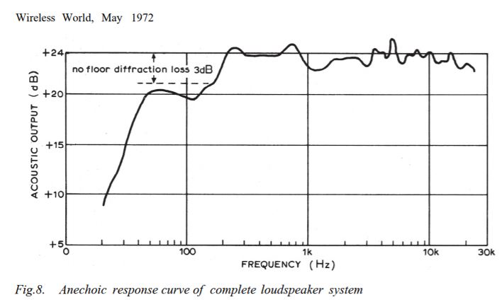

@camplo, the TL I had from this article using the KEF drivers (B139 woofer) had excellent mid bass as well as deep low end. Check out the response with the attachment. I had the Radford FN10 XO, but I would have to dig out the specs to see where the B139 XO frequency was. All I remember is musical bass that went deep effortlessly.
From the article: "As mentioned previously, response curves should be treated with extreme caution as they represent only part of the performance of the speaker. Nevertheless the overall response curve should be as flat as is reasonably possible. The curve for the complete system when measured in an anechoic chamber’ is shown in Fig. 8.
In looking at this curve several points must be noted. First, the falling bass response shown will not occur in the same manner in a room. The presence of a floor will give a 3dB lift due to the absence diffraction in the downward direction. Similarly, wails and ceilings add to the on−axis bass output. In fact a ‘flat’ response in an anechoic chamber will sound very bass heavy when the system is used in a normal room. Under normal room conditions the bass output of system described is quite adequate, windows being easily rattled at 30Hz."

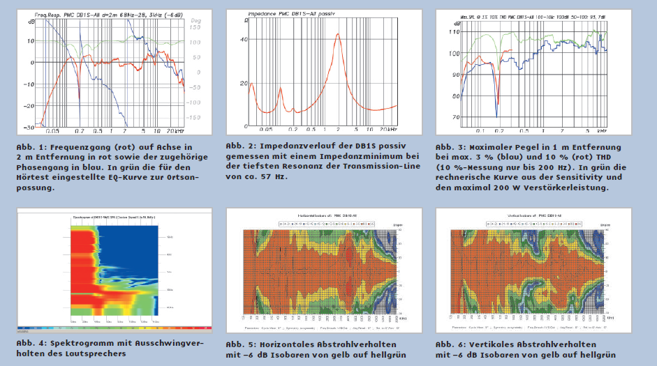

PMC doesn't publish measurement data, here's why.
These are anechoic measurements of the PMC I owned, taken from 4m at an acoustics lab by Audio Engineer Prof. Dr.-Ing. Anselm Goertz.

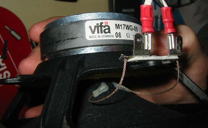

Funny detail: the vifa M17WG-09 mid driver in the PMC is closely related to the vifa drivers used by Lynn Olsen (in the Ariel), Troels Gravesen and Living Voice.

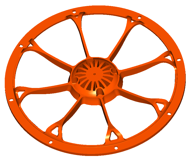

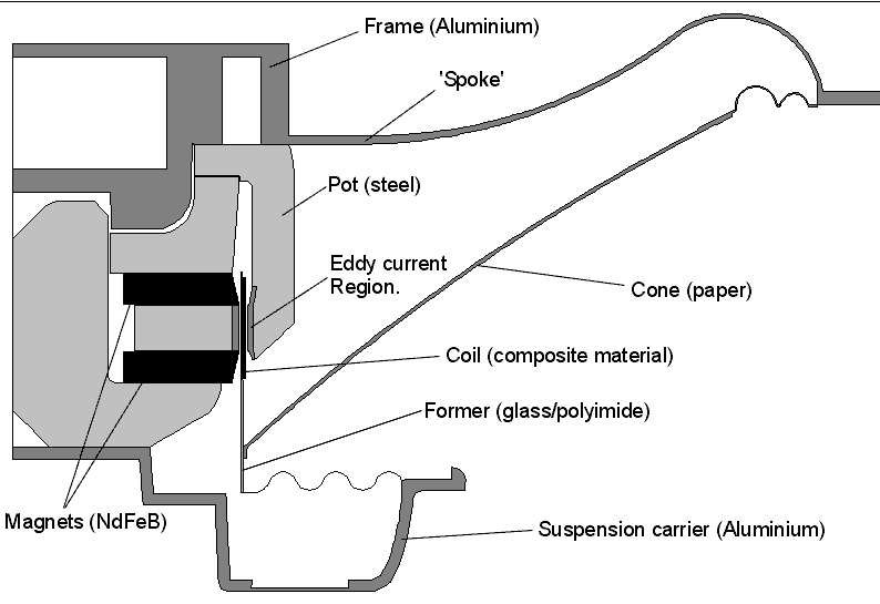

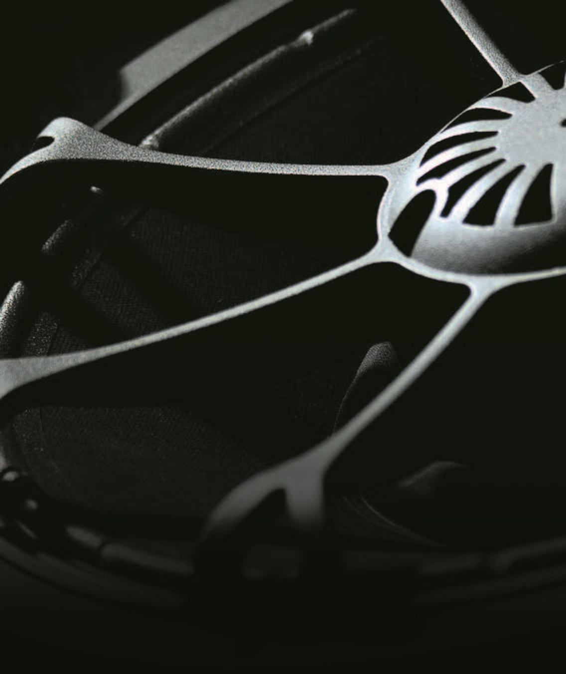

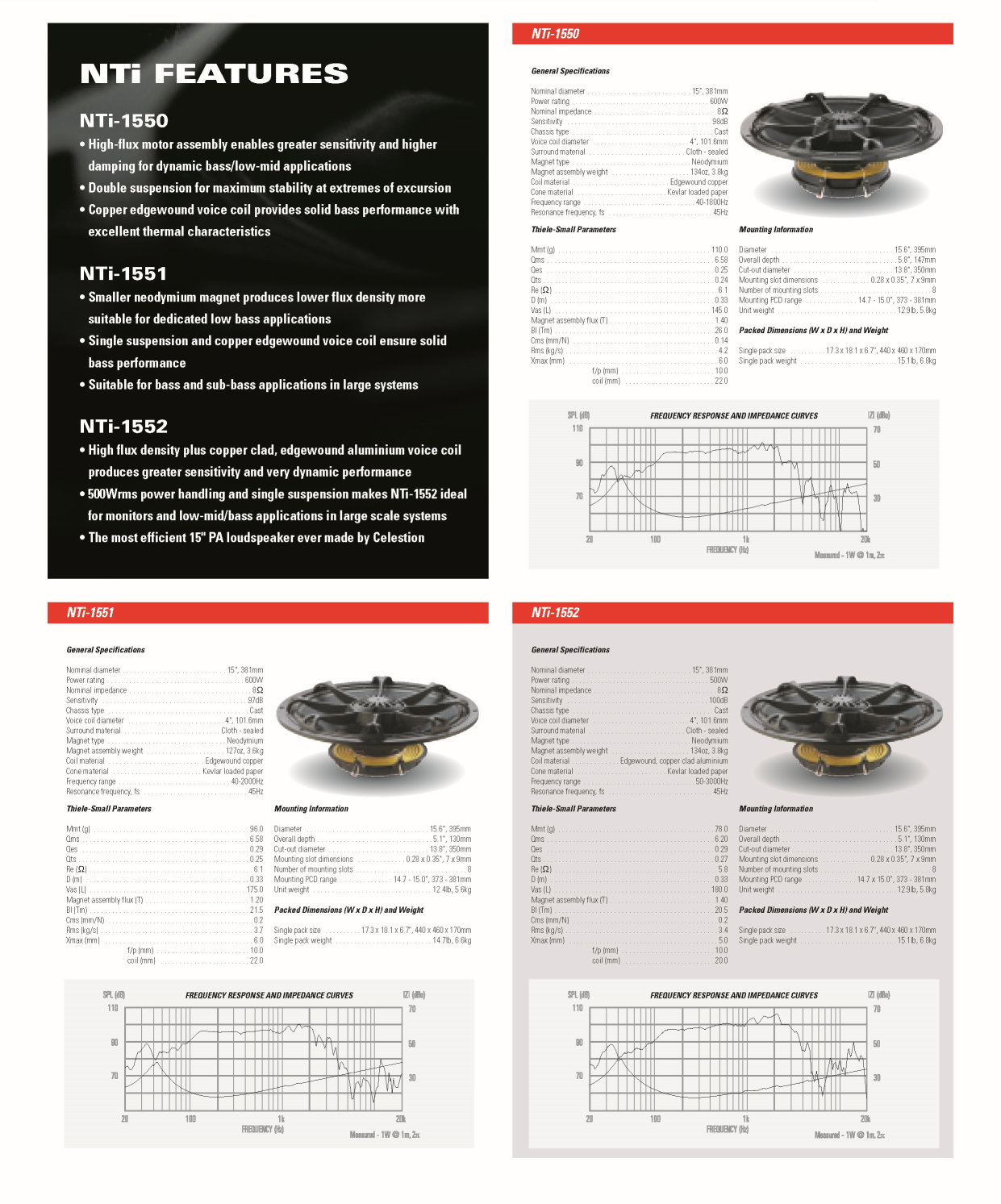

The Volt woofers always remind me of the short-lived Celestion NTi series, developed in the early 2000s by Mark Dodd - one of the brains behind the Axi2050.
The NTi woofers featured an inverted Neodymium magnet structure in an axisymmetric frame.
"The NTi Inverted Neo range were the first ever professional drive units with this level of power handling to incorporate a
Neodymium magnet structure. This material produces far stronger field effects than traditional ferrite magnets, so the magnet
structure can be made much smaller and lighter while still yielding an extremely impressive frequency response. As a result,
NTi speakers exhibit superb detail at an incredibly low weight.
The front-mounted magnet assembly allows the speaker to operate at a much higher power than would otherwise be possible.
With a conventional back-mounted assembly, heat dissipation from the magnet structure can be limited, causing thermal
effects that impair the performance of the driver. This ‘inverted’ chassis design permits the magnet structure to radiate heat in
free air, giving the best possible cooling.
Other characteristics of the NTi range include double suspension for maximum stability at extremes of excursion and an
edgewound voice coil for enhanced bass performance. The NTi-1552 features a copper-clad aluminium voice coil to reduce
moving mass and inductance, making it, at 100dB sensitivity, the most efficient 15" PA loudspeaker ever made by Celestion."
