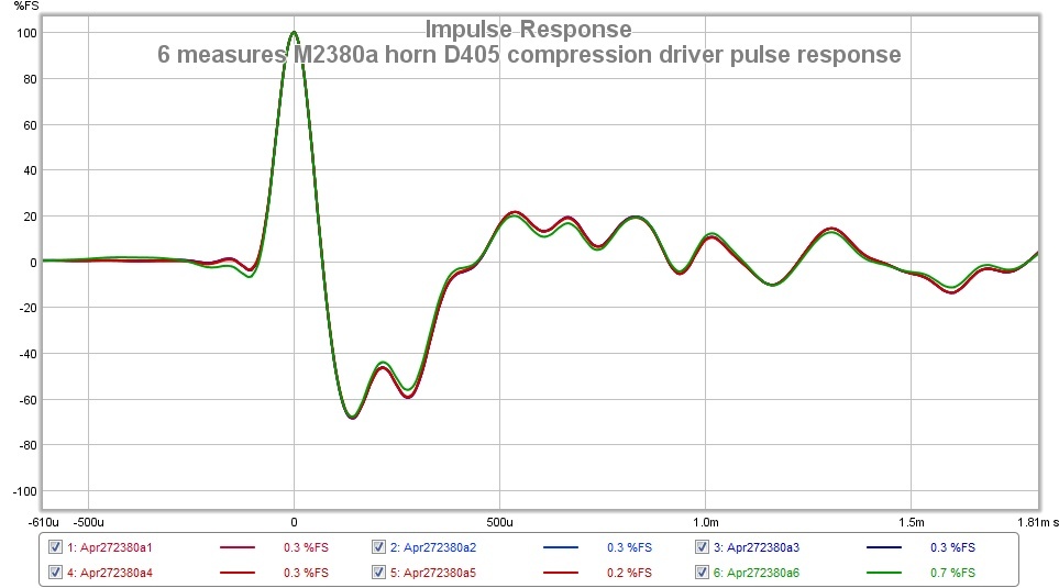

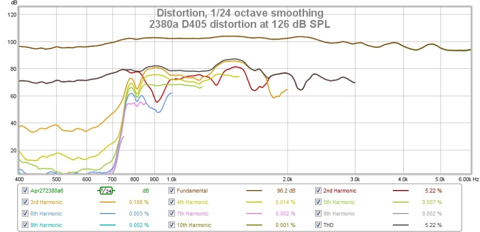

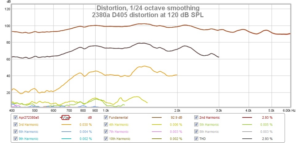

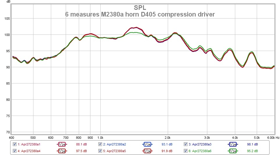

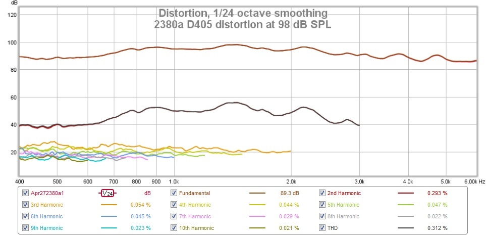

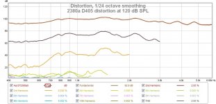

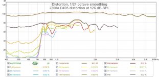

Hey Ro808, np, attached. The two threads that match the plots are:
https://www.diyaudio.com/forums/multi-way/268577-jbl2380a-myth-busting-3.html#post4308133
and
https://www.diyaudio.com/forums/multi-way/268577-jbl2380a-myth-busting-3.html#post4308762
I would not put too much emphasis on the distortion measurements as the measurement mics distortion is unknown as is the Pass Class A ACA amp. I don't have that system anymore, so can't take any further measurements.
6 measures m2380a horn d405 compression driver pulse response.jpg85 KB · Views: 530

Thanks Mitch, these are much easier to read ;-)
