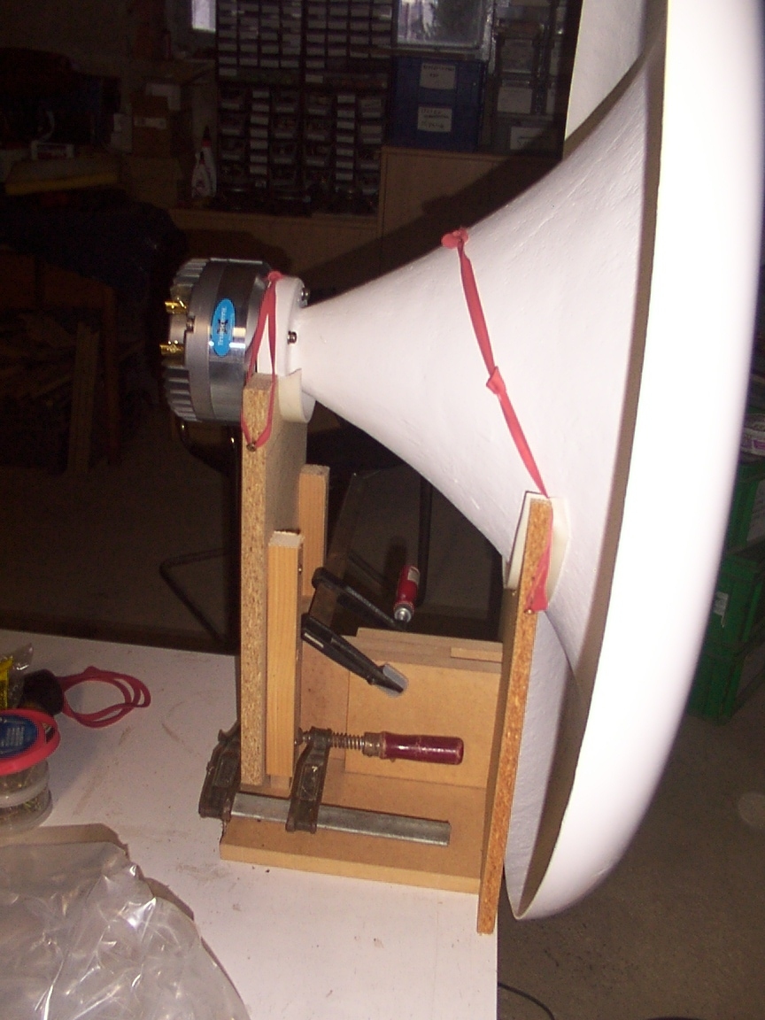

Agreed, smaller horns and specifically shallow waveguides 'need' a baffle.
This isn't necessary if the mouth rolls back.

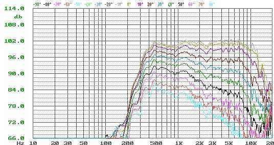

Some measurements of the above horn with 950BePB.
This is with rudimentary correction by means of passive components.
With DSP this response could be improved.
Interesting! Who build this horn?
KR Barossi
