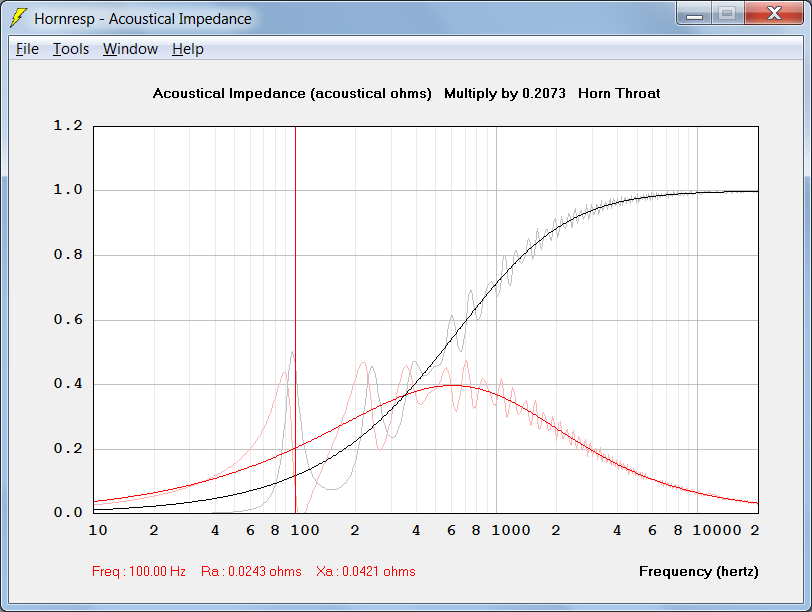

Hi Bill,
I figured you did, that's why I mentioned it - I just couldn't resist 🙂.
I didn't anticipate that it would precipitate the infinite parabolic horn discussion that followed, though 🙂.
Together with Buzz Lightyear, Hornresp has no problem with infinity - the attachment shows the throat acoustical resistance and reactance of a representative finite parabolic horn (light traces) compared to the impedance of the same horn extended to infinity (dark traces).

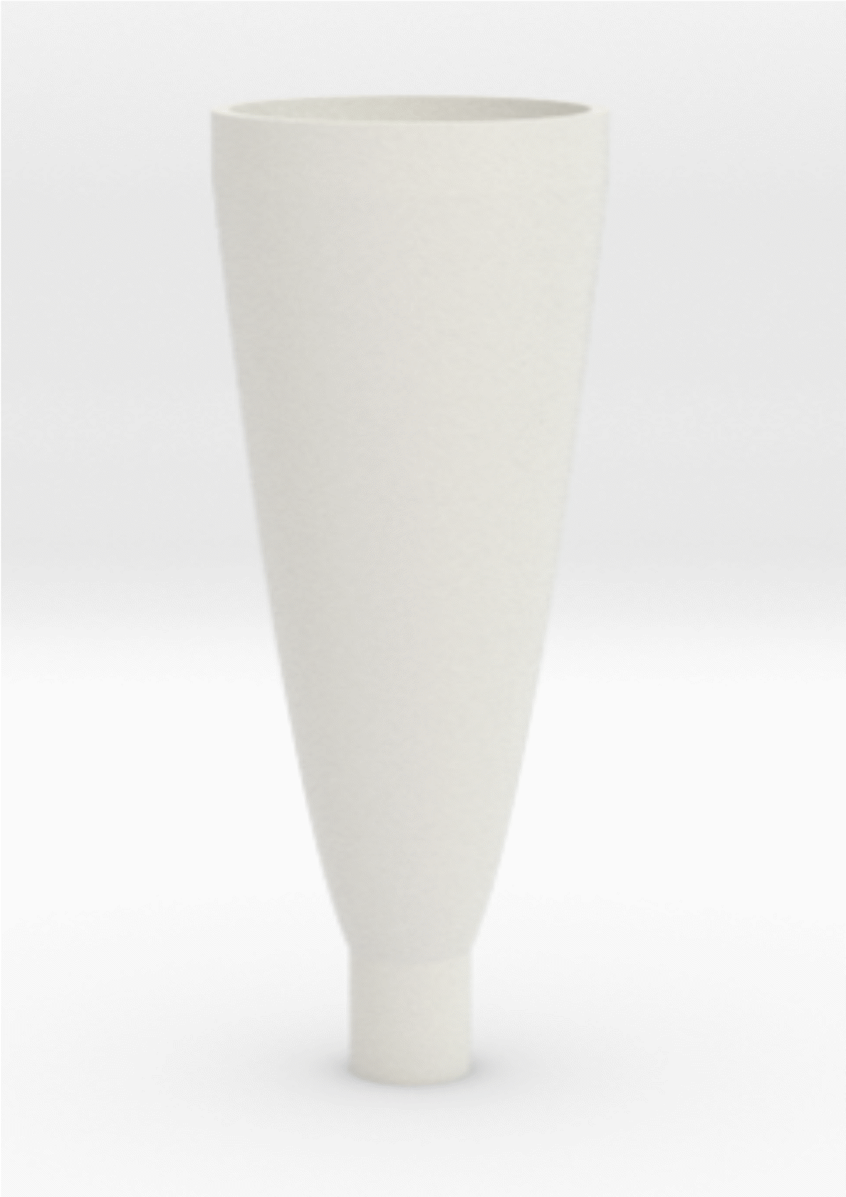

Hi David,
The finite variety is sufficiently cylindrical as well.
Note the cylindrical ring at the mouth of this one.
Even at this short length, the differences in curvature and slope are becoming miniscule between it and the parabolic horn body.
If you extended this one out say to three feet or more, the differences would be unmeasurable even with a micrometer.
Bill

So long as radius of the reference cylinder is commensurately expanding as well, the slope of the generating parabola will be getting closer to that of the adjoining cylinder, while both radii of curvature (transvers and longitudinal for the paraboloid, and transverse only for the cylinder) head toward infinity as well. Until they get their, the differences between the two surfaces continue to diminish. I never claimed the horn mouth (parabola leg spread) would not continue to expand with an increase in length; only that the cylinder radius would increase with that of the adjoining paraboloid.
