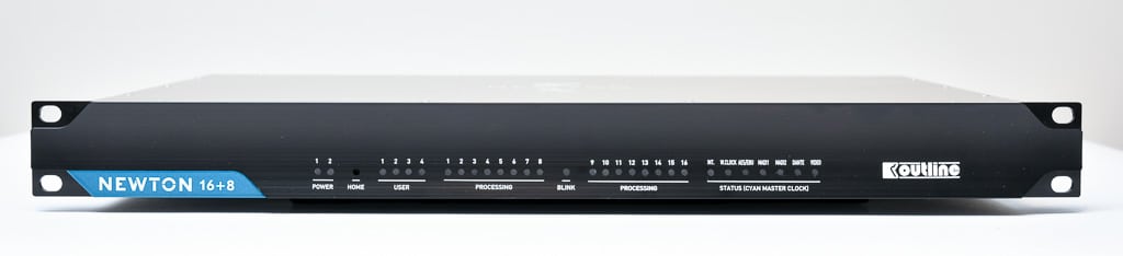

Anybody using this?
Overkill at home, but nonetheless an advanced all-in-one solution.
Yep Ro808, there are awesome new processing platforms coming out every day.
Outline's Newton you showed looks interesting.
The thing about it, and other similar hardware devices that bugs me though, is hardware cost$$$$...
and knowing how quickly the hardware will head in to obsolescence.

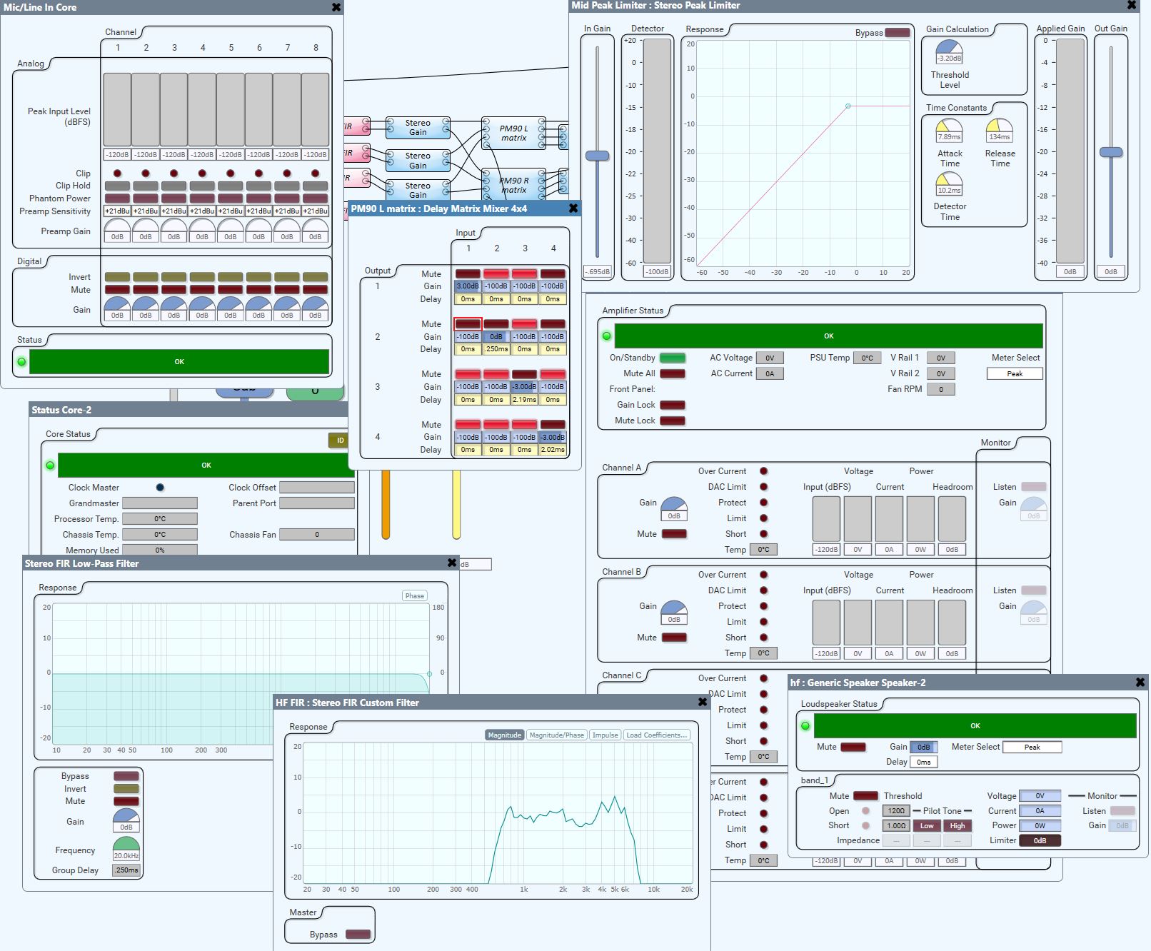

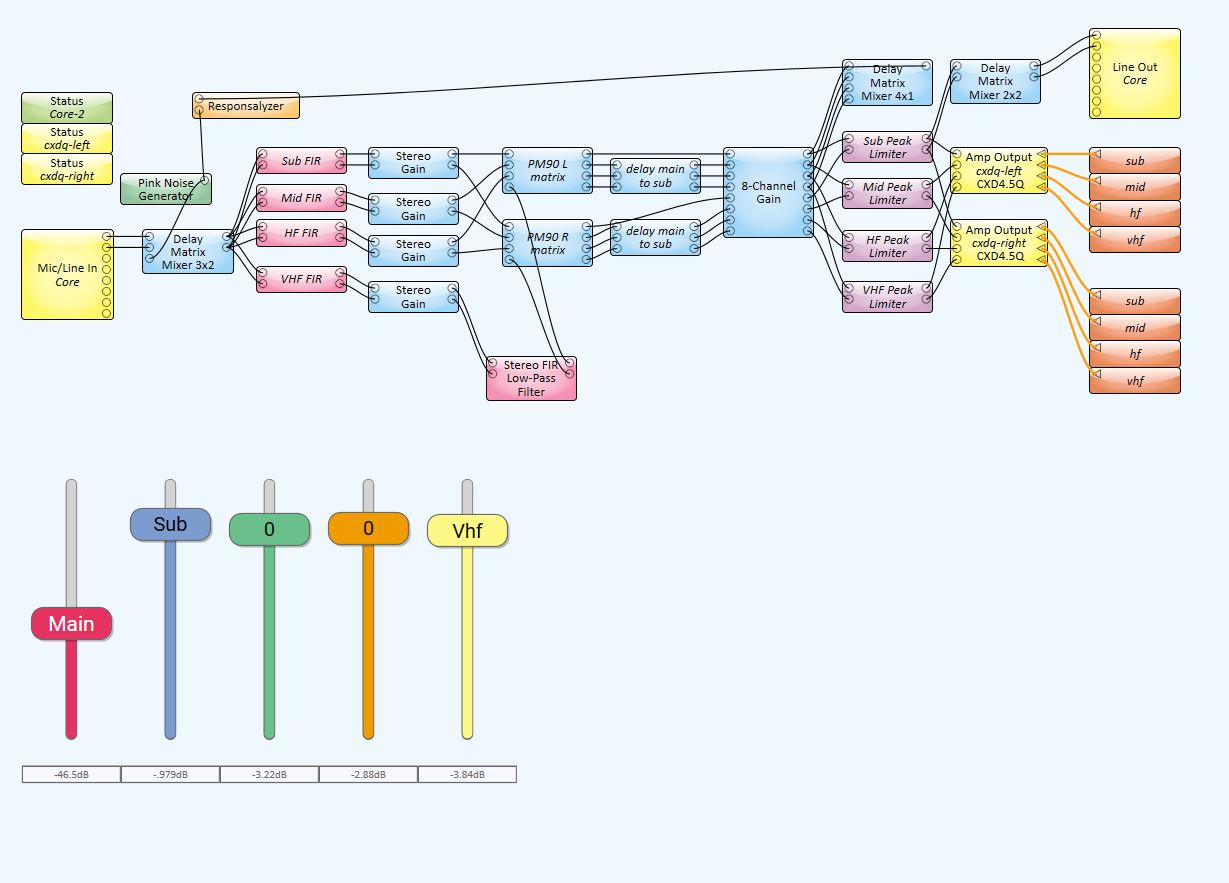

That's what has driven me to Q-Sys.. The hardware cost is there, but much much less than examples like Newton...and cost is occasionally even kinda low when you grab gear off ebay that came out of an install.
Because the cool thing with Q-Sys is that it is software based, designed to be compiled on q-sys cores. So there are no operating system issues to contend with. And the software has the same capabilities no matter how large or small the audio design. Mega hardware processing is only needed for mega sized installations.
Below is a q-sys design screen grab for one of my multiways.
Each component in the design blows up for use/adjustment/monitoring, like shown for a few components in the second pict.
I love it !

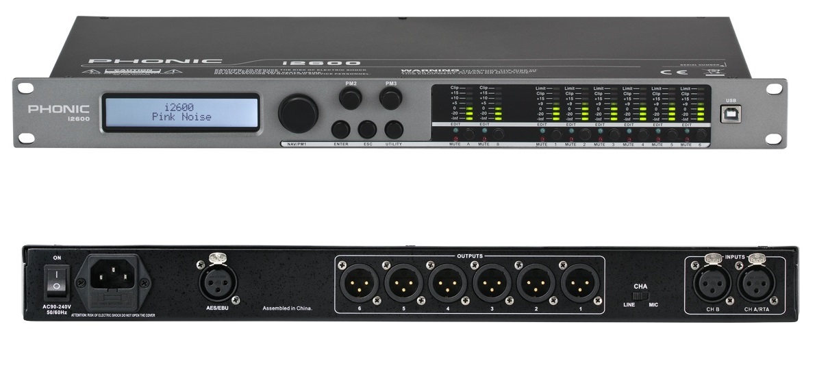

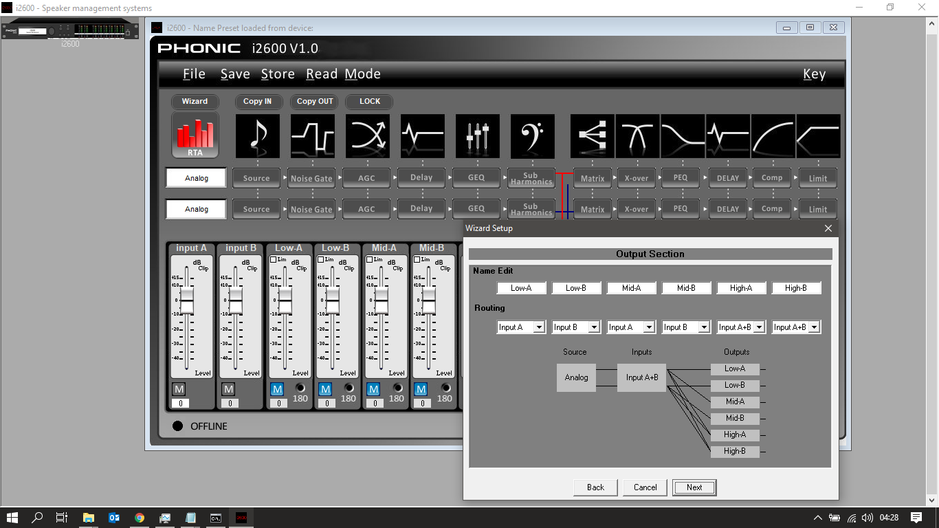

Good tip about the QSC Q-Sys, Mark100!
It's a fact these (proprietary) platforms become obsolete rather quickly.
Unfortunately, the digital inputs and DACs are often lacking in quality and resolution, especially with the cheaper units.
This is an exception; limited to 48kHz AES/EBU and no FIR support, but decent low noise DAC/DSP stage (AKM).
It's on par with the Xilica units wrt audio quality and also very cheap nowadays > around €250 new.

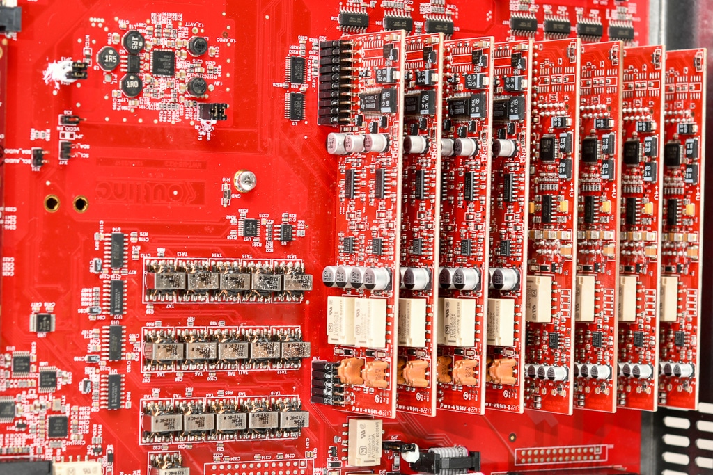

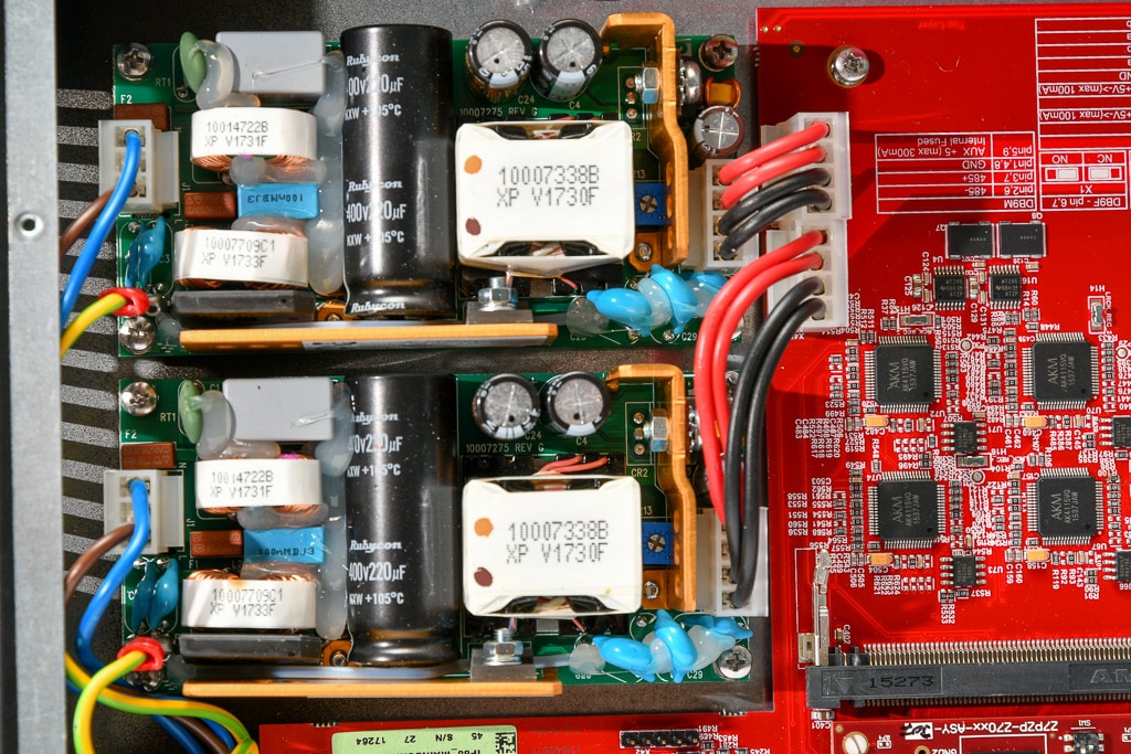

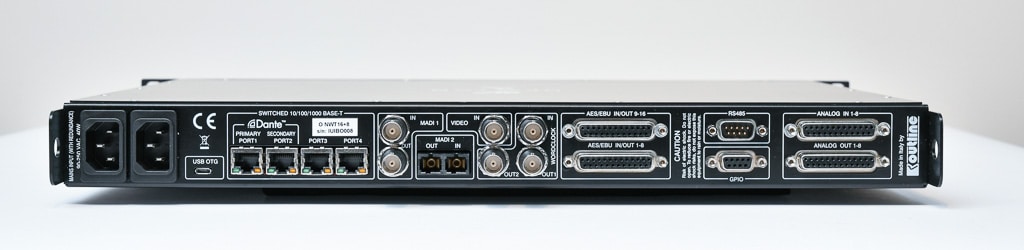

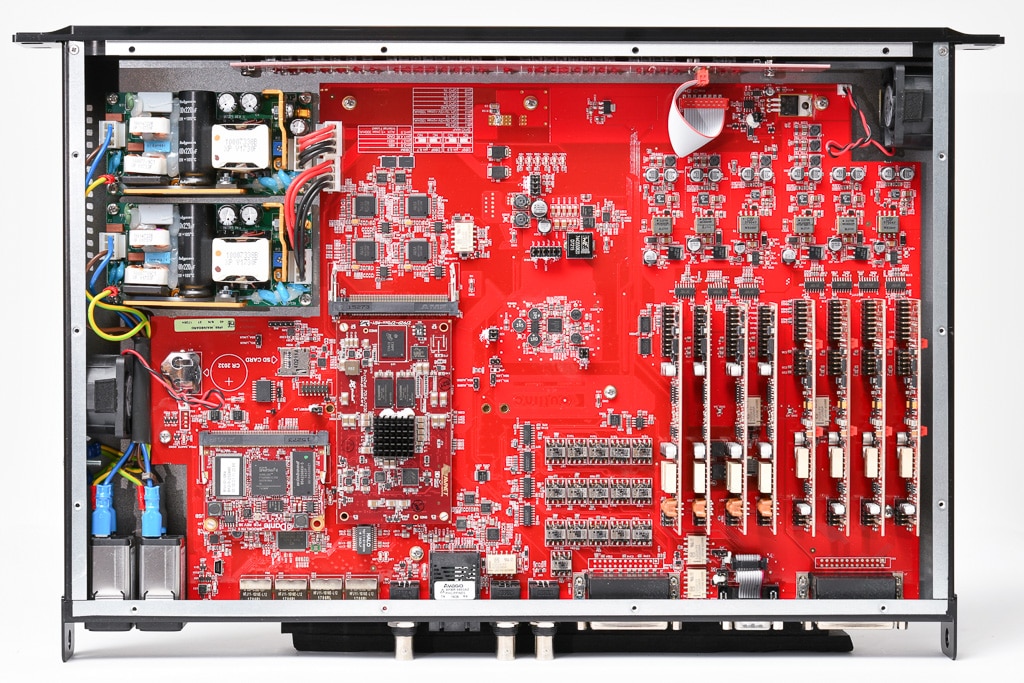

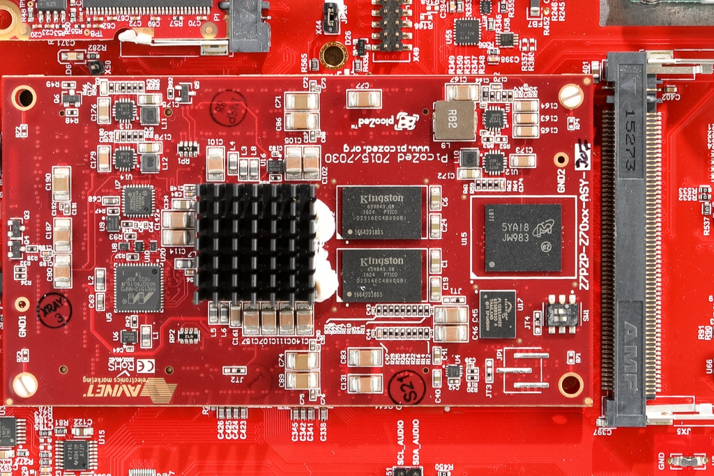

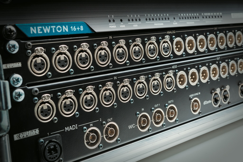

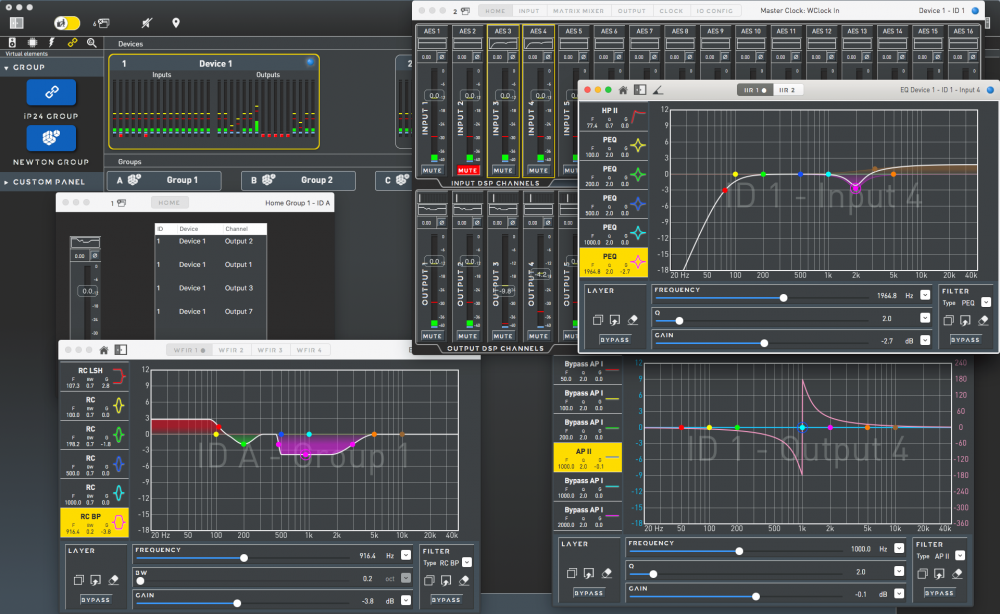

The Q-Sys platform/ecosystem appears to be one of the most comprehensive, versatile and future-proof on the market.
The Newton, in the basic version without analogue inputs / outputs is listed at € 6,500.
Four analogue inputs and outputs are available at a surcharge of € 1,500 and eight each for € 3,000.
System-On-Modules are PicoZed, based on the Xilinx Zynq-7000 SoC.
Newton is MacOS only.
