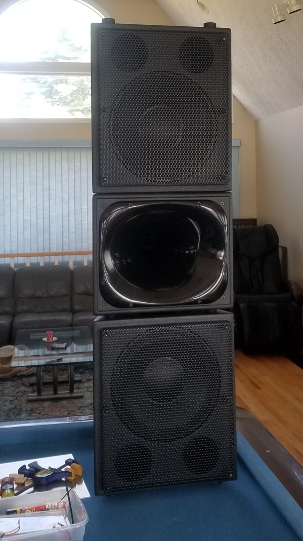

JBL 2352 horn + BMS 4595ND, 2x B&C 15TBX100, XO @ 500Hz with 8th order slopes:
My modular version: bms4594 on xt1464 2x rcf mb12n405
XO @ 650Hz with 16th order slopes
but alas, all high passed @100Hz, cause can't no dang 2-way make high spl bass!!! LoL
Small wonder with those whimpy 12" Drivers !
