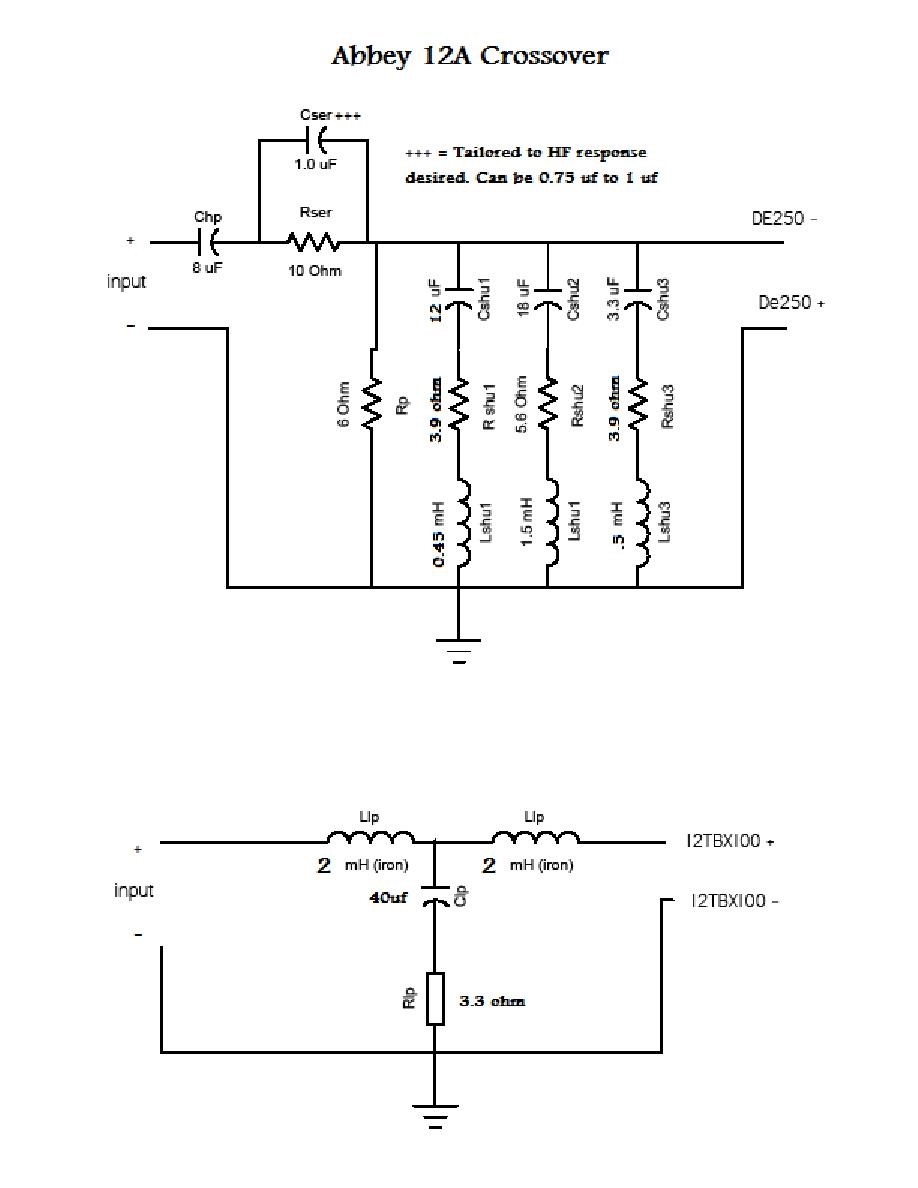

Dr. Geddes, would it be too much to ask to show an example of one of your filters, or something similar?
Do you mean the topology or the response? I still have some of that data somewhere, but I haven't done any of that work in a long time. The attached shows the topology. The PDF is incomplete.
Yea, those, not so much.
Looked, couldn't find any. I tended not to measure the electric response alone, only the system response.
