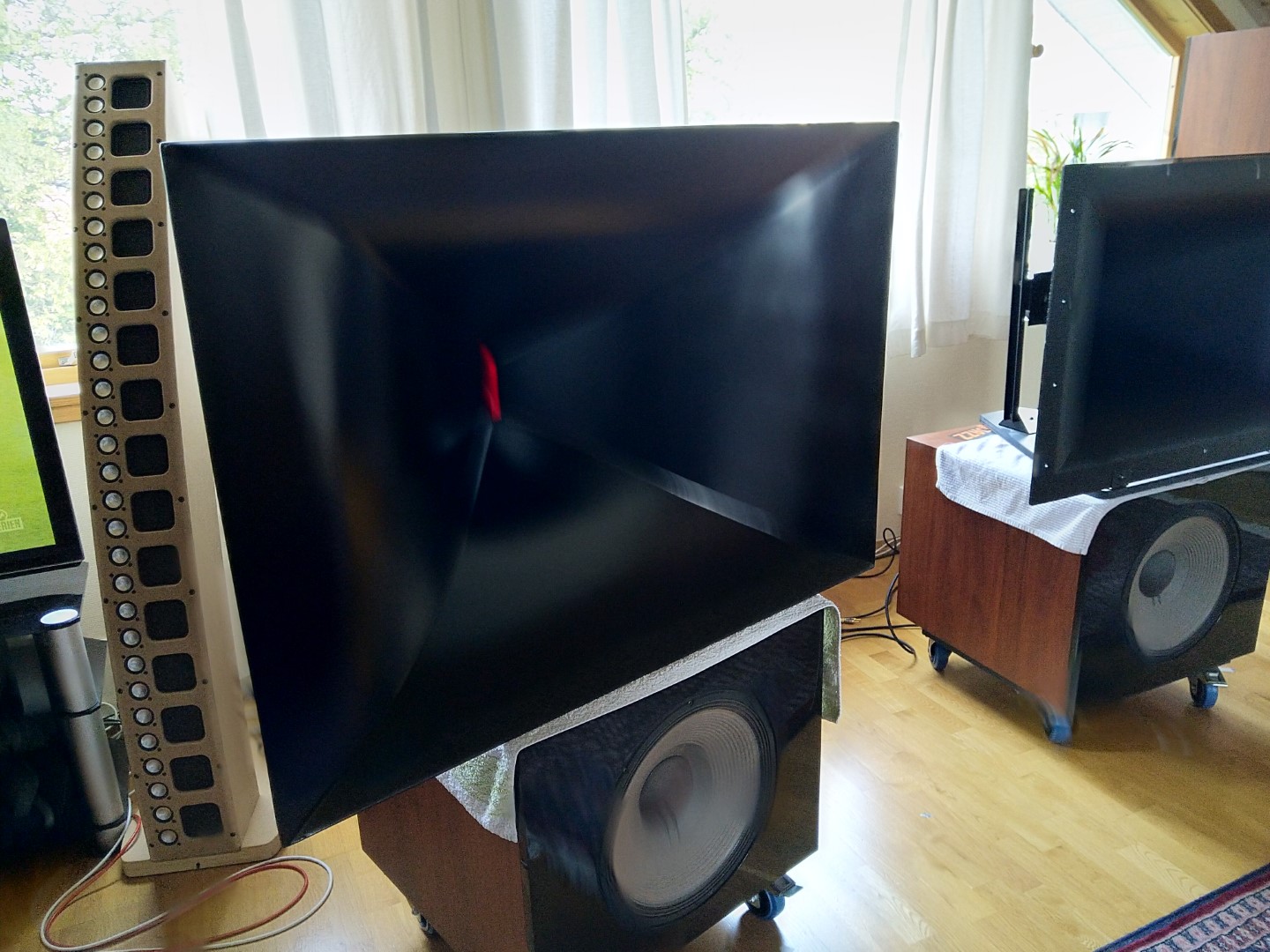

IMHO the horn below is considerably better than Klipsch K402, which I have compared it directly to with hours of listening. The directivity is kept lower in frequency and considerably higher compared to the Klipsch horn. However, it doesn't have a very wide dispersion. It's a 90x60° horn, but which is really sufficient to fill most room with correct placement.

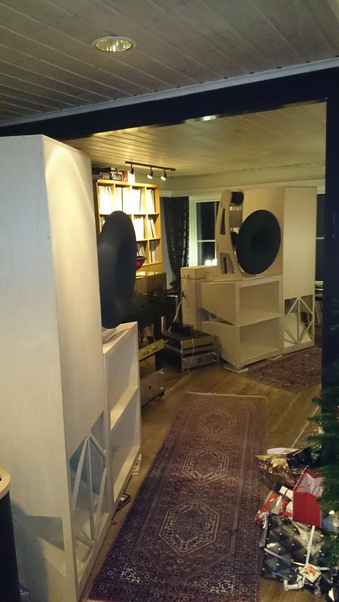

I'm still searching why i can so easily localize the subs, the video was not totally meaningless, the sub array sould be very, very cleaverly tuned on the same frequecy range IMHO.
The come back to very high efficiency large dipole woofers is a benediction in term of spatial rendering, the LF section is back to 3D 😎
