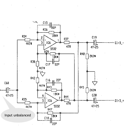

Making a (basic) balanced output out of an unbalanced one is trivial, you just need to know its output impedance:
(Borrowed from a Behringer UB802. R36D may just as well be inside an external adapter. If you need XLR, substitute T --> 2, R --> 3, S --> 1.)
This is what they call an impedance-balanced output. For best results, impedances need to be mirrored as precisely as possible, so if e.g. there is a coupling capacitor you'd want to replicate that as well.
There are further advantages to be gained from more advanced circuits, which is going to depend on the balanced input stage.

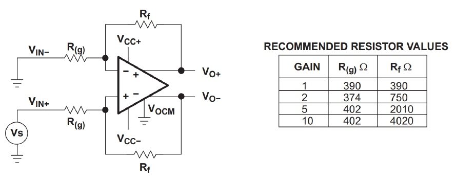

Active volume control with balanced output using 2 op-amps
Here you will find various circuits of floating output stage :
Control level with quasi-floating output using 4 op-amps
That is definately NOT balanced.Making a (basic) balanced output out of an unbalanced one is trivial, you just need to know its output impedance:
It is balanced and extremely common in pro audio. Sometimes called "impedance balanced" (as already said).
