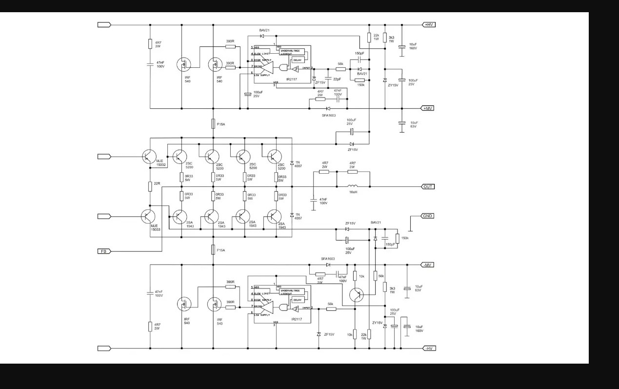

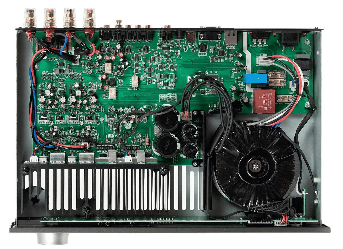

Is it possible this amplifier puts anything out in true Class A?
Model number ? Arcam sa-10/20 ? Class G with high /low rails.
When running low rail it could be running mostly A , crossing into AB at the high rail.
PS - even before it threw it's pix at Google , easily ID'ed as a class G.
NICE clean layout !!
Even a big class AB with many parallel devices can be biased to do the first 5W in full A.

Yes, correct. It's my SA20. I have a lot to learn. I would have thought the heat sink is too small for proper Class A operation, even if it is only for a watt or two?
Nah , at low rail , just 1 pair of those tiny devices can't dissipate much . Low rail is only 25-30V (smaller PS caps=35V).
That Arcam might have a active bias control.

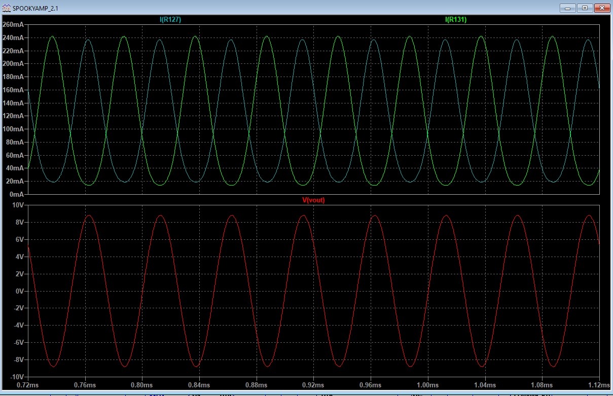

I have fooled around with a opto- switch Vbe control on my OP stages.
Just short of Gm doubling with a low input , more active (average) content backs the Vbe down to 70mA per device. PIC
controlled where even a thermal event will switch the Vbe into "normal" mode !
Edit - Class G splits the Vceo in half , usually doubling SOA and halving dissipation. This is why some class G pro-amp's can
rate a 4 device unit at >300W !

Am I correct in assuming that what you are saying ostripper is that the amplifier may be biased towards Class A but not actually operating as such?
At low volumes OP devices never shut off - class A. At all volumes , or a very dynamic volume it switches between classes.
Even my little sonance 60W is most likely full A when I watch low dynamic range (compressed) streaming TV.
Any digitally recorded modern FLAC will push it AB.
Class G is different , it describes the operation of a switched higher voltage semi pair's operation. At low volumes , it is just class A.
At higher volumes , it is both AB and G.

Then there is switching G/H class. H is the one above. Pro-amp's use a chip + mosfet (true G).
Yes , they even make a IC that determines when to "fire" the high rail MOSFET.
https://solderingmind.com/class-h-audio-amplifier/
Yeah , the IR2117 (now obsolete) ... is the chip.
Actually , you have a nice amp - but class G is obsolete. D is the way for those power hungry subwoofers.
