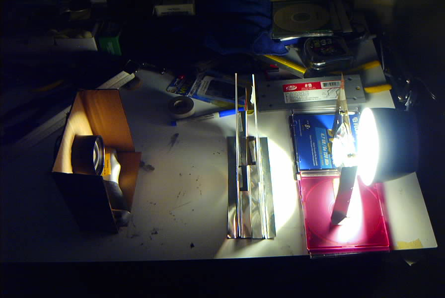

Test Bench
Guy, and ACE,
Here's what I come up with so far, using the condensor & reflector I mentioned earlier. The thing is, in the bench, I'm using a 75 watt incandescant bulb in a desk lamp. I didn't line anything up with measurements but I just eye-balled everything in a line and on center. (I am pretty good at this, I used to be a draftsman.)
Here's the test bench
Guy, and ACE,
test bench
Eye-balling the alignment is okay for the testbench experiments.
I see a big circle of light around your projection lens. That tells me your fresnel(s) are not making a nice image of the lamp arc (or in this case, the light bulb) at your projection lens. All that light falling outside the projection lens is wasted.
Alignment

Guy,
RE: The big circle of light,
The lamp in the test bench is a white frosted incandescant 75W light bulb. That makes the arc about 45-55mm I didn't measure, but that's what it looks like. I'll set up with the HQI on Wednesday.
