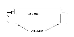

Is it ok to mount a double-ended 250w MHI sideways?
ok its a cheesy pic I know...but...this is how the setup normally looks (obviously I don't have a reflector or condenser in the pic, but you know what I mean)...now imagine this is a 3d render and you can rotate the pic so the bottoms of the FC2 holders are now facing you (and the lamp facing out away from you)...essentially the lamp would now be on its side. Can you mount the lamp in this way and have it reflect off a cold mirror at a 45° angle? Or should you leave the lamp mounted to the base of the projector box and just move the reflector and condesner accordingly in order for it to reflect off of a 45° mirror?
ok I found this pic where it shows exactly what I mean...although the guy who was has it pictured this way does NOT have it this way in his projector...he only has it this way in the pic to show his awesome reflector (which by the way I would LOVE to have so if anyone knows where to get something like that or how to make one, that would be sweet!). So I just wanna know if in my projector, I can mount my lamp setup the way this guy has his pictured.

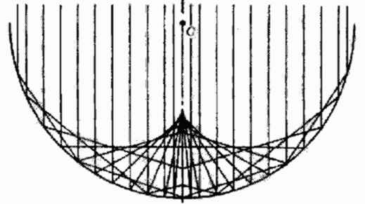

pretty reflector
I looked at that guy's reflector again, and it does not look like a spherical reflector to me. Notice that the center of the bulb tube passes through the reflector pretty far down into it. If it was spherical, then any reflector surface "above" the bulb arc would do no good and only heat the bulb.
I think it must be a parabolic reflector, which would agree with the bulb arc position.
But there is one unsurmountable problem with using a parabolic reflector like this: The reflected rays leave the light engine in a parallel beam, so no lower fresnel is needed to bend the light at the LCD to be parallel. The direct rays leave the light engine in a diverging cone, so they need a lower fresnel to bend them to be parallel. No fresnel and you lose the direct light. Add a fresnel and you lose the reflected light. Either way, half the light will never make it to the projection lens. In fact, the image would probably look better if you left out the reflector! The only way to fix this is to add a tiny spherical reflector to the front side of the bulb. So what was the direct light, heads back through the bulb arc into the parabolic reflector. Oops! Overheated bulb again!
But it is darned pretty! Which should teach us all an important lesson: Nice chrome doesn't make the car go any faster! 😀

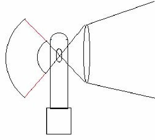

>where does it all go?
Here is a drawing for you. It shows how to use a big reflector or a small reflector. Either way, you put the center of the bulb arc at the center of curvature of the sphere. That is the point that is equidistant from all points on the reflector surface. If you have a quoted "focal length" for your reflector, then it is two times that distance.
The other thing to get right, is that the spherical reflector has to be wide enough so the full width of the condensor lens is covered with reflected light. Otherwise you would see dimmer edges in your projected image. Of course, this is angle is affected by how close you put your condensor to the bulb. And that is affected by how the light spreads out to the lower fresnel.
So you really need to work backwards:
1) Find the right distance between the condensor lens and the lower fresnel, so the width of the condensor lens intersects the cone of light expected by the fresnel. (ie. A 220 mm fl fresnel expects light to come from a focal point 220 mm from the lens. Make a full scale drawing to see where your condensor lens has to go so the fresnel "sees" the light as if it was 220 mm away.)
2) Make a ray tracing drawing of the light being bent by the condensor lens to get to the fresnel edges. Then measure the distance for the bulb arc to the condensor lens, right off the drawing.
3) Put the reflector behind the bulb so the center of the bulb arc is at the center of curvature.
If you start with all the parts adjustable, then you can do all of this using the light from the bulb! Instead of ray tracing, you do this:
1) Do step 1 above to figure out the condensor lens-to-fresnel distance. Fix the positions of both at that distance.
2) Put a piece of white paper against the LCD.
3) Move the bulb position until the condensor and lower fresnel are filling the LCD with a nice uniform light. If the rectangle of light is the same size as the lower fresnel, then you have the distance from the fresnel to the virtual bulb arc correct.
4) Put the reflector behind the bulb so the center of the bulb arc is at the center of curvature. The light falling on the piece of paper should get brighter.
