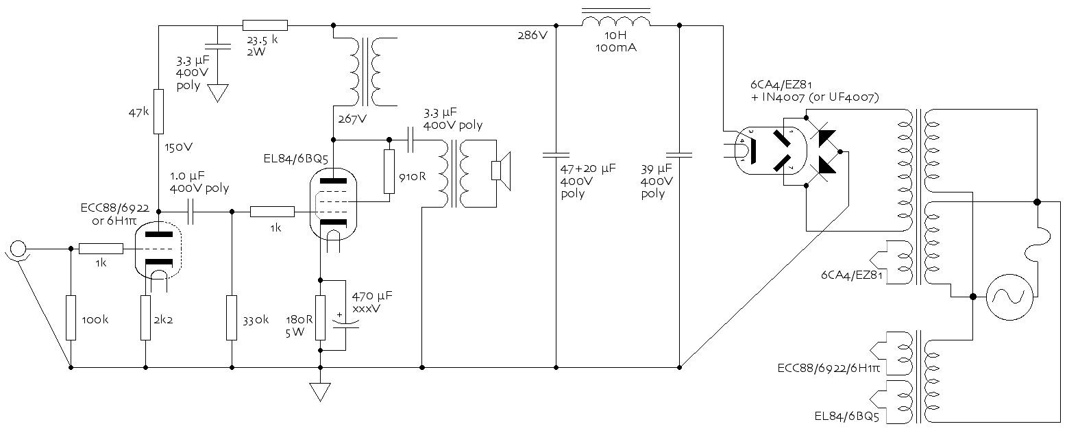

Here is the map for one of the varitions of a friend's parafeed EL84 amp to give you a start
dave
