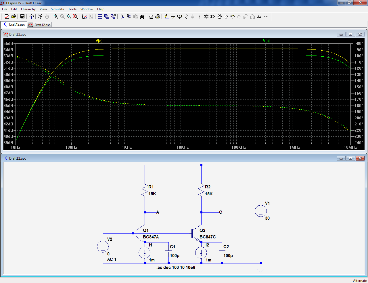

Ok, I can understand the possibility that if there are two parts (A vs. B) and A has hFE varying from 50-200 whereas B has 40-60, then B could be preferable since it may yield better linearity.
I don't get why lower hFE would lead to higher voltage gain?

I think hes saying that graded devices have many other parameters that are affected by semi processes and its a bit simplistic picking one parameter like current gain when you might interested in Vceo which might be in reality inversely related.
At my present level of understanding, I've derived the small signal T model. My implementation has a collector current source: ic=gm*vbe, with gm=Vt/Ic. The intrinsic emitter resistance is: re=(1/gm)*hfe/(hfe+1), with hfe=hFE(Ic).
The completely linear small signal model is not helpful in understanding non-linear phenomenons, by definition.
However, even the linearized small-signal model is already sufficient to show some things, see below.
You have to remember that all semiconductors parameters are correlated in some way, which is why relying on a single one such as β can be seriously misleading
