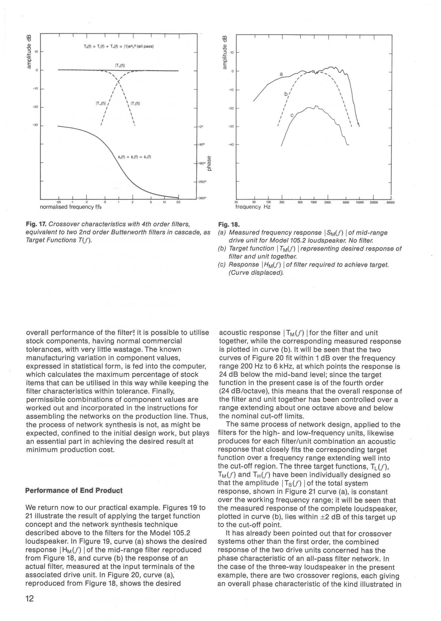

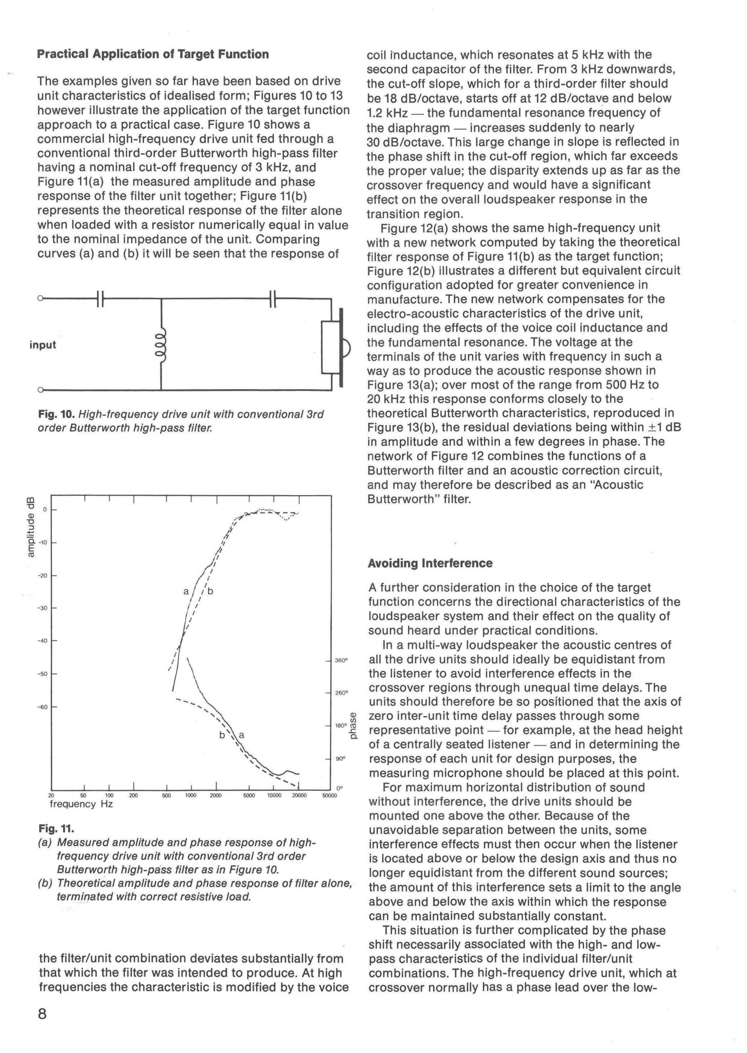

mbrennwa: KEF, as the first one the coin the term Target Response, thought otherwise.
