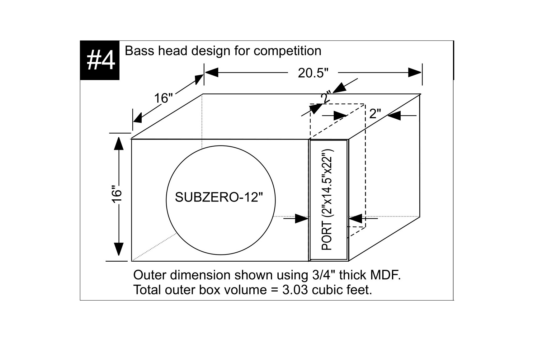

You have a plan in your data sheet.I see, so just to be clear, you're just referring to the cross section of the port?
Port is referred as 2"x14.5", what's the same as saying that the internal diameter is 13.4 mm (for a surface of 141cm²).
Distance for length of the port would be the same or 22" as in the picture below.
2in = 5.0800cm
14.5in = 36.830cm
22in = 55.880cm
