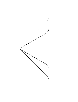

A waveguide with different angles on H&V promises to help with ceiling reflections, and even reduce baffle spacing.. but does it achieve these goals?

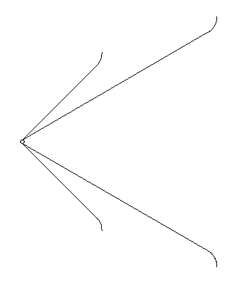

If you want to make the vertical dimension more narrow and still have it work down to the same frequency, it needs to be both taller and deeper. This trade off is the opposite of what you often see . Eg 90 x 50 ...
When the mouth is cut down to a flat face for flush mounting, the mouth becomes short and wide, and the short vertical dimension relatively loses control of the lower frequencies. This leads to raising the crossover frequency which reduces crossover wavelengths.
The effective driver spacing is increased quicker than the waveguide size, making baffle spacing greater than for a wider angle.

Example
When you need 90 horizontal and 60 vertical to the same lower frequency, they should differ as shown.. (the roundover, waveguide length and mouth size are each increased)

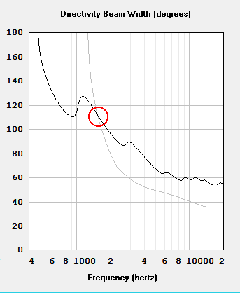

So, if you cut a 60 x 90 down flat like shown below, the crossover lower limit goes up an octave and a half compared to a regular 90 x 90 or axisymmetric waveguide..

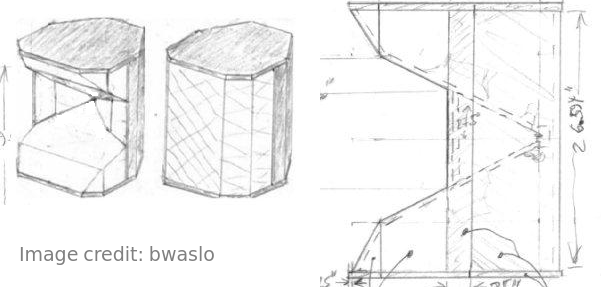

Suggestions
1. Consider a ceiling absorber, which can easily be more effective (in dB reduction) than using a full sized narrow waveguide, and the axisymmetrical waveguide will better match the driver diaphragm shape.
2. If you design a non-axisymmetric waveguide, know the angle of the ceiling reflection in your room, and try not to go needlessly narrow.
3. Close baffle spacing is not essential for a good cross. In any case it needs to be properly accounted for.
4. If a waveguide struggles controlling the lower frequencies, it may 'notice' being at the top of a baffle when the bottom has an extended baffle area below it, tilting the output.
5. Curvature (expansion) can raise the lower effective frequency compared to using a more conical waveguide of the same size (length and mouth area).
So when evaluating an existing waveguide, take note of the shortest mouth dimension because this sets the limit. Calculate or measure where the pattern 'flips', ie the frequency where the vertical has widened so much that it crosses the horizontal. Some waveguides might be ok crossed here, give or take for various reasons.

Yes, mouth height is reduced as vertical dispersion angle is reduced, while the opposite is desirable.
The horn losing vertical pattern control at low frequencies while horizontal dispersion is retained is also called 'pattern flip', as it now has a wider vertical dispersion than horizontal dispersion.

On the datasheet pattern flip happens around 1800hz, while still pretty close to horizontal pattern below that though, it is 80x60 pattern so not too bad patternflip.

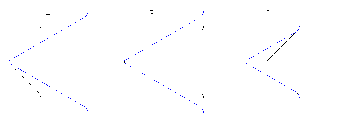

I'm still baffled why they do these asymmetric ones? I mean it could be smaller and perform pretty much the same being axisymmetric 60x60 or 80x80, altough few dB difference at off-axis. Maybe these are still made since they performed better before computer simulations allowed to optimize axisymmetric ones and are still done by tradition? I mean symmetric shape will amplify what ever issues there is (mouth reflection/diffraction). For optimized profile I see no reason to use asymmetric even in PA since it would be smaller in size and have better match to woofer at crossover. Maybe the 60 or 80 or 75 or 90 or whatever number is so important in pro audio market? It is very rare to see the speaker positioning to take advantage of the pattern they have though (i'm musician and see all kinds of small and large setups). I would like to know what is the thinkin, the advantage?
edit time over so another post: maybe the loading aspect will squeeze the last distortion free dB out of a compression driver while trying to have some horizontal dispersion for average audience size/venue? The XT1086 has even a small diffraction slot trying to widen the horizontal response out of deep horn? Anyway, for home use availability is good but otherwise it is not the best option to use, axisymmetric seems more logical for audio quality.
Yes, and while bringing the mouths together it uses the extra space for loading (B), or compromised for a square mouth (C).diffraction slot trying to widen the horizontal response out of deep horn?
Great visualization, thanks! so the compromize is mainly to have some loading with some dispersion at slight quality cost due to diffraction slot (HOMs). In my view simply SPL over quality, which is opposite to what is benefitical in livingroom situation where SPL (of a horn) can be sacrificed for better quality. Ceiling reflections aside. Altough, room dimensions are often asymmetric... Pattern control down to room height would be cool?
