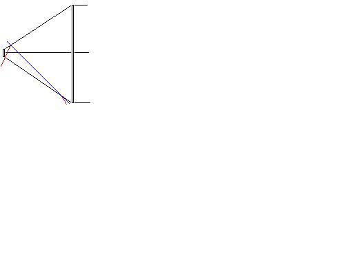

See drawing
It would be easy to fit a cold mirror in the path to a 7" LCD. It is very tight if you use a 220 mm fl lower fresnel and a 15" LCD. Look at the drawing. It is a pretty good approximation to scale, but you can draw your own to see just how tight it is. The lamp arc needs to be about 220 mm from the fresnel to get parallel rays heading into the LCD. The panel's corners are 7.5 " or 190.5 mm from the center. So the ray going from a point source to a panel corner would be pretty close to 45 degrees.
In the attached drawing, the lamp arc is at the left, the lower fresnel without a cold mirror is at the right, and the rays follow the path needed by the lower fresnel to light the corners of the panel. When we add the cold mirror (blue), the visible rays (red) get reflected down to the new fresnel + LCD position. Takes a pretty big cold mirror. I think a condensor would have to be a bit closer to the lower fresnel, so that would make the mirror space even smaller.
It gets a lot easier with smaller LCD panels or a longer focal length lower fresnel.

Well its gonna depend on the size of your condenser and its hight, power ect to determine just how far we can place the light from the cold mirror, its totally doable, what ever size this measures out to be is just physics, we cant change the laws involved of size to that degree. The only thing you could do as you mentioned is using an eliptical reflectior and unfortunatley they are big bux for a dichoric one, and not so easily found.
What happends if we dont use a condenser? we have the light from the bulb scatterd all over the place, and the image will be dull as, therefore we need the condenser to collect and focus the light into a concentrated beam, so we use the most of our light and not loose it. The more light that hits that cold mirror not only will our image become brighter, but the more light we will cool.
What it basically comes down to is: you get what you pay for, how much you want to pay and what is available at the time for what tech or way you choose to use, if you cant aford or find the parts then dont do it, its that simple, or change your lcd size to acomodate the parts you can aford.

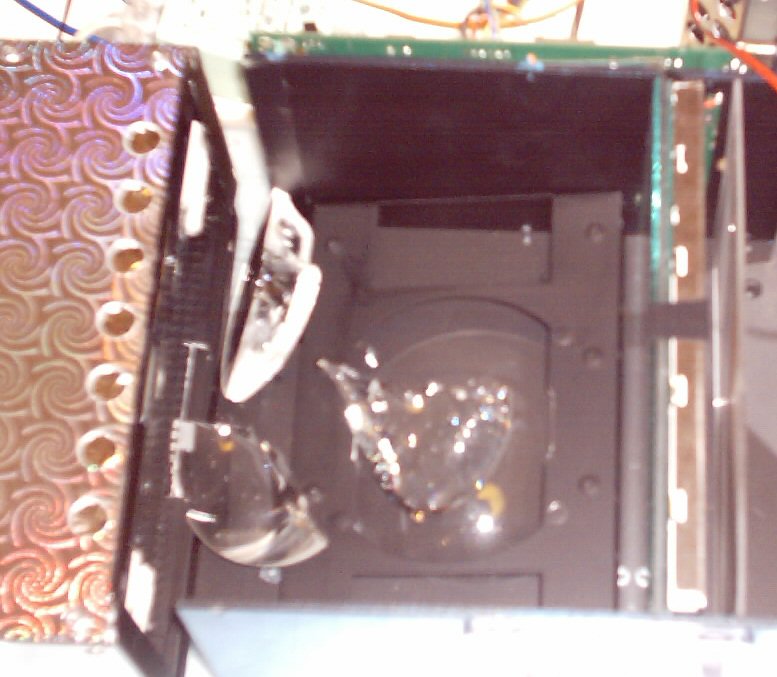

How well does your lens stand up to the heat? Or to put it another way. Would it be posible to place a 400w lamp this close to the lens?
Aslong as it can handle 300deg c no problem, so the correct glass used would be B270. If you cool the condenser its possible to run a lower grade glass, but its risky. Ive got a new condenser being custom made at the moment that will be all of my multi element light engine lenses designed into the one, the grade of glass on that will be B270, so we will see how it goes. I do have a lens here that has half the focal length of the lens that im getting made, and i tell ya, its made the 150w lamp brighter quite a fair bit then the 250w. If this is the case with the new condenser (which has even higher specs then my test lens, so it should be even brighter) i think i may stick with the 150w to save power and heat.
Hillbilly yeah thats what happends on a lower grade of glass with a lack of cooling on the condenser lol, the 250w isnt a very friendly bulb at the best of times.
