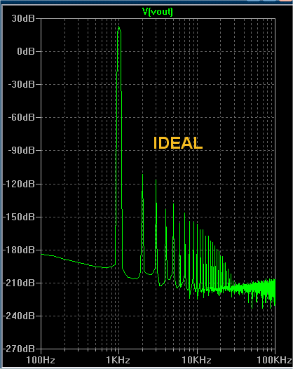

The "audio chain" starts at the studio. Boston's first album has the tape noise , Tom Sholtz's broken transistors ... so we listen to these "defects" as an artform and are amazed at the results. I have no problem with an amp that sounds "mellower" or "tubey" , but I really want to hear the recording as it was meant to be (defects and all). Any "color" , I would want to add myself (DSP/tone control) to satisfy my subjective whims. The more variables one can eliminate right up to the speakers / headphones makes for a simple means of determining the weakest link in the chain ... the amp is the easiest to eliminate objectively (crap in-crap out / strait wire with gain).
Part 2 -Reproduction of what ?? ... just as in the case of Boston or other older classic rock , we are listening to all those old 741 op-amps , tubes , and mechanical springs(defects 😀). The defects ARE the art. On some more modern recordings there are less "defects" , but as with anything human , they still exist. Since audio begins and ends with imperfect, subjective and psychological factors , the process is defective as a whole. My point was to eliminate as many of these "defects" as possible. What is objectively a defect may be an improvement subjectively.
BTW , "Tubey" .. with it's dominant 2'nd harmonic (below) , is my amplifier goal. I just feel H2 should be at -100DB or lower (tubey -"sterile"), 😀
Speakers are so much more of a factor ... which I am quickly realizing .

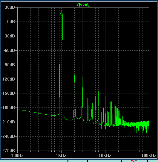

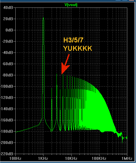

Sliding bias , Super A , TMC ... these are real,more than fancy "jewerly" on an AB output stage. These effects are quite objective (measurable ,quite audible). Notable , major defects !!!
(below 1 - near perfection) can turn into a absolutely HARSH POS (below 2) ... same amp , wrong operating points. Even at lower levels , H3/5/7/9 will contribute to a IM "potpourri" of bad sound. Some design "refinements" are overstressed for marketing (Hype) , given fancy rocket science names "hyperbolic overdrive" " isolated gain cell" , all try to keep those inevitable switching distortions to a minimum.
"Teflon PCB's"?? .... makes for almost indestructable ,burnproof and high Z layouts- 20 year MTBF++. FR-4 is close. An overbuilt ANTEK 1KVA toriod http://www.antekinc.com/pdf/AN-10455.pdf for 100$ is about as "audiophile" as one would ever need to build your own $5000 monoblock. These basic considerations are 100X more important than the "jewerly". Derating by 50% will also get you 20 years +.
