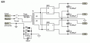

This is an extra Disconnecting Network.
The Chassis is permanently connected to PE at the Safety Earth. This must never be compromised.
Then the Main Audio (Star) Ground (MAG) is connected to chassis. This connection can be direct wire or via a big Disconnecting Network. An optional extra is a parallel switch that shorts across the Disconnecting Network. If opening/closing the switch makes no difference to the audio output then leave the switch closed. Note if the switch is left open the MAG is still connected to Chassis. This is the safe ground lifting switch.
You must never implement a ground to chassis "breaking" switch. This could kill you.
Now look at what is left, if you keep the 10r between the Signal Ground and the MAG.
If a Fault current gets onto the Signal Ground then the 10r will rupture open and anyone touching the shield or RCA could be electrocuted.
To comply with the "all exposed conductive parts must be connected to Earth" the 10r must be bypassed with something that can pass fault current. If you add the 10r as a ground loop current limiter then you must add an extra Disconnecting Network.
Why not just use a monolithic 35A Bridge Rectifier for the ground loop isolator for 2-3 bucks? Is there a point to the 10ohm resistor? Ive seen a couple of kinds of ground loop isolators, this is the first one ive seen that uses both a resistor the diodes.
The chassis is grounded So that if its gets energized It doesnt drop the next person who touches it. The ground loop isolator is to lift the signal ground above earth while not limiting current flow. For if the signal ground gets energized it doesnt drop the next person who touches it. Again in either situation the amp would run fine if it where not grounded.

The diodes offer the resistor some protection, not the other way around, as far as I understand.
The diodes pass the fault current.
The resistor makes the voltage reference.
Quite different jobs.
The resistor alone or resistor//cap can never pass fault current. To say that one has never seen diodes (along with resistor) in these locations indicates that we have Member who does not read safety advice and is a danger to anyone around who may operate his/her badly assembled mains powered equipment.
