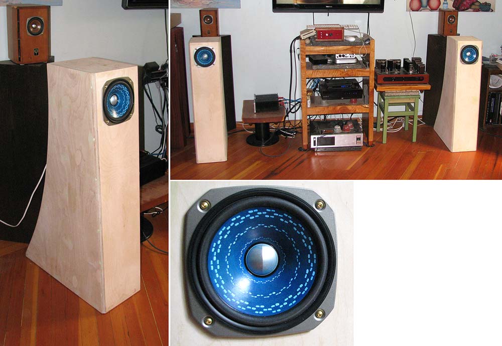

There's another enclosure for the 10s which is not discussed much here -the MarKen10 compact floorstander - actually my own "daily driver" - shown here along side the FH3 and FHXL in the background.
