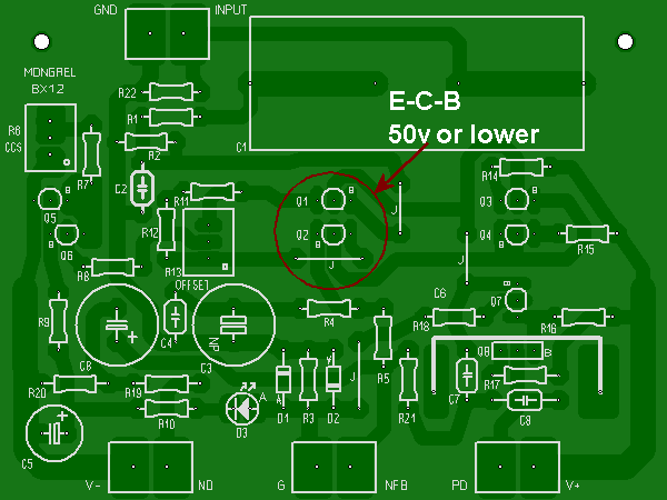

yes , ECB ... a third version of the BX 😱 , you could also use the first cascoded version (bx1.3) with the C and B crossed , C with a short piece of 1mm HS tubing. 🙂
BX 1.2 is cascode-less and also uses ECB , with 50v or less rails, the 1815 would be perfect. (below)

"1.6" ??? you mean 1.3 ?? , that is for the cascode divider. with 70V rails , it gives 20v to the LTP to allow for FET's, mpsa18's , ss9014's. with your 40v rails the BC's would work without a cascode , with lower rails R16 at 18k , as suggested , would give 14-16V. The cascode at lower violtages has benefits as well , it isolates the LTP (better PSRR).The beta enhanced VAS has such a high impedance that that the cascode's higher impedance has little or no effect. My simulations show slightly reduced THD WITH a cascode. Many low Vgs Fet's can also be used with a cascode. A cascode IS NOT GOOD on a amp like the goldmund as it has a lower impedance VAS , loading is evident !
A tip.. just remove Q3/4 , jumper the E-C's on the 1.3. I MUST use the cascode for my 75V rails , no choice except for using less than desirable high Vce 1845's (120v).
This adventure of mine is a little unnecessary as well , just for absolute OPS physical symmetry (attachment 1) , to get my BX formally cascoded , TMC'ed and with no jury rigging (as it is now). I will even use oak hardwood blocks with slots to slide and hold the voltage stage to the main current stage. I go fully split PS's this time (Vee2 /Vcc2).By MJL - Totally unnecessary but it should be fun.
To try out all these input devices / topologies would wear out any other amp on DIYA , so you were right .. I had to design it totally different .. not to impress but to actually DO IT.

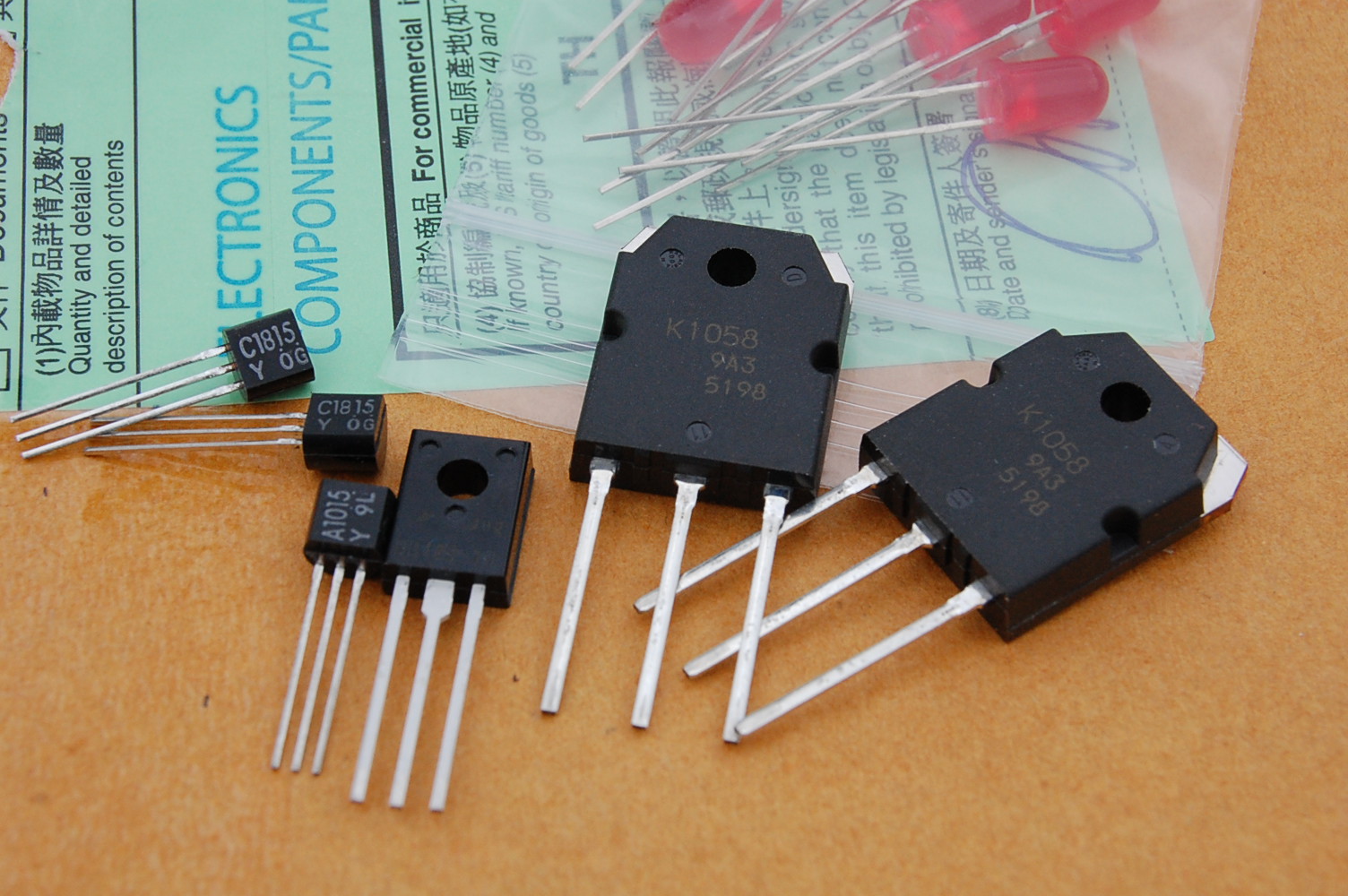

2SC1815 from Tayda
Hi all,
I finally received my Christmas present from Tayda and it took about three weeks from the day I placed the order (I actually paid for the parts).
The 2SC1815 looks like Toshiba parts & most of the other parts look good to me. I ordered some lateral-MOSFET and they look like genniue Renesas parts.
Seasons greeting to you all.
Cheers, Stanley
