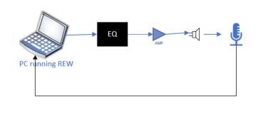

When you use a program such as REW to measure a loudspeaker and you add some frequency equalization to the test signal after it leaves your PC does the equalization show up as distortion in REW?

No, it won't show up as harmonic distortion. This is a different kind of distortion, one that shows as a response plot that isn't flat. Sometimes, EQ is all that is needed to reduce this distortion.
In an ideal world EQ is linear distortion only, non-linear distortion is not generated. In the real world...EQ as a separate piece of hardware may be DSP with ADC and DAC and sample rate conversions, or may be analog with many transistors and caps to pass the signal through. Then there's potential for clipping signal from applying boost without lowering overall gain which absolutely will show up as harmonic distortion.
In any case, if the source is a PC then there is no need to use external hardware for EQ, just use EQ APO or some other EQ software.
THD stands for total harmonic distortion, which means the generation of frequencies not in the original signal. Equalization is an amplitude adjustment of existing frequencies. This may modify the phase relationship between existing frequencies, which some people may call phase distortion, but equalization is intended to correct amplitude and phase response of speakers (etc). However just moving your head around in a live performance has similar effects so there is no such thing as "perfect" response. If you like what you hear then all is good. Don't worry about correctness.
Thanks for the responses. The distortion I'm seeing in REW is from me using too much gain in my EQ settings and causing distortion. Lowering the gain cleared up the distortion.
