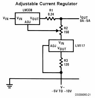

Just bringing this old thread to live as I have stumbled upon a CCS arrangement which I have not seen before, but seems to be very promising for the 'experimenters' between us. Also, it may be old news and not worth the hassle and 'forum polution' of a new thread.
I copied it from National application notes for the LM138 and the LM338. The main advantage I see is that it allows for current setting over a vaste range with the use of a simple, small wattage, potentiometer. For voltages above 5V it does not require a negative supply, so most tubes could be fed by it.
I have just one question. What happens if the wiper loses contact? I imagine the LM338 CCS would just stop passing current, right?!
Thanks for the attention.
Erik

Holy cow. I've been wanting to see a circuit like this for a while. So simple. Very nice.
An open wiper looks to me to be oscillation-friendly, and possibly might drive full output current into your load. A 10K resistor from ADJ to the bottom side of the pot would be recommended. This should effectively turn the CCS off.

Or buid it such a way so it brings up the voltage slowly (R1,C2).
Thats a nice little reg. with inexpensive components - thanks for sharing it.
I have a silly question though - is D2 supposed to be an LED or a zener?
I have built it with a zener in that position and 17V from a voltage doubler off of 6.6VAC secondaries..
It seems to work fine (I don't own a scope..), but would an LED be better?
