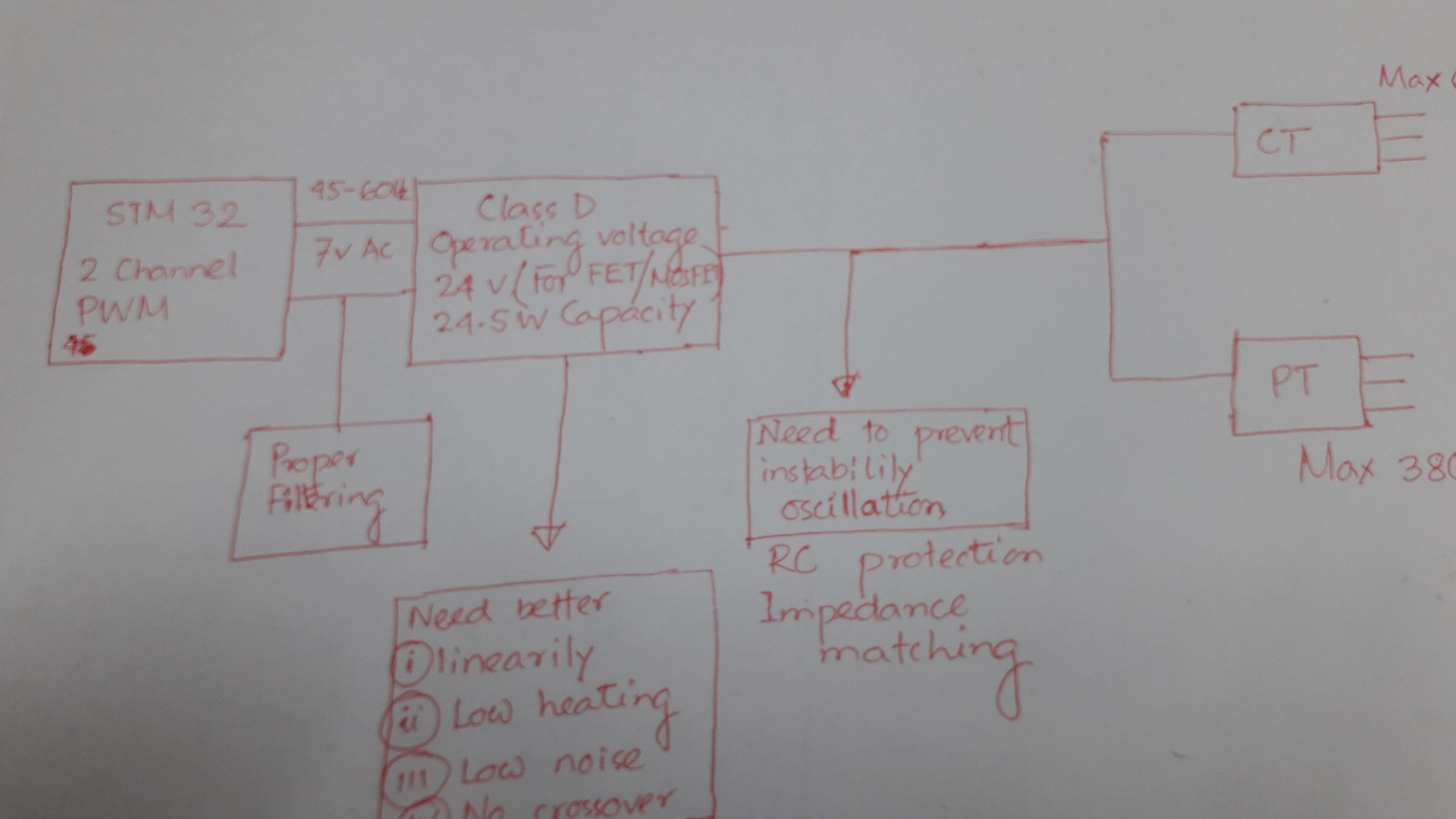

Hi , Hope this post find you well. My intention is to make an 3-phase power calibrator ! Similar to this link, Page not found My current AMP design might be class AB type. I am not worried to much about PWM generation ruther I am thinking how can I move class AB to Class D amplification.
A lot of the design effort relates to maintaining linearity and avoiding crossover distortion. 2 amplifiers( current, voltage) output will feed to CT and PT! Lets consider load will be connected in their output!
REQUIRMENTS :
1. The amp input should be plus and minus 7volt AC, 45-65Hz( 1 Hz has been converted to 1024)
2. Amp operating voltage should be more or less 24v.
3. 2 channel signal (not sure PWM) should be use , one for current, one for voltage.
4.Can run current transformer(input 16.5 V/1.5 A) and potential Transformer (input15v/2A). PT output may be 15VAC.
5. If possible both voltage and current amplification is required in one IC.
6. Both positive and negative half signal should be amplify. ( take a look bellow For CT, current transformer primary winding has 80turns, 16.5 V/1.5 A, secondary has 20Turns, 4.125v/6A output! For PT, Potential transformer, Primary has 80turns, 15v/2A rating input, secondary has centertap! At secondary 960turns, 360v/0.332 A and 960turns 180v/0.166A output.

Class D amplifiers approximate voltage sources, they won't take kindly into a CT load.
Thank you sir. Kindly give some circuit examples.🙂
How would you connect such 60Hz step up transformer ? Should it be H-bridge or BTL !! LC filter is visible here! in my case the primary side impedance is 0.00117ohm. People says , Audio amp can usable for 2- 16ohm load! While it was connected to Class AB output , a 10 ohm along with 0.33uF in series RC filter was connected parallay to primary. Looking at the datasheet "PWM frame rate selectable for AM interference is in kHz range " Does it compatible ?

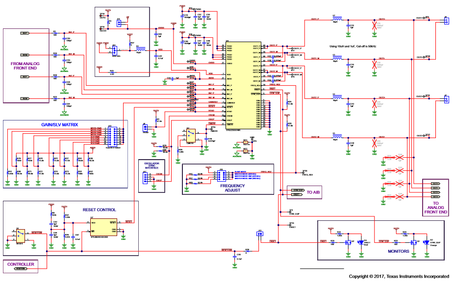

Librairie "TEXAS INSTRUMENTS - UNITRODE" et "Notes d'applications diverses", octobre 2013.
Download anything to do with the UCX637 DC motor controller. In particular this one.
https://www.thierry-lequeu.fr/data/SLUA137.pdf
Your CT/PT becomes the motor. Include an inductor in the primary circuit. Use current mode control. If you don't get it don't ask.

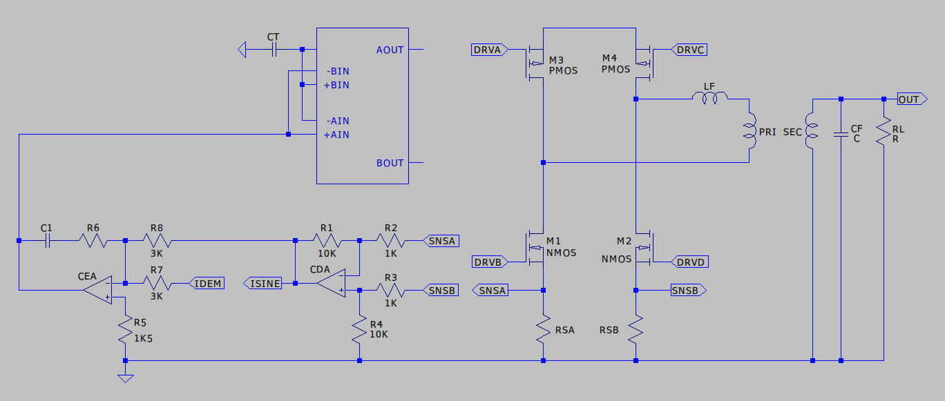

Conceptually something like the picture. CDA, a differential amplifier, reconstructs the sinusoidal bridge current from RSA and RSB. The Current error amplifier, CEA, takes the ISENSE feedback signal and compares it to the, sinusoidal current, demand signal driving the PWM comparators in the 3637.
C1 and R6 values are selected to achieve slope matching. You'll have to do a search on that subject. It sets the maximum gain in the CEA, R6/R8 in addition to that via the sense resistors and differential amplifier, and you place the C1/R6 zero at half the crossover frequency.
Very impressive ! Bridge type need to think!
I was messing around for a solution.
Looking at your circuit and reference, I can guess that why my Class AB had "voltage or current booster".
For the time being lets discuss issues like,

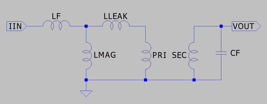

Picture of ideal transformer with input filter inductor, LF, and output filter capacitor, CF. You will be driving the transformer with what is effectively a current source. That is the LF inductor current as controlled by the 3637. It's a handy IC to get the job done. Oh it also has a current limit function.
You saturate the transformer, LMAG, if you apply too high a DC current in the primary. Let's say you use 100mR current sense resistors.
http://www.ti.com/lit/ds/symlink/lm324-n.pdf
Input Offset Voltage is specified as 2mV, 3mV max. That equates to a possible 30mA DC bias in the transformer. Input Offset Current is specified as 5nA, 30nA max. That's 30uV across 1K or 300uA in the transformer. Neither of those will be the end of the world. Otherwise you can more or less ignore LMAG because it will be big compared to LF.
LLEAK appears in series with LF so it actually helps but it will be small compared to LF. Current in LLEAK will be the same as that in LF and you are controlling that current so again you really do not care.
Basically the transformer disappears in the current loop. The inductor disappears in the current loop as well. You end up with a current source driving the output filter capacitor, CF, and the load. The voltage response is first order and easy to compensate.

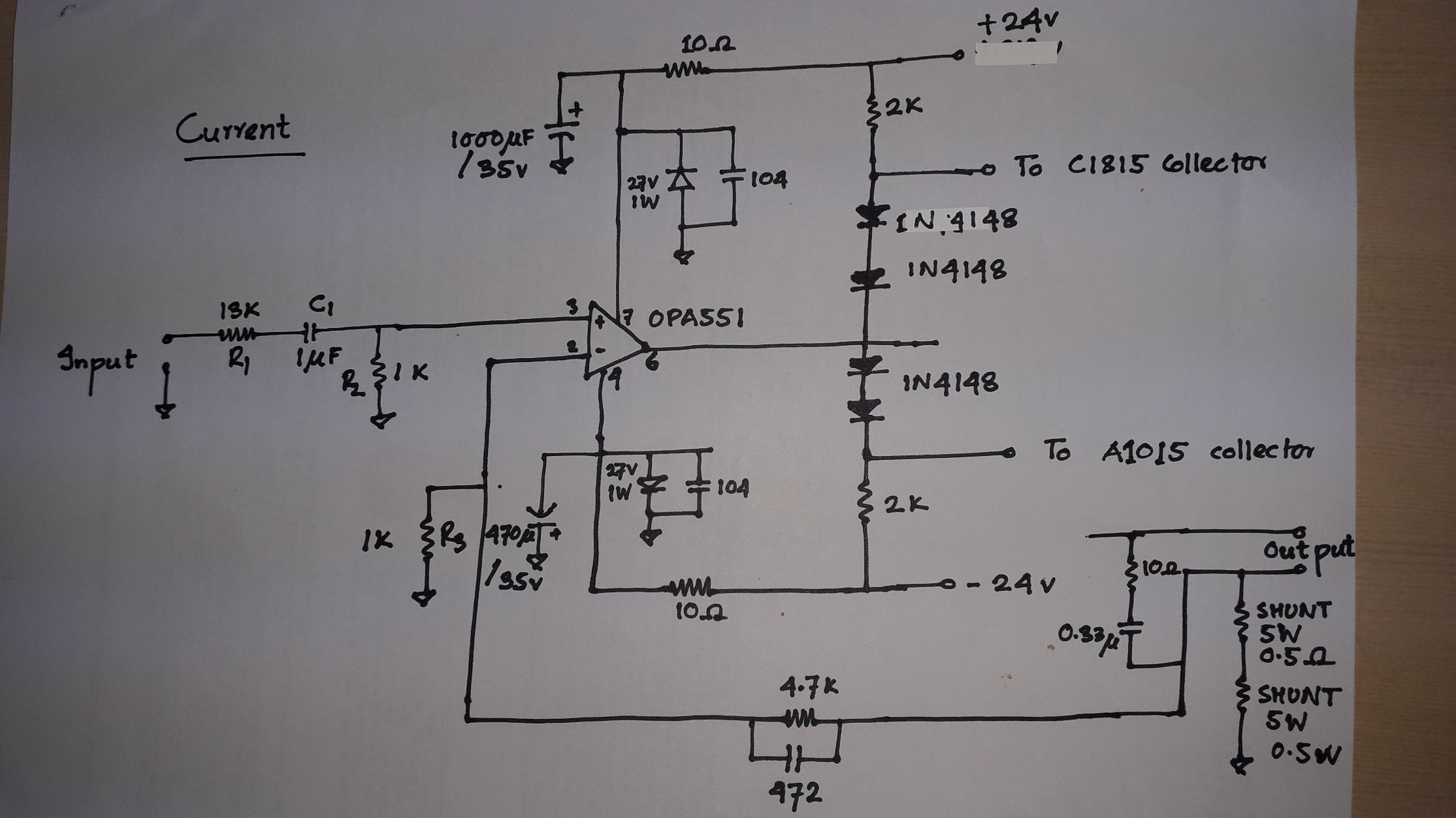

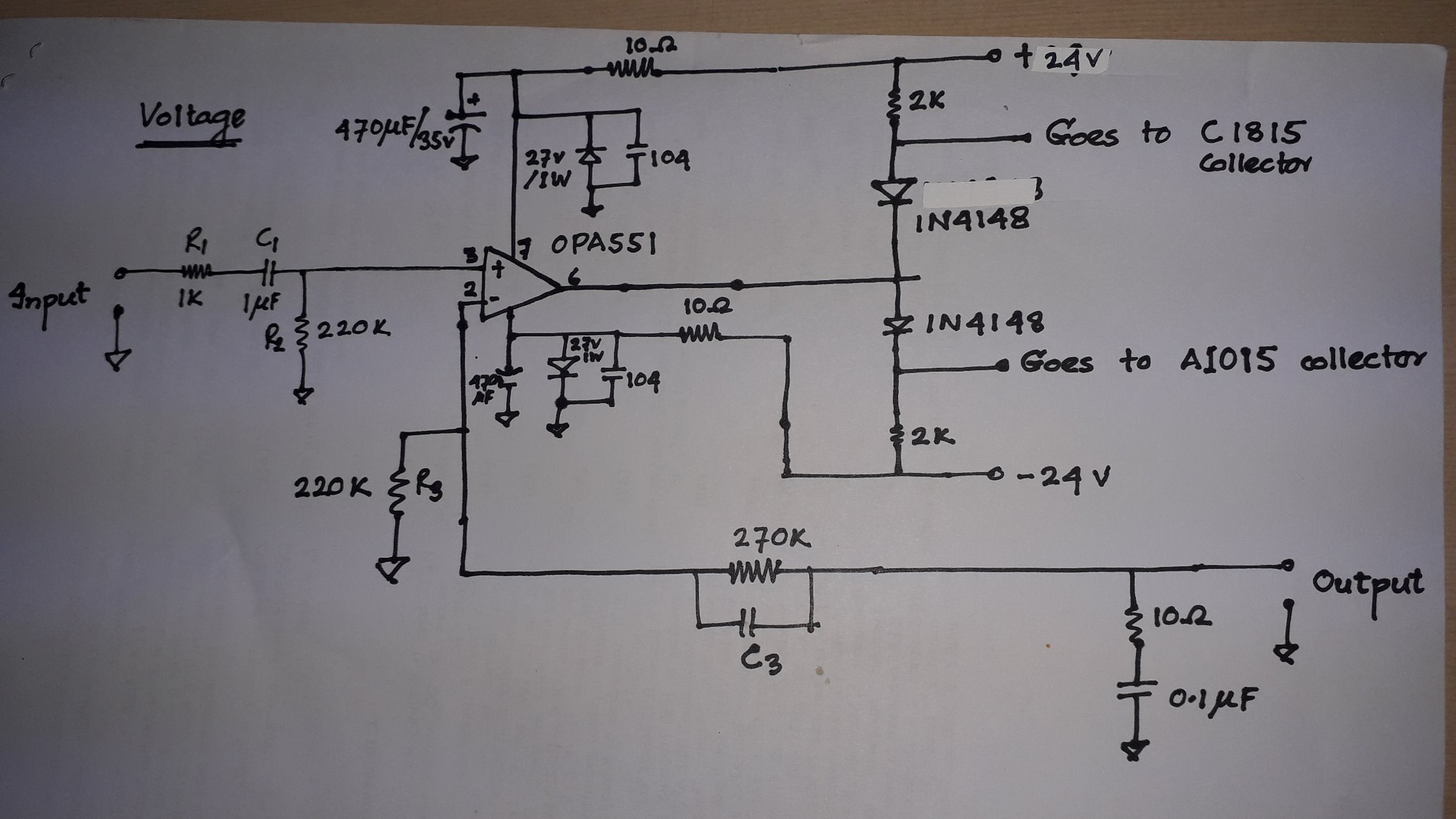

My present Class AB works well, but generating huge heat! People say it may cause "crossover distorsion" Its feedback opamp is 551, input series RC element is 13k, 1uF. Feedback parallel element may be 4.7 k, .33uF. Output has .33u and 10ohm series RC.
I am using TIP147, TIP142, C1815, A1015. They are properly biasd like cascaed 3 stage, may be AB class network. More symmetric way, like one pairs AB class output is connected to others pair. Last pairs base is connected to first pairs base! At last a voltage divider of 5 ohm has been made between 2nd and 3rd outputs!
1. My voltage and current amp circuit is slightly different.
2. In voltage amp, at OPA551, input signal is feed with reference to " ground". A series RC element 1k, 1uF after that a 220k ( one end grounded) are connected to " non inverting" input. Also a 220k one end ground is conneted to"inverting" input. A parallel RC element 270k, 0.33uF(may be) is connected to feedback path. 10 ohm, 0.1 uF RC element in series also appears in the output of the amp! Output signal also has ground reference.
3. In current amp, at OPA551, input signal is feed with reference to " ground". A series RC element 13k, 1uF after that a 1k ( one end grounded) are connected to " non inverting" input. Also a 1k one ended gound is also conneted to "inverting" input. A parallel RC element (4.7k and 47uF) is connected to feedback path. 10 ohm, 0.1 uF RC element in series are also appears between the output of the amp! In this case 2 shunt element 5W 0.5 ohm are connected and grounded in output side. No reference ground output here!

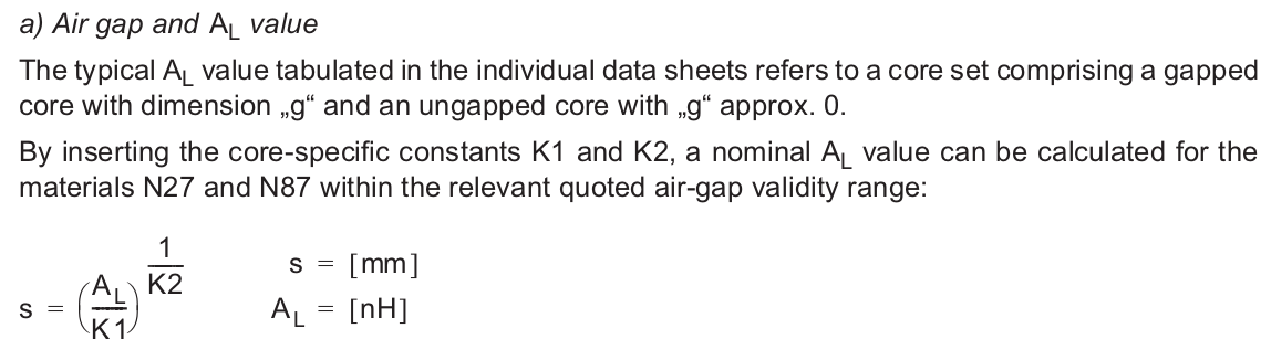

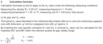

For your inductor going a bit backwards...

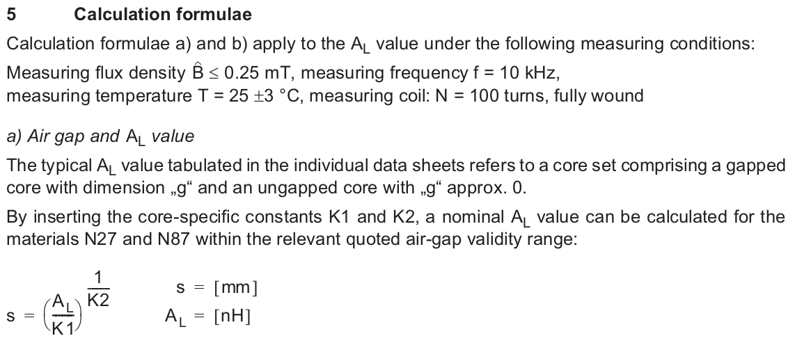

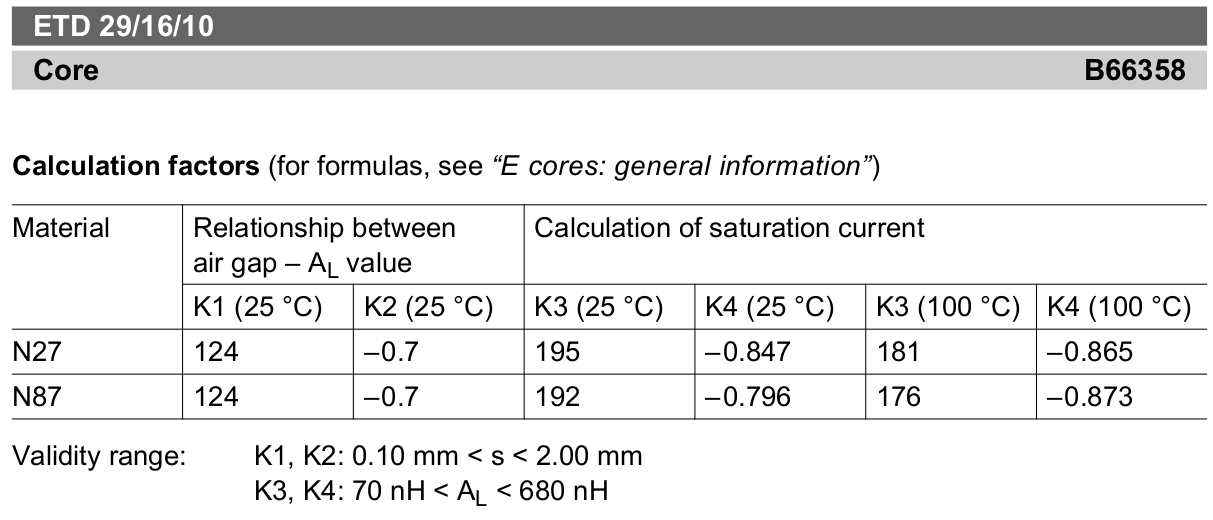

Taking your 15V/2A example. Generally you operate wire at a current density of 4A/mm^2 so for 2ARMS you need a wire area of 0.5mm^2 which is an uninsulated diameter of 0.8mm. AWG 20 has an insulated diameter of 0.876mm.
The ETD29 bobbin winding width is 19.4mm so one layer of wire gives you 22 turns. The winding height is (21.8-10.8)/2 or 5mm which gives you 5 layers. Your fully wound core ends up with 110 turns.
These things are either sold as halves or sets. A set comprises a gapped half and an ungapped half. You want two gapped halves. The largest gap is 1mm. Two of those gives you a 2mm gap but you have to calculate the resulting Al value. Pictures again.
s = (Al/K1)^(1/K2)
logs = (1/K2)log(Al/K1)
K2logs = log(Al/K1)
s^K2 = Al/K1
Al = K1s^K2
K1 =124
K2 = -0.7
S = 2mm
Al = 76.33
With 110 turns your inductance is 110^2 * 76.33E-9 or 923uH. Check for saturation value...
