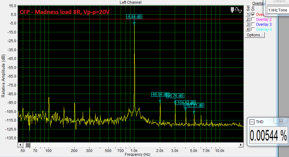

I finished 4 FFT for each
1) 3EF with 5 stages, 200mA per stage(pair) of total 1A quiescent current.
2) 4 Stages CFP with 200mA per stage.
I simulated 1KHz in 7Vpeak output and 30V peak output. FFT setting is 50mS run time ( 50cycles) and 0.005uS step.
I simulated 20KHz in 7Vpeak output and 30Vpeak output. FFT setting is 5mS run time (50cycles) and 0.0005uS step.
Attached is the asc file and the result.
The distortion is slightly lower if I use 0.12ohm emitter resistor for the power transistors, but I feel more comfortable with 0.33ohm for real life mismatch and current sharing.
From simulation, it is proven it is VERY important for the 3EF to satisfy Oliver's optimization using emitter resistor that drop 26mV with the bias current.

I just finished another set of FFT. This time is the exact same circuit but bias adjusted to 100mA per stage instead 200mA. My observation is the distortion is very similar at 1.5V input (30Vpeak output). But 3EF is much more superior with 200mA bias for 0.35Vpeak input (7Vpeak output) as it's working totally in Class A. I think 7Vpeak cover most of the regular listening level.
To my surprise, even the CFP performs better at 7Vpeak output with 200mA than 100mA. But still not coming close to 3EF 200mA at 7Vpeak output.
I think I feel good in my decision of running hot at 200mA per stage for 5 stages 3EF. I am running at +/-40V rail to keep the dissipation down to 160W of heat to get about 8W of Class A. I believe 8W is plenty for reasonable listening level.
I did optimized the CFP before doing the simulation. If anyone have suggestion to improve the CFP from my schematic, I am all ears. I am having the OPS as separate board, it only cost me $106 for a run of 10 for 2mm thickness. If I am willing to go down to 1.6mm, it's only $67 for 10.
