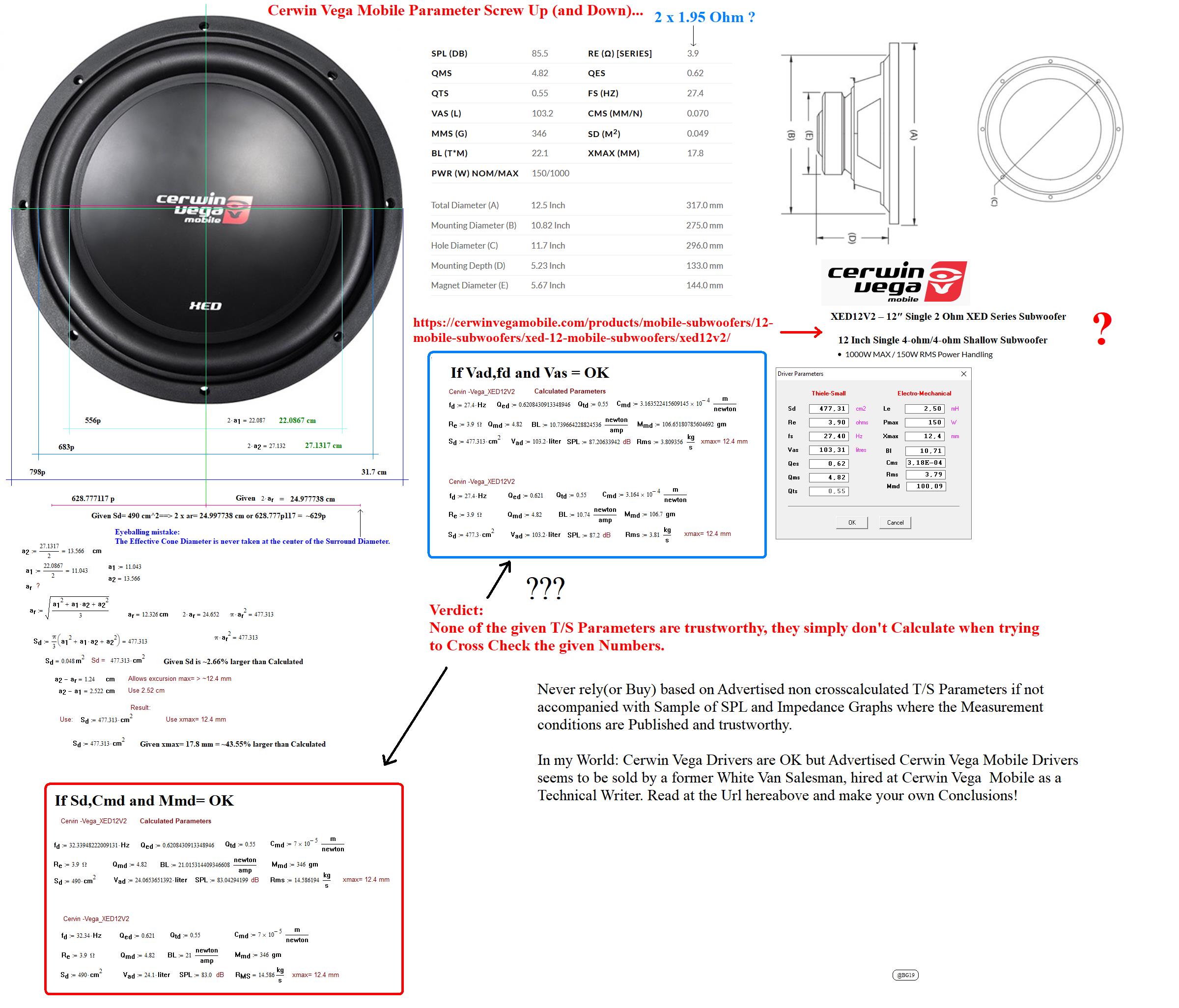

Poking around at 12" and 15" woofer specs, Cerwin Vega has a couple of models that report unusually high xmax for their price. For example, the XED12 for $60 is stated as having 17.8mm, and the V15DV2 which can be found for around $175 has 24mm. Is this even half way realistic?
Since WHEN is *price* a Thiele Small Parameter?Poking around at 12" and 15" woofer specs, Cerwin Vega has a couple of models that report unusually high xmax for their price. For example, the XED12 for $60 is stated as having 17.8mm, and the V15DV2 which can be found for around $175 has 24mm. Is this even half way realistic?

I would say no at first guess. Xmax is a number defined by geometry:
Driver TS Parameters: Xmax >> speakerwizard.co.uk
so looking at pictures of the XED12 you can see its top plate is only a few mm thick which means to have 17mm of xmax almost all the voice coil would be hanging out of the magnetic field and the driver would be very inefficient and have low power handling. The low power handling would be because the top plate removes heat from the coil and most of the coil would be hanging out in free air. This is also why you shouldn't use high xmax drivers in situations where they see high power without excursion as the ends of the coil can burn.

I would say no at first guess. Xmax is a number sometimes defined by geometry:
Times are changing. Sometimes Xmax is defined by other figures of merit via large-signal analysis, aka Klippel.
I would say those are probably peak to peak values. The VMAX 12 lists 14mm of xmax which sounds perfectly reasonable for what the driver is presenting as.
It doesn't really make sense for the XED12 to have more than this but then again I could be wrong. It would also mean they are breaking the convention they use to define xmax across the website. Email them and ask.

Email them and ask.
Good idea. I will try that tomorrow.
Cone movement yes but not linear excursion. Cerwin even have their Stroker series, amongst their others, these are a different beast altogether and are clearly built for maximising travel.
These only have 16.4mm of xmax.
Now if that doesn't have 24mm of linear, one way, excursion, I'd be very surprised if the other one did.
One of their tech support representatives emailed me back and said:
"All our woofers are measured in 1 dimension. Which is the correct way to measure XMax".

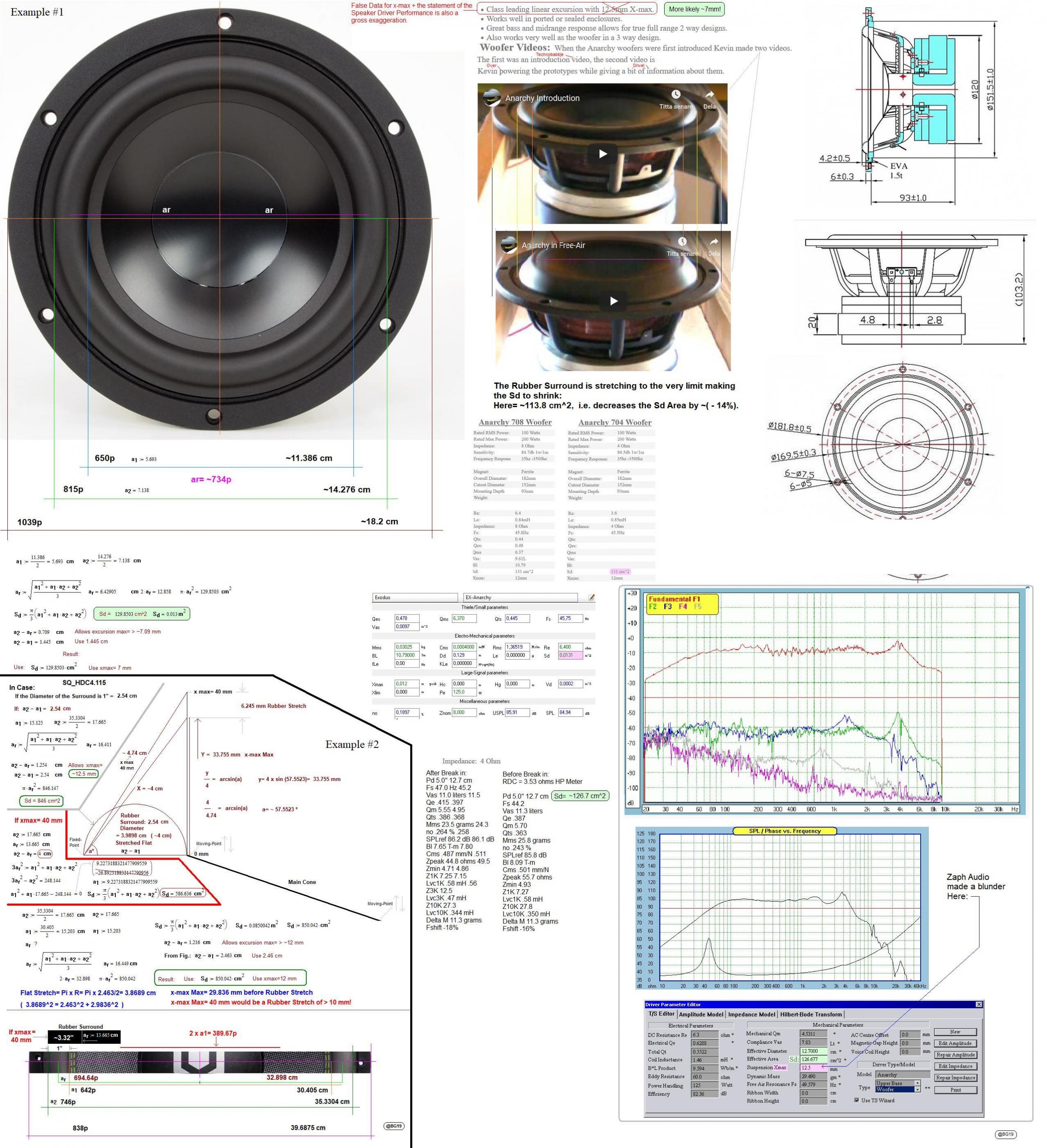

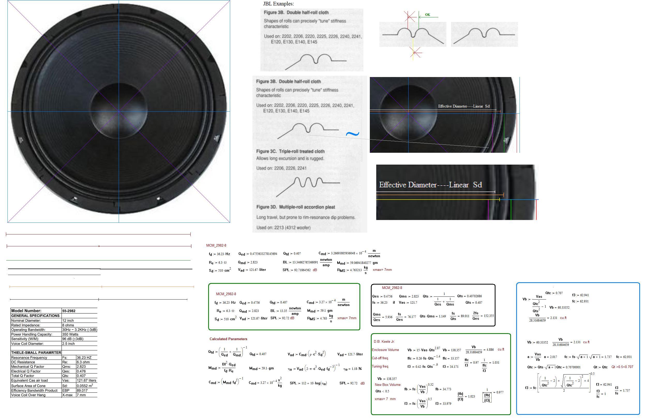

So your estimating the maximum excursion using the maximum amount the half roll surround can move back and forth?
*the Pyle drivers 15" I tested had every t/s spec wrong apart from xmax but they where only claiming 8mm I would seriously recommend the optical sensor method that I used and linked in as they are very cheap sensors. You could even use a PC sound card to record the sensor signal if you didn't have a scope .
Examples of Scrutinizing of ex-aggregated Advertised x-max and Sd Parameters by estim
No, that's what the Advertised Sd implied when Mapping on the Posted Driver Picture, x-max is Cone Excursion Max and x-max is in Reality always < as the Cone Excursion Max is the limit where above stretching and shrinking(Sd) effects occur.
The Advertised Pictures are often somewhat skewed: Often resulting in less than 1% error that can be ignored.
I vote for simple Distortion Measurement to set the Limit( Fidelity Experience) for usable Driver Cone Displacement ~1 % for a Mid-bass at 100Hz and as low as possible above or Max.<= ~10 % for a Sub at f-3dB, lower at the upper cut-off, all within the System Pass-band.
b
PS:Submitted Pictures
Examples:
Estimation of Rubber Surround Stretch Point or for corresponding Accordion Surround
[/QUOTE]*the Pyle drivers 15" I tested had every t/s spec wrong apart from xmax but they where only claiming 8mm I would seriously recommend the optical sensor method that I used and linked in as they are very cheap sensors. You could even use a PC sound card to record the sensor signal if you didn't have a scope .
b
Examples:
