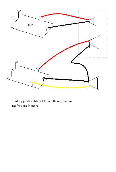

I opened the speakers up to check the internals, see attached;; now if I have to connect the amps direct to the speakers, there is a pair of my amps that has the Vellemen DC protection kit installed so I guess this should be the one to connect to the tweeter directly, and use the other pair of amps for the woofers, I am still a little uncertain of how to wire the woofers after the cross over pcb removed and replace with new cup, please advise.
Thanks,
Chris

Try to figure out if both drivers are fed by the same filter circuit [effectively connected in paralell] or by independent filter circuits
Also, in case there are independen circuits, try to find out if they are identical or use different component values and/or layouts
If there are two midwoofers, even being identical, but the enclosure is designed to place it vertically, then both drivers may not be receiving the same signal, for example, to compensate baffle step or to equalize the system in a particular way, these kind of tricks are common
Passive filters sometimes have responses more complex than expected and thus they can't be replaced with generic active filters, custom active filters based in the design of the passive ones have to be used [using the same equalizing tricks to get the same response] except when you don't like the original response of the system at all

It is the woofers connections that I am not sure, according to Eva it seems that the stock speaker is a 3 way and now if I connect the woofers to one amp, in effect I will change a 3 way to 2 way....I am just a little bit puzzled..

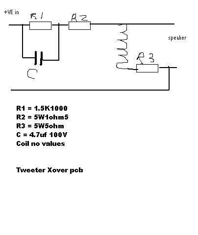

chris ma:
Could you post detailed schematics and/or pictures of those passive filters?
[Component values are useful too if available]

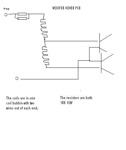

The woofers are run as a 2.5 way system so to properly multiamp you will need 6 amps or leave the bottom choke in your drawing in series with the 2nd (bottom probably) driver. 1st order XO on these. And the series Rs have to be there to change the system Q, i can't see any other reason for them.
The tweeter is a little trickier with the R shunting the series cap. And the R in series with the choke that shunts the T is giving some EQ too. Someone better versed than i in passive XOs will have to comment on what is happening.

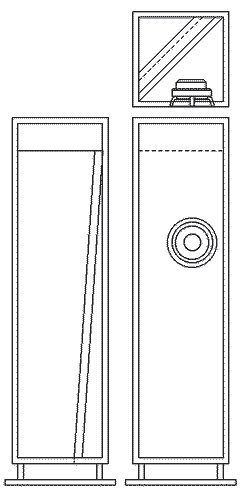

If you can do only 2-way with the JX92, add a woofer. If really wants to be the heart of a mostly FR system with a W on the bottom (<125Hz) and a T on the top (>7-10k) ... i've often recommended the Aurum Cantus ribbons as superTs, and Bob just recently made it impossible for me not to buy a pr.
If you just want to do a 2-way, the JX150 or JX125 with a JX53 makes more sense (1st order XO between 200 & 4k) Check out Rune's project at my site for a JX150/JX53 design)

Note: the JX125 TTL with full details won't fit within upload guidlines. (design inspired by Woody, done with MJKs tables and amazingly close to a KEF B200 line i designed in 1979)
The filter of the tweeter appears to work as 12dB/oct from 1800Hz to about 700Hz and 6dB/oct from 700Hz to 20Hz, then no filtering at all [but 52dB attenuation]
It also appears to be compensating for raised impedance around 1800Hz due to tweeter resonance since I had to put about 15 ohms as tweeter impedance and 1mH as inductor value to get -6dB and 90º at about 1,8kHz
R1 provides about 1dB of attenuation [providing tweeter impedance is about 7 ohms] and R3 is responsible for turning the filter from 12dB/oct into 6dB/oct
When going active you no longer need to compensate for raised impedance near Fs of the driver, and if you use a 4th order crossover, compensating for tweeter rolloff shouln't be as critical since crossover region isn't as wide
Woofer filter appears to be first order for both drivers, you can think of the coupled inductor as an alternative to two independent inductors of different value, but with lower cost, space saving and making profit of mutual coupling instead of having to avoid it placing one inductor 20-40cm away from the other
This coupled inductor provides an early rolloff for one of the drivers and crosses the other driver with the tweeter at a higher frequency, the purpose of this practice is to compensate for baffle step making the lower driver start to work when the higher driver loses the acoustical load provided by the baffle [it happens at a frequency lower than 1800Hz so just attenuating the tweeter doesn't work, it would leave the range from baffle step frequency to 1800Hz boosted]
