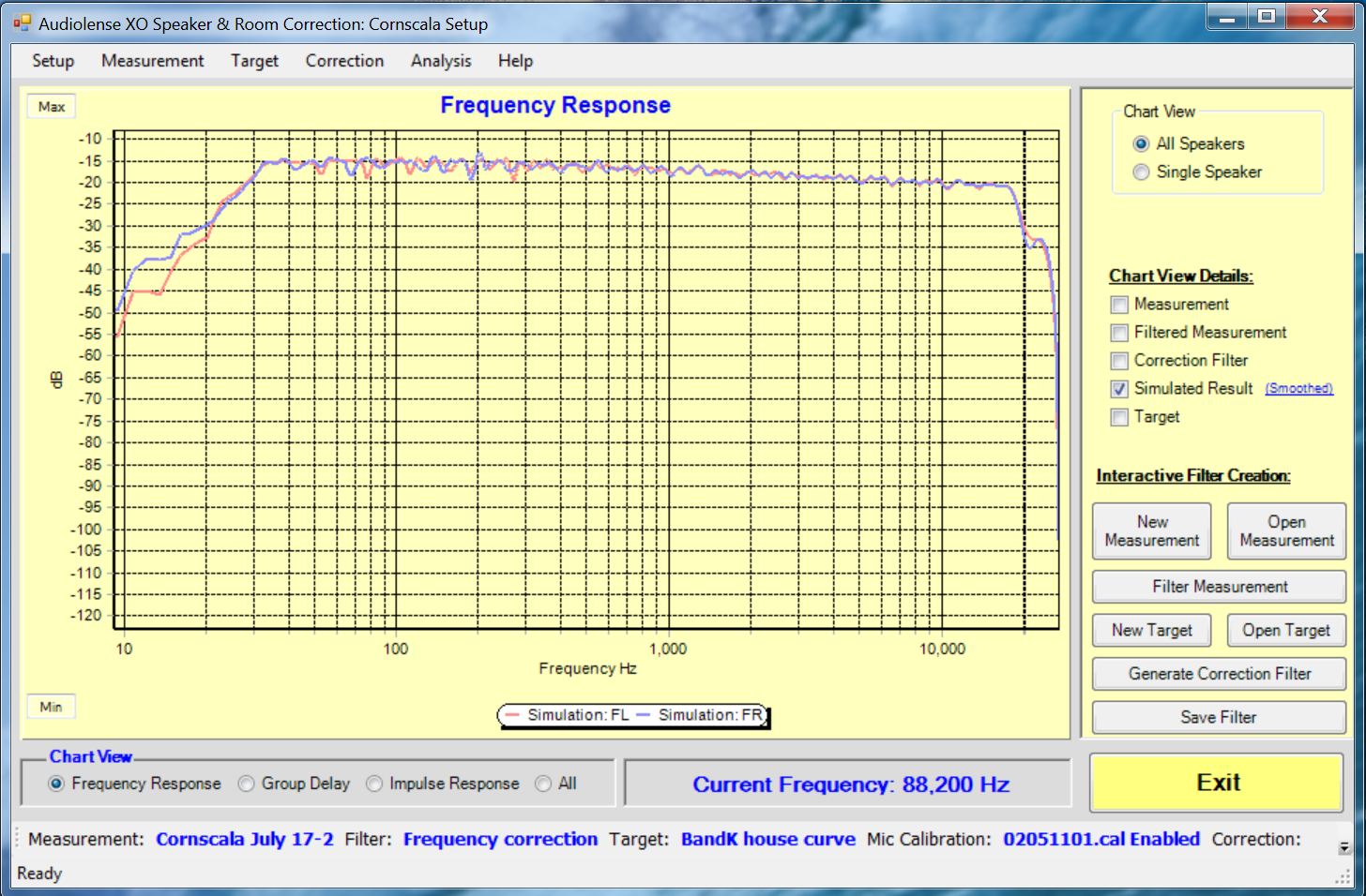

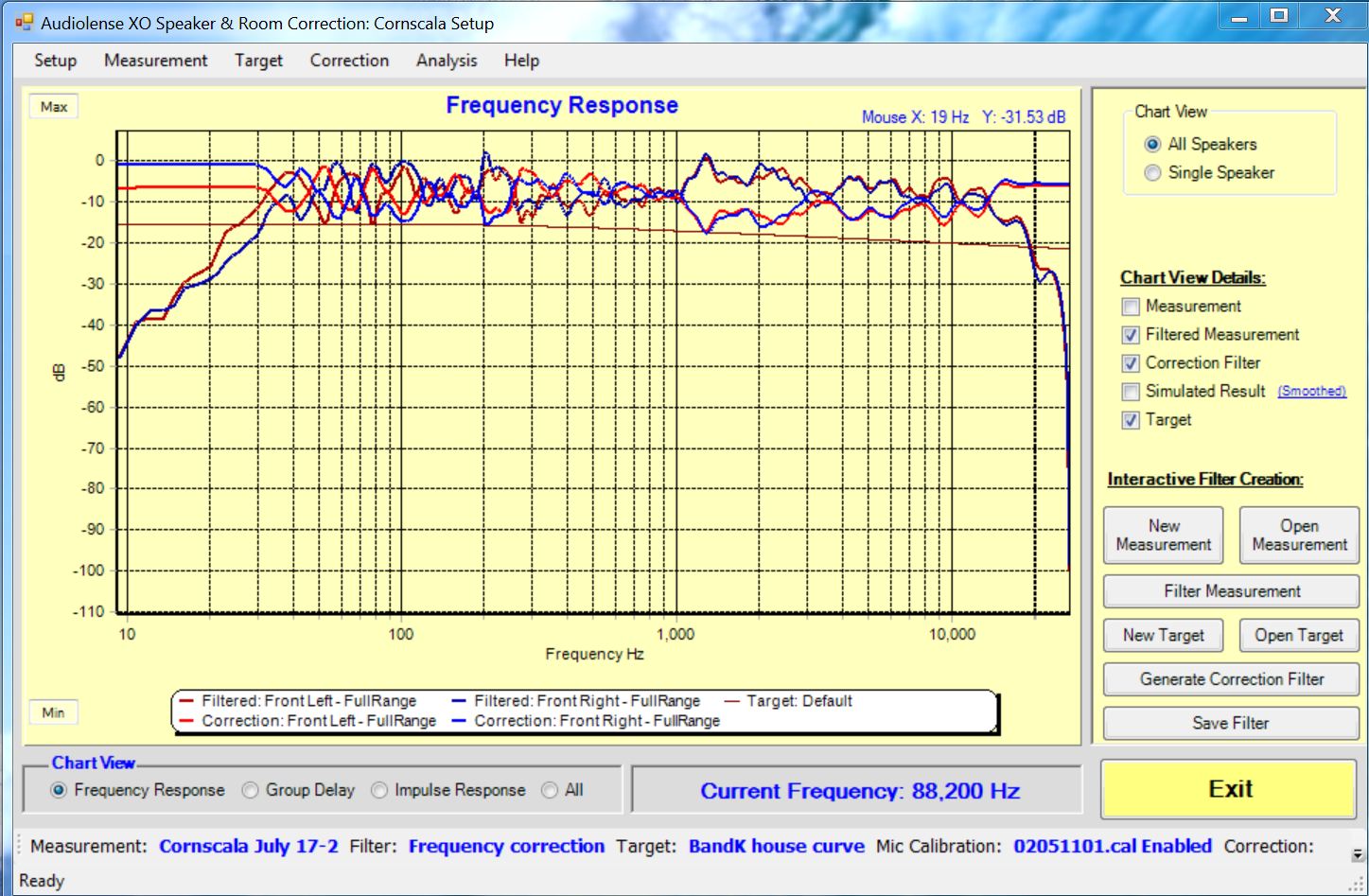

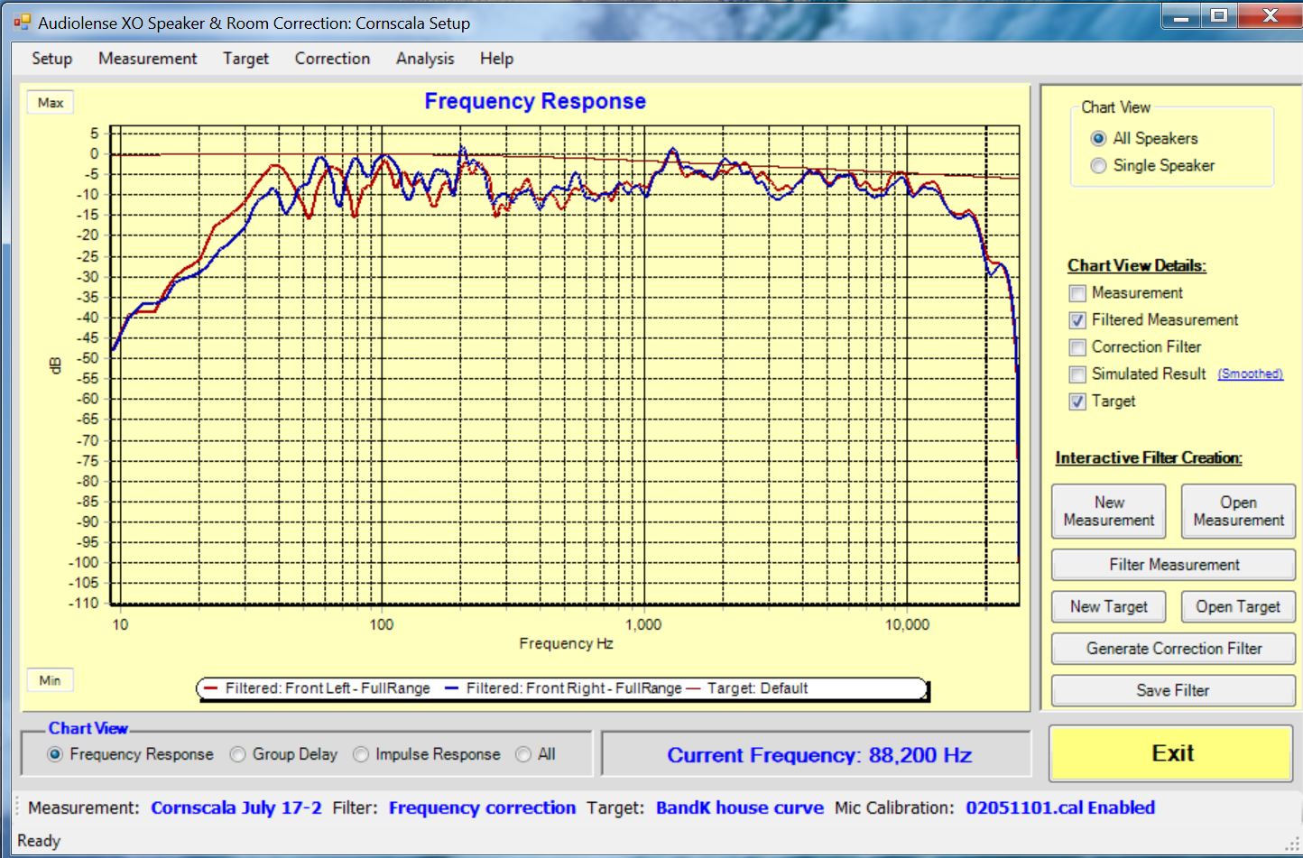

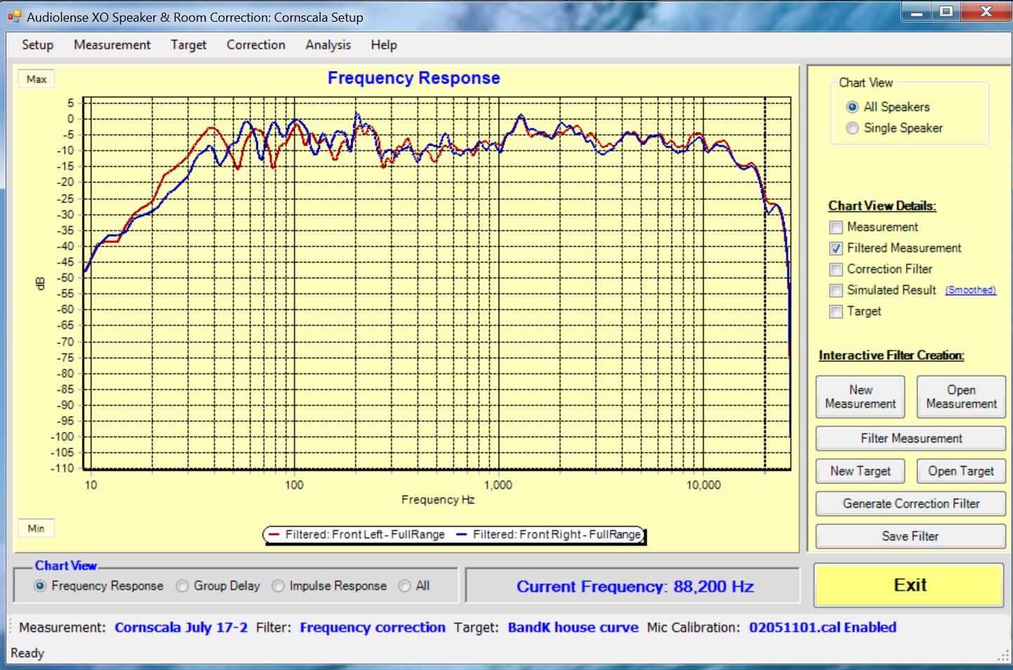

I use Audiolense with Windows 7 64bit OS. I use JRiver's Media Center software J. River Media Center software and a Convolver plug in Convolver — a convolution plug-in. This is coupled with a Lynx L22 sound card Lynx L22
The idea is that you use a calibrated measurement mic like iSEMcon GmbH and Audiolense uses a swept sine wave to output from your speakers and measures the frequency response, impulse response, etc., for your speakers and room.
Then in Audiolense, you draw a target frequency response curve as to how you want your system to sound at the listening position. As an ex recording engineer, I always gravitated to the B&K "house curve" that you can see in Figure 5 here: http://www.bksv.com/doc/17-197.pdf
Most recording studios will have at least one monitoring system equalized to this curve as it produces the most natural timbre at the mix position. It also solves the problem of engineers moving from one studio to the next and have their mix's sound the same (timbre).
Once you have drawn your target curve, you ask Audiolense to generate the filters which then plug into the Convolver VST in JRiver Media Center software.
It literally takes me 10 minutes from setting up, measuring the sound system, drawing the curve, generating the filters, plugging them in, and listening to tunes.
Attached is the raw measurement of my speakers/room combo. Then the same house curve like the B&K one above is drawn, the filters generated and then the final response at the listening position. I think the measurements speak for themselves. For me to hear the same timbre that I heard in the recording studio control room monitors on my home system is a dream come true.
The story does not end there, as Audiolense not only corrects for frequency response DRC, but also time aligns the signal at all frequencies to arrive at the listening position at the same time, has its own filter designer, and other cool capabilites, but that is another story.
Hope that helps.
Regards, Mitch

Hmmm. I think we are talking about two related, but different things. You are talking about this software: DRC: Digital Room Correction Yes? I was talking about DRC the category Digital room correction - Wikipedia, the free encyclopedia and within that category, Audiolense and how I used to for me for DRC.
Not much to explain, I followed the Audiolense manual and everything worked perfectly - like I say takes 10 minutes. There is a section in the manual about plugging in the Convolver VST and the loading the filter files into JRiver - takes 10 seconds.
