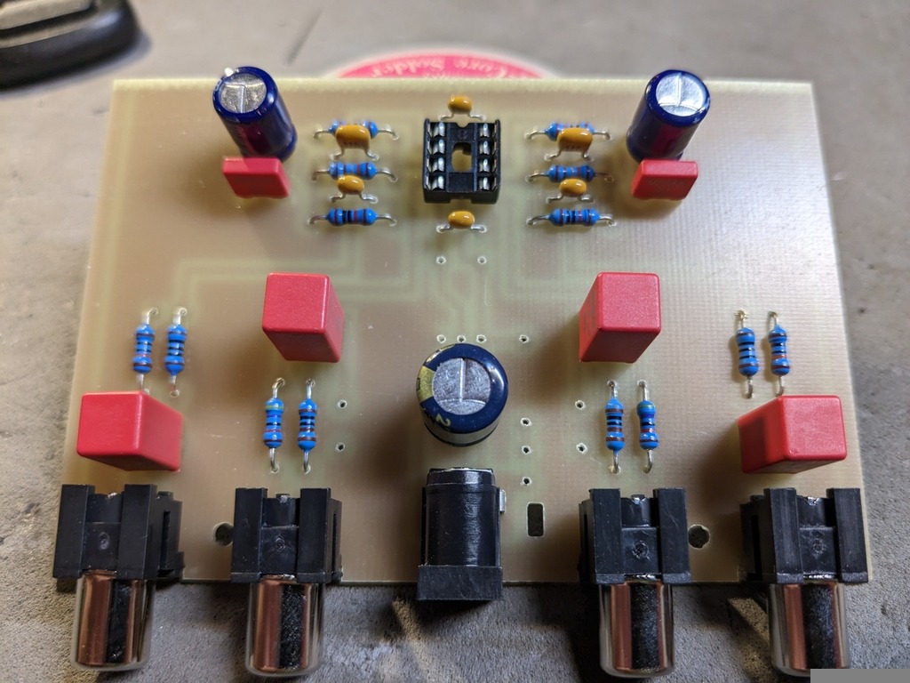

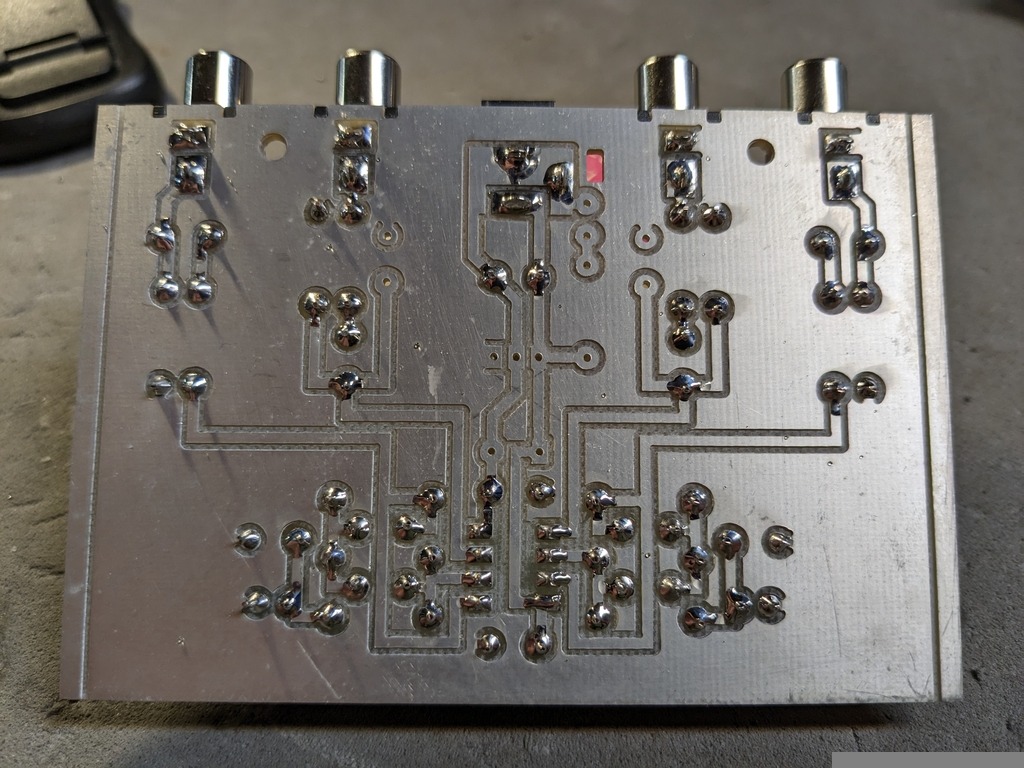

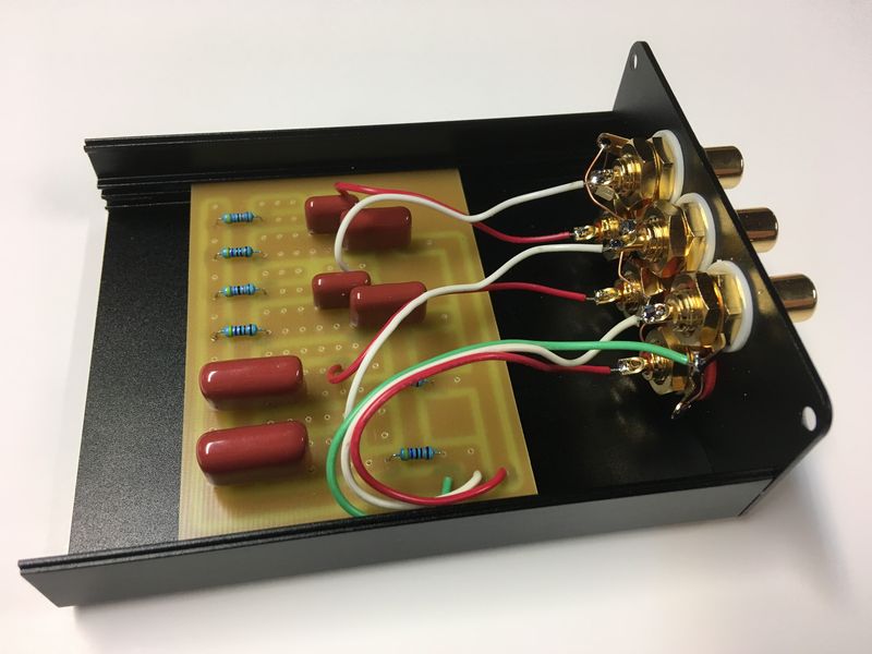

I am bi-amping using the PLLXO I built about five or so years ago.
I use two SMSL SA-160 amplifiers, each with a dedicated MEAN WELL power supply.
I'm using DIY speakers. Satellites are small boxes with Faital 3FE22 full-range drivers, woofers are a stereo pair of GRS-12SW.
Going with the PLLXO and two amps is probably would what I'd have spent on decent passive speaker-lever crossover components, and I think bi-amping is perhaps a little more fool-proof to implement (designing passive crossovers that work well/sound good can require some trial and error, and that can get sort of expensive at lower frequencies like 300-Hz).
I'm actually gearing-up to make a newer version of this with what I've learned while building my own phono preamp. I've gotten better at board design (I'm using a CNC router to make my own boards).

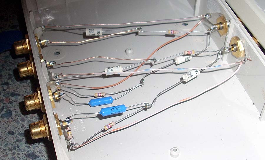

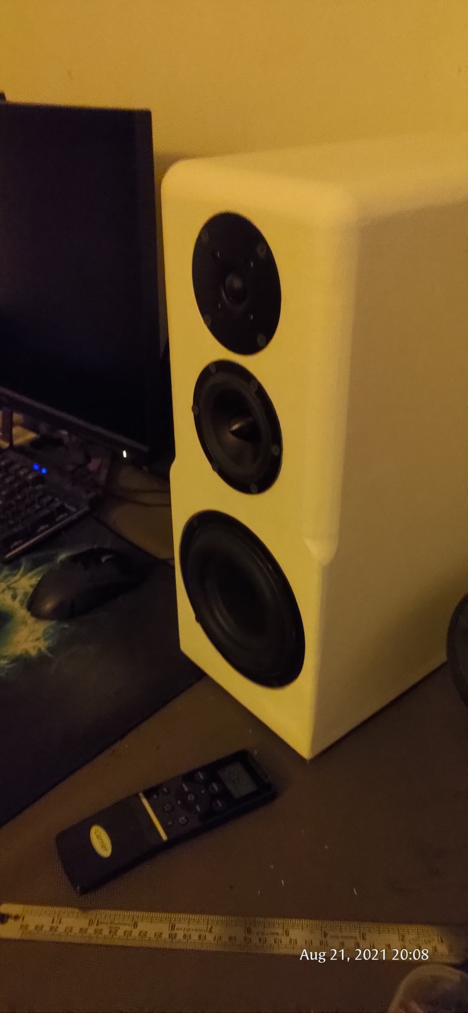

A lot more stuff in yours. This is one of mine:

1st order low pass, 2nd order high pass?
I take it the inductors are iron core and very very skinny wire?
Well I count two more resistors and a PCB for mine. But with such low parts counts to start, that may be 30% more parts. 🙂
I made a phono preamp and learned quite a bit, which I plan to apply to my next PLLXO.

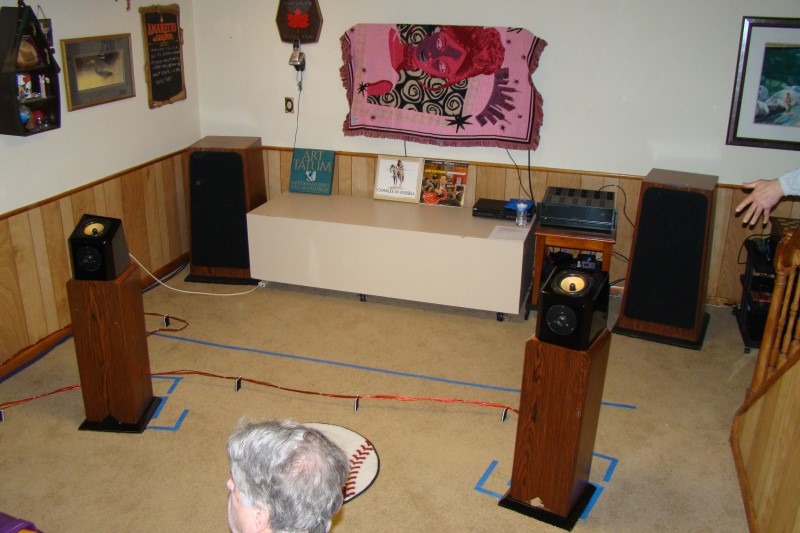

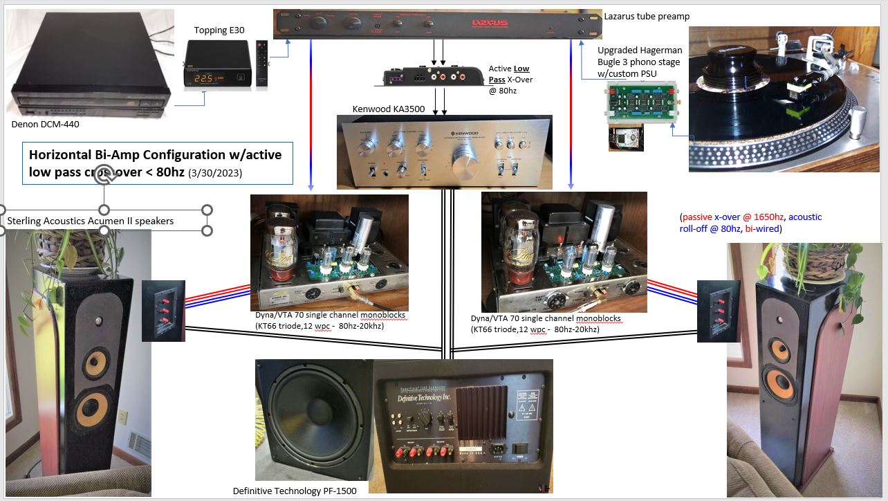

I'm using a bi-amp setup with a twin pair of Dynaco/VTA tube amps used as mono blocks on the mids/tweeters, and a Kenwood integrated amp with active crossover at 80hz and below (along with an active subwoofer). Very, very pleased with that scenario. It sounds very clear, and gives me a lot of flexibility with bass adjustments. At some point, I'd like to add a high pass filter in front of the tube amps to keep the bottom octave or two out of the input.
An excellent example of using almost anything you can grab to drive the helper woofers.

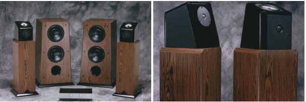

Absolutely still bi-amping. Pass Labs XP-30, to McCormack DNA-500 (woofers) and to McCormack DNA-750 monos (mids and tweeters) to Legacy Focus SE speakers. The Pass preamp is a 3 piece preamp and allows for 2 simultaneous outputs - 1 fixed volume master output and 1 variable volume slave output. So this makes it easy to adjust one of the outputs to match the other for the different amps that you might be using.
This is a great set up for me as the McCormack DNA-500 is a killer bass amp! And the McCormack DNA-750 monos were actually made by Conrad Johnson and have the super nice Conrad capacitors in them and they are perfect and smooth for the top end.

is this a passive crossover ? before the amp ?. first order?
Yes. Yes. That one was first order LP, 2nd order HP. We designed for first order HP after that one.
For stereo requires 4 small Cs and 2 Rs.
The lowest we have tried passive speaker level is 250 Hz, and parts are huge.
