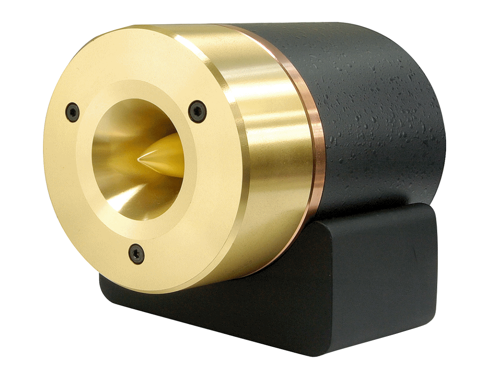

There are some high end speakers that use a super tweeter that can reach up to 50khz or even 100khz. A lot of ribbon type of tweeters can reach 30-40khz. Plasma tweeter can reach 100khz.
The Rosso Fiorentino speakers use a moral tweeter combined with a custom made super tweeter that can reach up to 50khz. These speakers cost over 10k.

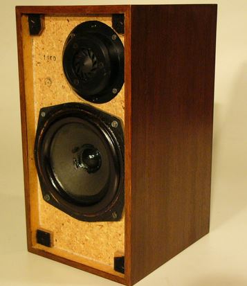

This is Celestion Ditton 10 with a mere HF1300:
This a Spendor BC1 with a supertweeter plus an HF1300:
Is there any benefit from the supertweeter, which operates above 13kHz? Now come on, you lazy students, playing with your phones at the back of the class, I want an answer! 🙂
