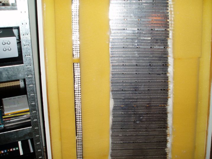

I lived with my "La Folia" without a sub for about 18 years. They gave me a lot of breathtakin' musical joy and experience, though I knew, that the bass was audible but not at the right level. Especially voices were excellent.
Now I have a "sub" ranging from about 30 Hz, and dividing electronically at 80 Hz, the major difference is more physical power and body.
It's not the fact, that I can hear the deep notes better - I'm not even sure I can - but it's different! - I feel the music more than I did before........
Well, that was not much of an answer ............
("La Folia" is a magnetostatic planar speaker) see pic.
It depends .................
