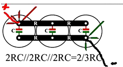

I think it is connected with wiring (and only partially - with ESR).I figured 135,000 uf was the perfect value so i took out the six caps and replaced with a single 150,000uf cap which is the closest value i could find, but some of the noise came back.
Why is that.
Six x capacitors in parallel is quite likely to have a lower ESR at ripple frequencies than a single capacitor of the same value, which may also explain the lower noise. However from a ripple perspective, 1 x 47,000uF would easilly be enough in a properly laid out circuit to prevent hum, which points to an issue with circulating currents as alluded to in my previous post.
I think two photo of the wiring have to be enough - first photo '6-caps' wiring and second photo - one cap wiring.if you put an scope on and then work backwards you should find out what components are changing the signal in what way.
