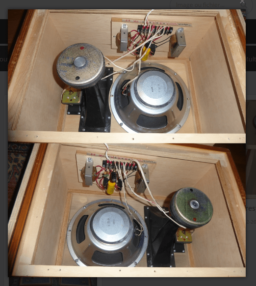

If it is really the case, then I would stay with a sealed-filled enclosure, with a QTC of 0.7 to 0.8 :
  • better step response and transient response
  • lower rolloff in the bass extension (typically 12dB/Oct 2nd order against 24dB/Oct 4th order for the BR)
  • better group delay
  • more neutrality
But it's me, OK ? 😉

Is a port useful if one doesn't need to extend response in the low range?​
  • more neutrality
But it's me, OK ? 😉
T

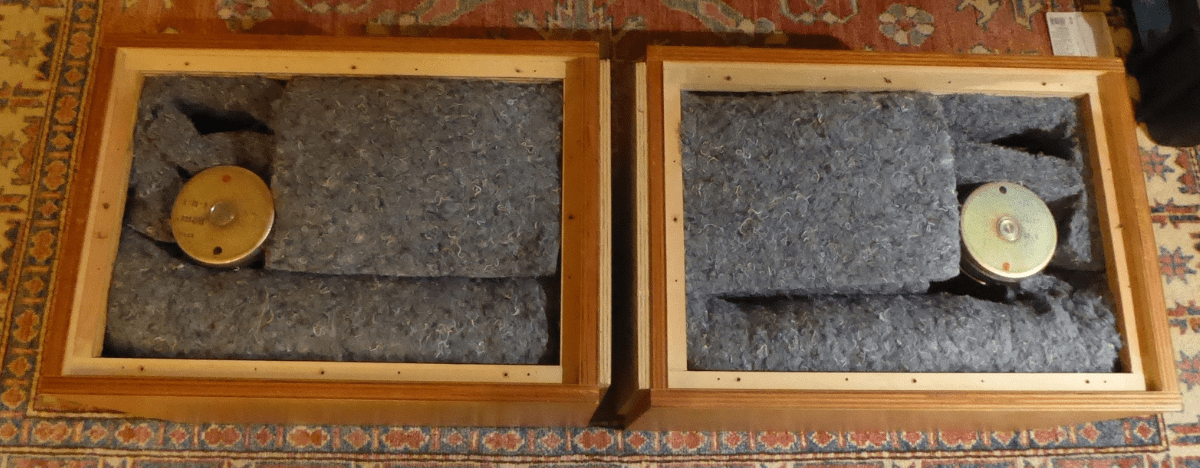

@tubelectron : what is a sealed-filled enclosure?
Aw sorry 😕 :
An empty-sealed enclosure :
A filled-sealed enclosure :

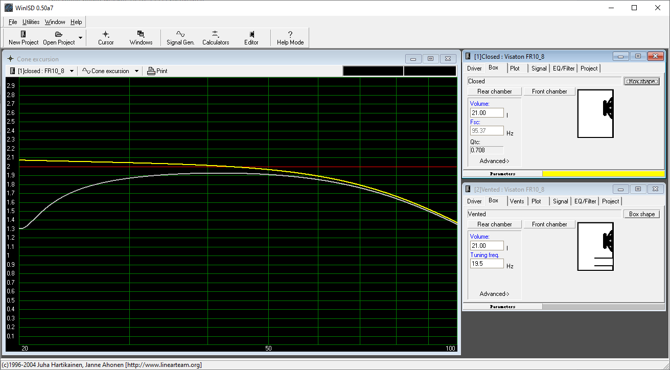

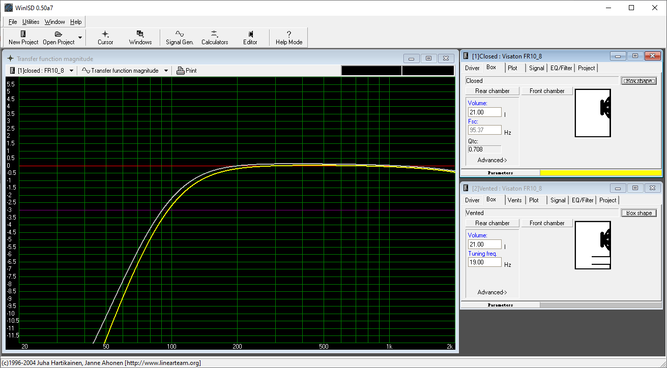

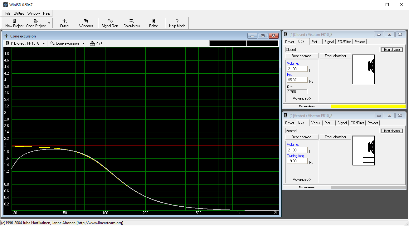

For the most part.
Unless you tune low enough it behaves
more like sealed.
Basically tune for no added bass response.
The reflex being maybe 18 to 22 Hz resonance.
Helps cone control further than sealed.
Can add far more bass with a simple shelf filter
or bass EQ. Reflex can be used for control
instead of the usual unloading.
Something simple like 4" driver
FR10-8 with .7 Qtc Sealed
Same volume ported.
tuned low around 20 Hz
not much added response
but can see reflex help reducing
cone movement.
