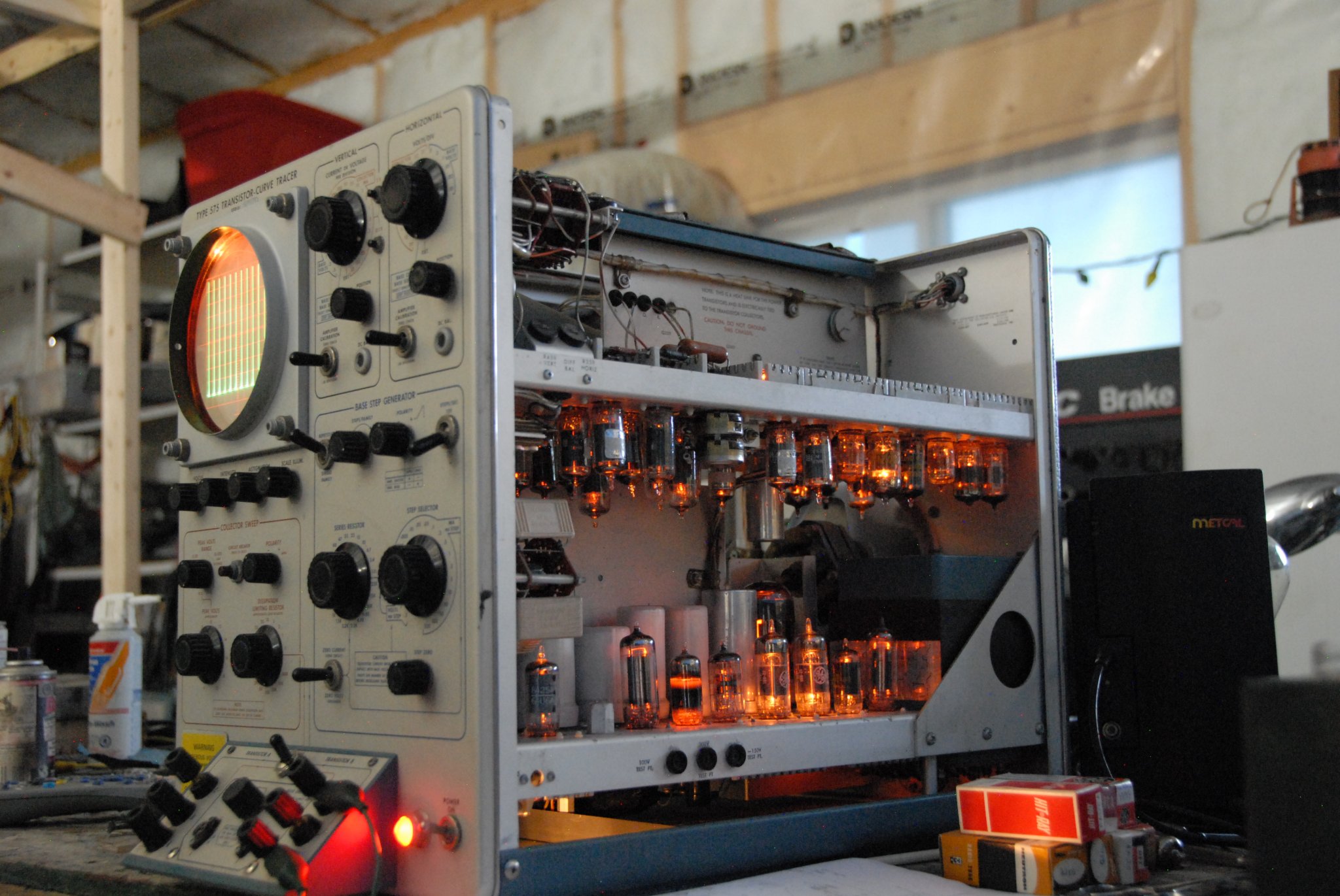

I'm getting ready to build a new workbench for the winter silly season of building madness and am in the process of digging out all of my test gear etc.. One item I restored and calibrated a few years ago is a really nice Tektronix 575 curve tracer, but it's approximately the size of a house and I would have to make a rather large space to accommodate it. I know we can static match Idss and such with a simple DVM and test jig, just wondering if a curve tracer would be of benefit for matching JFETS, MOSFETS and SITs (if I ever find any) .

Dude, that is so cool you should make room whether you use it or not. Turn it on have a cup of tea and get to work, sounds awesome.
Unfortunately I would have to run it with the covers on so as to keep my cat alive, the glowing cool factor would be lost. Maybe the cat would like to live outside this winter. 😱
Between the test gear and FW amps running, I would probably not need to light the wood stove.
Cheers

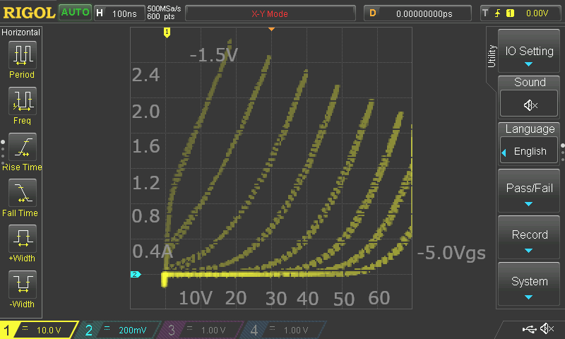

I looked into this and couldn’t find a solution that could do both tubes and SS and especially that intermediate region of 50V-150V at >1A of current. The uTracer6 gets close.
My solution is Mike’s Frankentracer. With the ubiquitous Rigol DS1054Z, you can get this type of output, which is fine for what I need but may not be enough for you:
Reactions: kilohertz
Any chance that image is for K2087?
