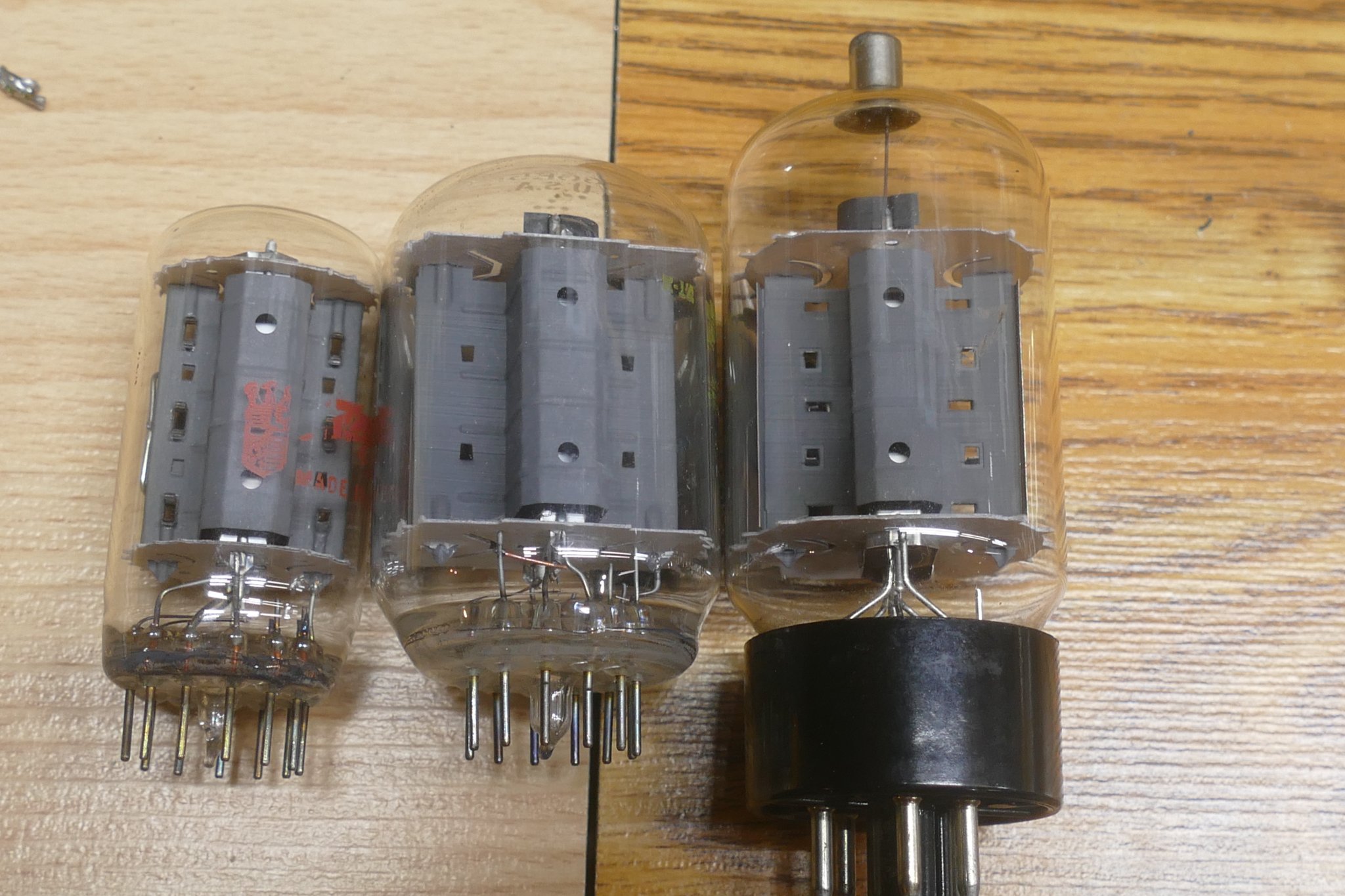

I was looking at my tube collection and checking out the the discussion about the 38he7 being able to be split into an 15Watt pentode and a diode. If the heater is wired to pin 10 and 12 the diode is left blank. The pentode goes from 10W dissipation to perhaps 15W or so. So I decided to check out the 33gy7a and found a similar thing. This time it is pin7 and pin12 to lite the pentode and I think the pentode is a 6ge5 which is a 6dq6b @ 18W. This tube may be a bit of a sleeper. More research must be done to confirm.
Interesting possibility when tube still only costs a buck or two.
Looking at the 33GY7 data sheet, it looks a little "light weight" compared to the 38HE7, which looks more like a de-rated 6GE5/6DQ6B. 38HE7 pentode curves are nicely spaced too, compared to the others.
33GY7 looks more like a 6GF7, which looks like a 6GE5 with a "cut down" plates stuck in a smaller bottle.

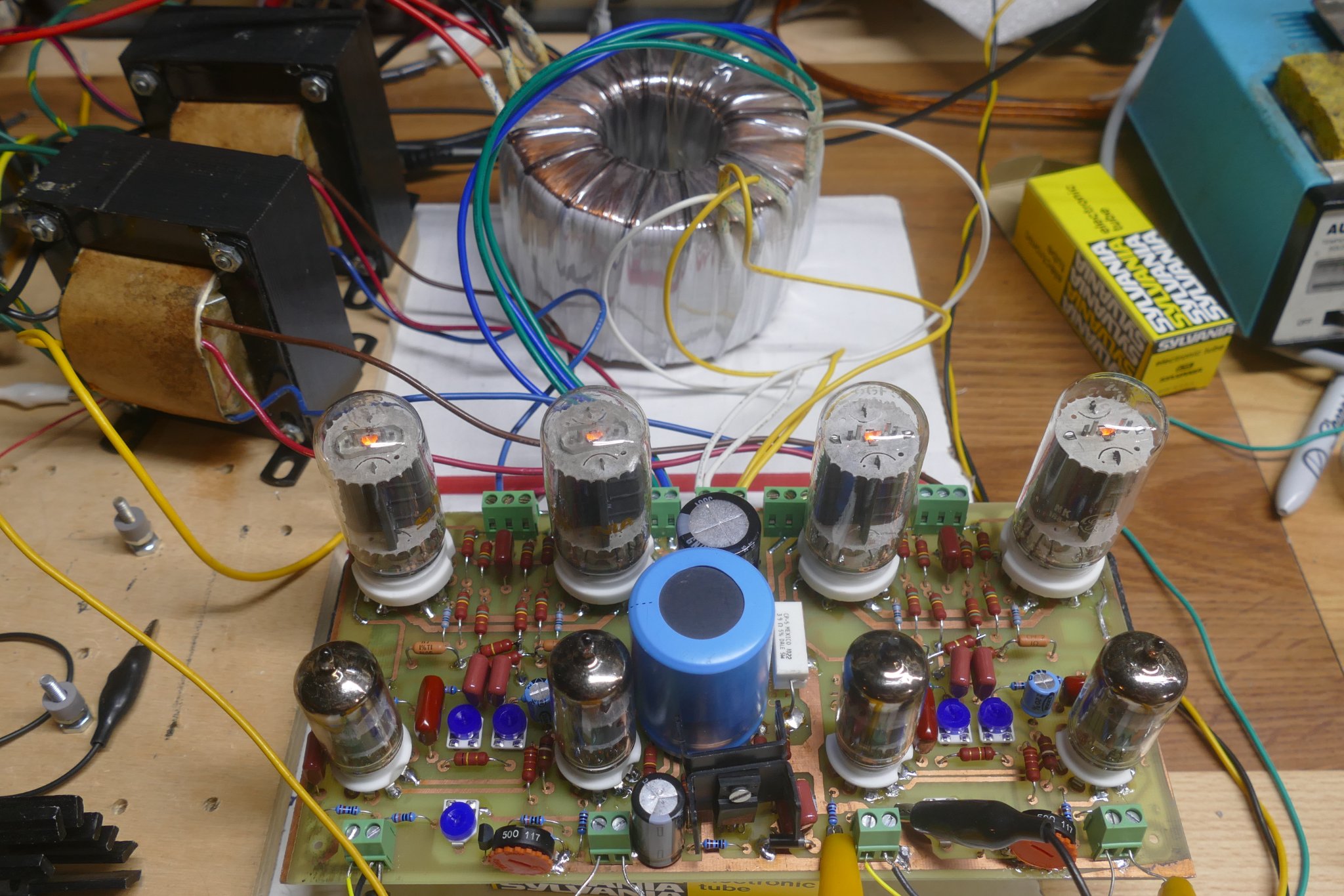

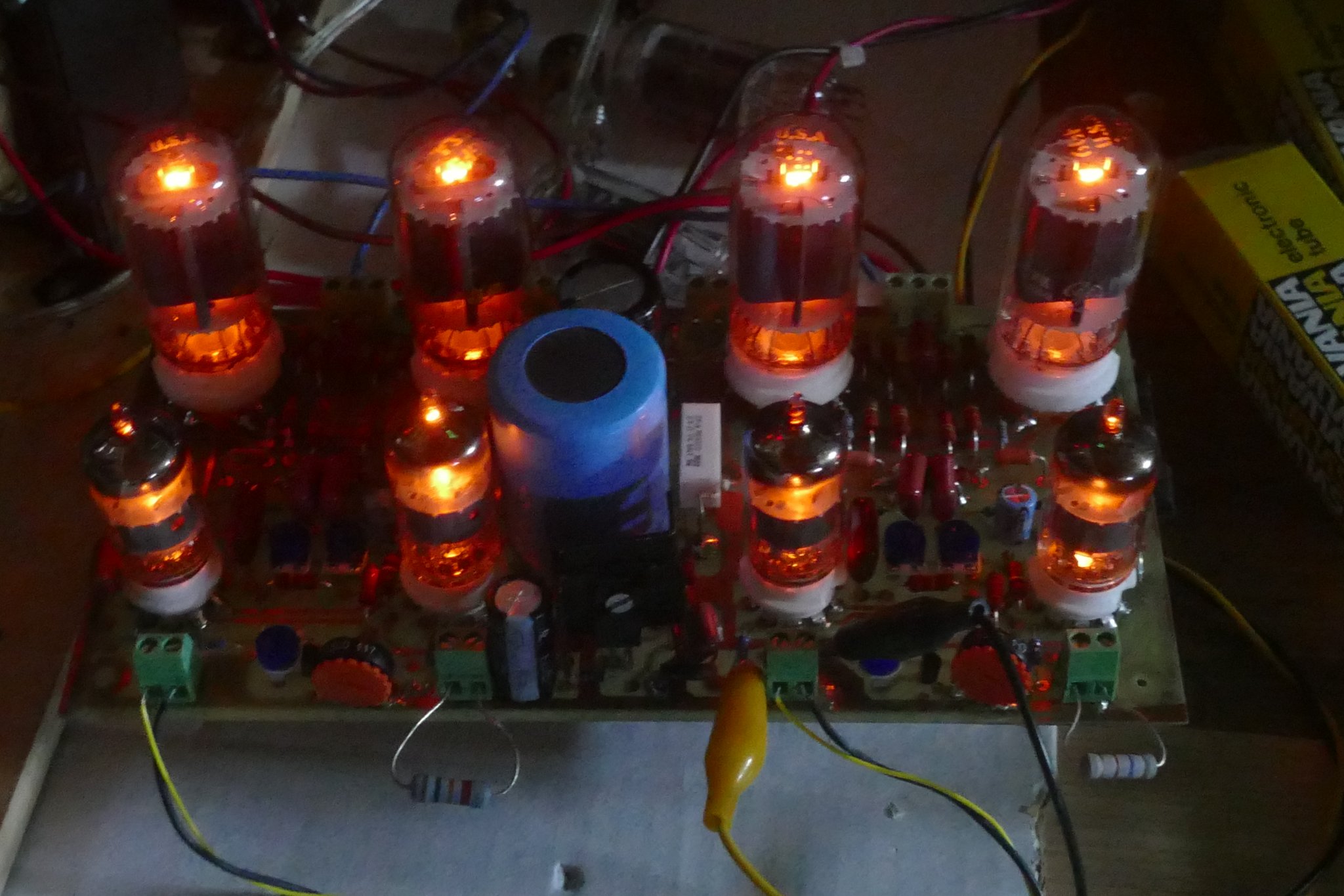

The 6GF5 is a shrunken 6GE5 with its plate "wings" clipped. Both were made with 6DQ6B guts. I stumbled upon the 6GF5 while digging through some tubes at the ESRC warehouse when I still lived in Florida. They were on the $1 list, and Stan said that even at that price, they did not sell. Many tube sellers have never heard of them, so they must not be common. Stan had about 600 of them, and someone grabbed 300+ in 2017. I bought a big box full for less than $1 each about 15 years ago. This led to an amp that made 80 WPC and some other interesting experiments. There is a little but LOUD guitar amp experiment going on that might use some of them.
The heater tab seems to be present on all of them but is never documented and labelled i.c. in the ds.
I learned the hard way that some of the big horizontal sweep tubes have an undocumented heater tap labeled I.C. on pin 7. Stuffing a set of 35LR6 tubes into Pete's Engineer's Amp put plate voltage on to my heater circuit making the bypass caps explode. Not all 35LR6's have the tap, but the Sylvanias that I have do!

Those "9 watt" 6GF5's will eat between 15 and 25 watts before showing color depending on how well they were made. I picked 4 good ones for the 80 watt amp experiments.
