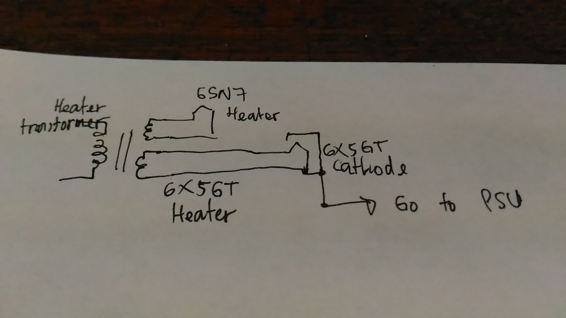

Is my draw wiring correct? I use separate transformer for heater, it has dual secondaries, one for the 6SN7GTA preamp, else the rectifier. Each secondaries winding rated for 2 amperes, its large enough right? ( i will use them to supply single stage 6SN7GTA with 300VDC HV). What is the function of UF4007 in series with each plate of 6X5GT?

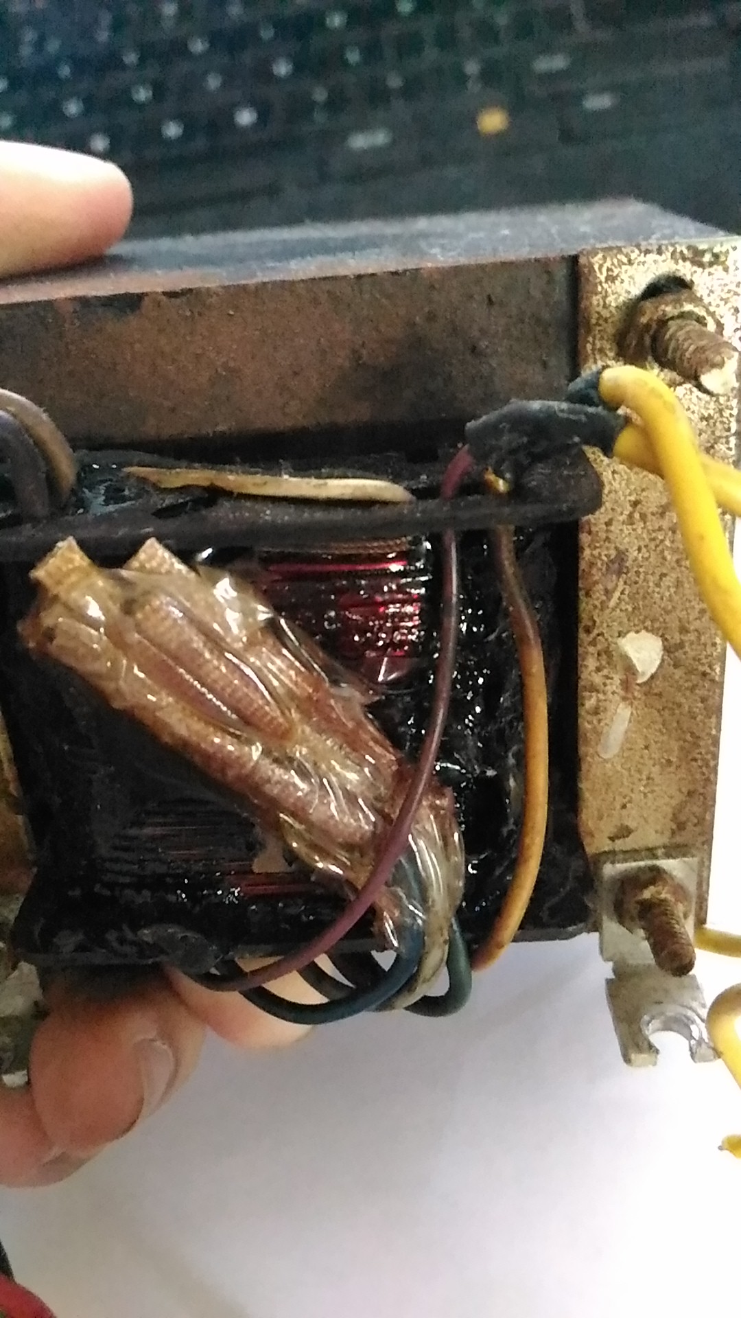

Just like what happened before on my preamp, i do test my new RCA 6X5GT, for about 8 seconds from i turn it on, i saw a some archs in the filament of the rectifier, so i turn it off. check the pin of the rectifier everthing is still ok, but physically notice the rectifier filament have some shiny parts as like it was scratched. Then i decided to use my daily used rectifier, there is humm coming out, try to replugging the rectifier and 6SN7GTA, there is no change. Then i smell burn out thing, turn off the amplifier and preamp, unplug the main cable, i touch the wood case of the transformer its warmer than usually. Decided to open the preamp, and find out the high voltage secondaries being short, 0 resistance in the winding, and find the out layer of the transformer melted. The main fuse is still ok. But i do find the C input of my preamp is to much bigger than the maximum, 180uf...

Use a dedicated filament winding and tie the cathode of the 6X5 directly to it, no potential difference, no cathode insulation break down issue. (Make sure the filament winding you use is rated for more than the highest voltage possible at the cathode of the 6X5 under high line, and before the other tubes start to draw appreciable load current)

Hi sutantoroy,
What you are seeing is a classic failure due to excessive capacitance. Use a little lower capacitance than the maximum for starters. Then, pay attention to the minimum plate resistance specification as well. If you have to add resistors, that's fine. Manufacturers have done that in their designs for ages.
The lower capacitance will allow a higher amount of ripple on the DC line, but that beats the higher frequency pulses that the high capacitance will generate. The lower frequency ripple is a lot easier to get rid of with a regulator than the high frequency hash created when capacitance is too high.

Thank you Chris. So, what do you think about separate secondaries winding for rectifier heater and tying the heater pin to cathode, is it necessary doing that? What is the side effect by doing that (tying the heater pin with the cahode)

Hi Roy,
That all depends on the rectifier you are using. Normal heater-cathode breakdown is on the order of 100 ~ 200 VDC (either polarity, peak). Some rectifier tubes were designed with very large heater to cathode voltage tolerance, so they could be run off the same heater line as all the other tubes (in this case, 6X5 has a breakdown of 450 VDC). That means that you can run this tube from a ground referenced heater line with all the other tubes as long as that potential difference remains below 450 V peak.
Tubes that use a filament like a 5U4 must run a separate filament winding that is at the same potential as your B+ supply. This one needs 5 V at 3 amperes. That is why you will see tube power transformers that commonly have a 5 VAC winding good for 2~3 amperes.
So, your power supply does not require you to run your rectifier tube off a separate winding. You can even float your entire heater supply up to 30 ~ 50 VDC to reduce hum if you want with zero ill effects for the 6X5.

Thank you again Chris. To make sure that i do get know what you are telling, so i can connect the heater pin to ground reference or just leaving it not connected to the ground reference (leaving the transformer secondaries heater winding just connected to the tube heater pin, no conection to the ground reference). Both is ok, is it right?
For the kind like 5U4 (is it called direct current rectifier?), the reason it needs separate winding is it because the current requirement for the rectifier heater is relatively very high to other tubes or other electrodes current capacity, so it can be a very high inrush current damaging other electrodes. By doing separate qualified winding will likely as current manufacturer which is supplying the rectifier heater high current demand, is it right?

Hi Roy,
You can ground the centre tap of the heater winding. Here it is a question of background hum, so try floating it, grounding it and floating it to a specific voltage below say - 50 VDC. Make sure you have at least a 10 uF capacitor to ground if you tie the heaters to some voltage above ground.
A filament tube like the 5U4 has it's filament at full raw B+ potential. This is by design and you can't escape that connection. Have a look at a schematic to see what I am saying. Since this must be so, the filament does require its own dedicated winding. Just remember that in these tubes, the "heater" is combined with the cathode to make it a filament.
