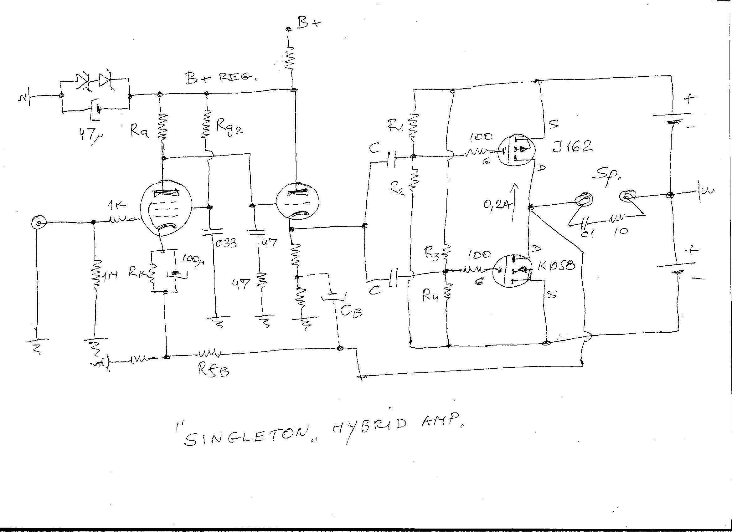

BTW , I`m consider this relative simple inverting OPS too , driven from CF part of tube stage , it consist from pair of LatFet`s in common drain configuration driven from two modulated PP - CCS , those two CCS are OPS bias generator in the same time .

This looks like it can offer much better PSRR than your first design, but those 3R3 rail resistors want to be larger so that in combination with the 220uF rail caps you get a low enough corner frequency to keep power rail noise (and signal return currents) away from the bipolar devices.
You have the tube stage feeding the centre of two resistors - not sure why you want to do that. Why not have two coupling capacitors directly to the bases of the transistors, similar to your original design ?
Not familiar with these exact FETs - probably want to allow space for external gate protection zener diodes.
Do you need the dc-offset adjust pot / 100R resistors in the emitters of the drivers - unless you plan is to degenerate the gain of these devices you might have the emitters sit at the power rails and adjust dc-offset in the supply to the transistor bases ?

Yes this type of OPS have much better PSRR than my previous proposed OPS and allow use of conventional PSU ,
basically those two 3R3 an two 220uF can be omitted from schematic without to significantly compromise OPS PSSR factor ,
we can use two coupling cap , each one attached on top and bottom driver Tr. bases , but I think that this proposed `one coupling cap ` solution is also good , since with triming mutual values between of those two res .we can set output AC balance to get desired distributed output THD spectrum .
those Hitachi / Renesas LatFet`s already have build in protection zener diodes and also protection flyback diode between drain and source , so no need for external extra protection .
I will leave those two 100R degenerative res .on place .
It is interesting that this OPS can be driven from just one high gain triode , where Russian 6C45PI is very good choice , but from Futterman high gain tube input stage too .
