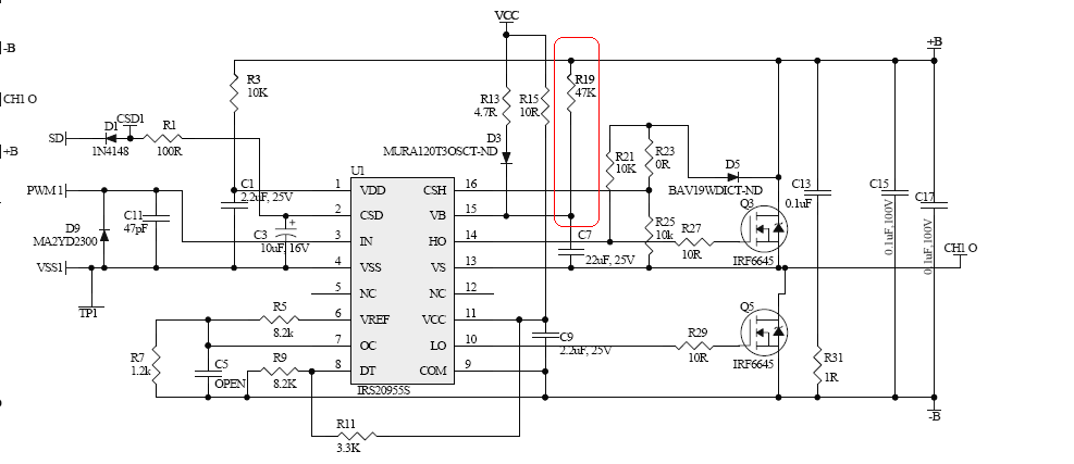

I have built a Class-D Amp based on the IRF Reference Design IRAUDAMP4(A). Worked pretty fine for a time but now i'm getting Problems with it.
The PWM modulator is similar to the refernce design (self oscillating, TLC081 as integrator, IRS20957 Gate Driver, and IRF6645 Mosfets).

No startup without input signal - it is the common problem in self oscillating class D amps with bootstrap supply for high side gate driver. Try to connect the amp output (before inductor) to positive power supply rail via 50K-100K resistor. This usually solves the problem with bootstrap supply at startup. This resistor creates some small initial offset voltage at output after power on and forces the oscillator to start with negative pulse, effectively charging the bootstrap capacitor of the high side gate driver. During normal work (after oscillation starts), this resistor does not affects the amp output because of the low amp output impedance.

The reference design has the pullup resistors directly on the bootstrap capacitors (between Vb pin and +V rail), which are intended to solve this problem. But somewhy it did not worked this time. Maybe this bootstrap pullup resistor is broken in this your sample? 😕
well i got this resistor also in my design. I built three of these amp pcbs all with the same issue. So i don't think the resistor is broken but i'm going to check tomorrow. Only got one for testing at the moment here but this one seems to work fine with a 68k pullup on vout.

Did you implemented the "startup sequencing" in your design also? The key point here, I think, is that the CSD pin should stay low for some seconds after power on, allowing the bootstrap capacitor to charge via pullup resistor. To test this possibility, you could try to short CSD pin to GND (VSS pin) and release it manually in some seconds after power on.

That resistor is in on the IRS2092 datasheet circuit.
I believe it is one of the conditions before the 2092 will start running.
