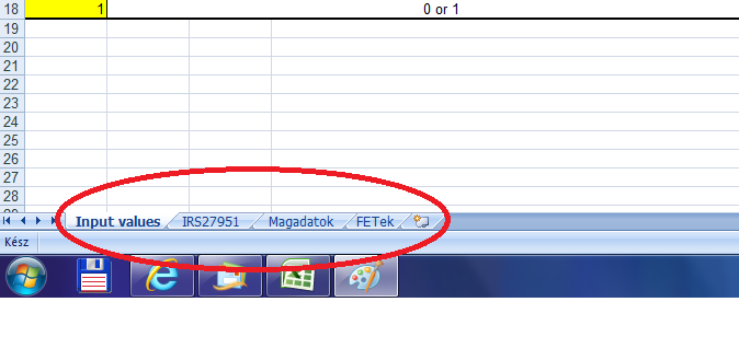

I have looked at the spreadsheet but all it does is input values.

In the spreadsheet there are multiple sheets. See the attached picture for help.

(The spreadsheet uses function to calculate values. Cells with input are marked yellow. Don't write into cells with function)
